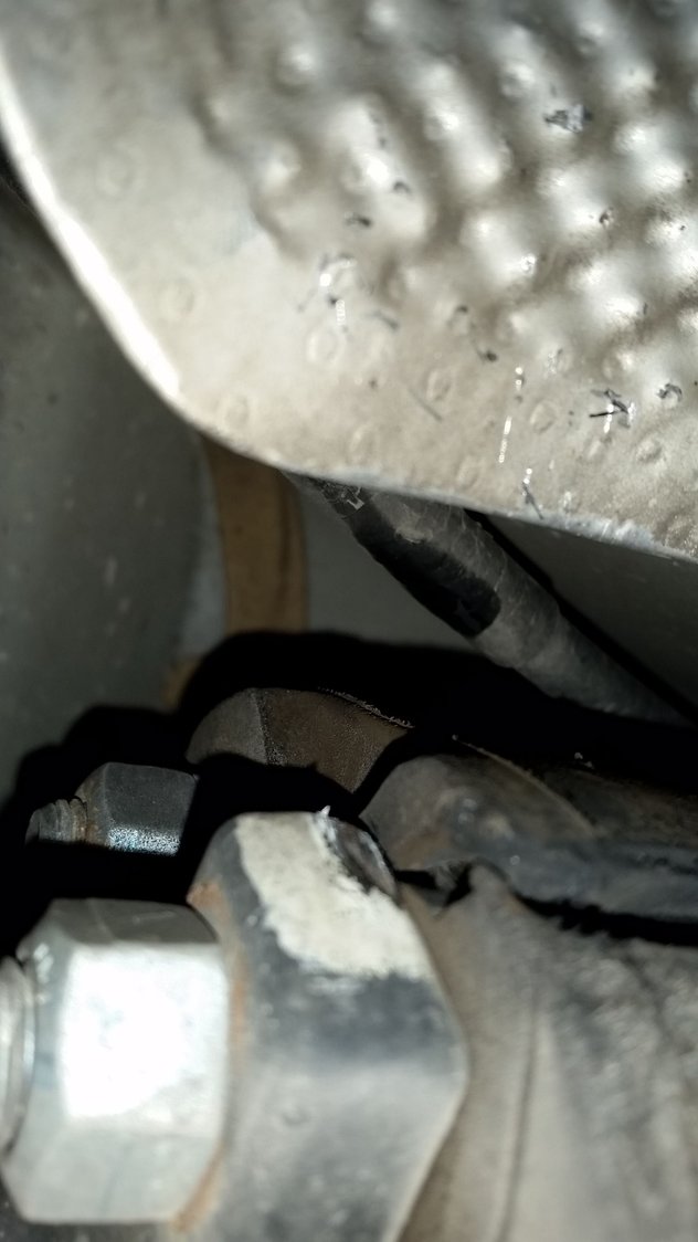

OK, I think I found the issue and have made a temporary 'fix'.
The rubber coating on the driveshaft coupler got nicked somehow.
You can see where it has been 'polishing' the heat shield edge and the parking brake cable sheath.
For now, I cut the offending flap off. I'll test drive it tomorrow. Long term I'll replace the coupler.

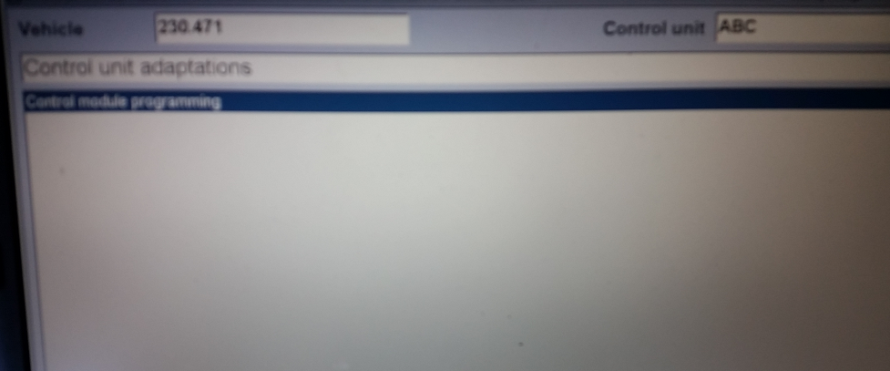

the only thing to be found in Control units > Chassis > ABC > Control unit adaptations >
is "Control Module Programming", which "requires online connection to the central systems". [edit] Ah, I just looked at bterry99's thread "Using Star Diagnosis to adjust suspension height" and see that inability to adjust height calibration on 07's without a connection to the mothership is a known issue. Glad I'm OK with the stock height.
