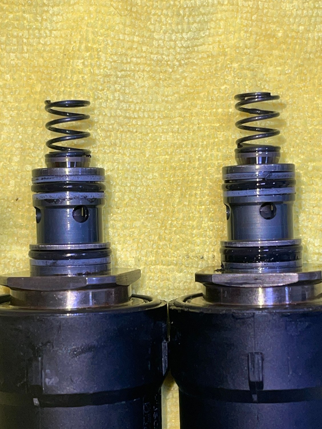

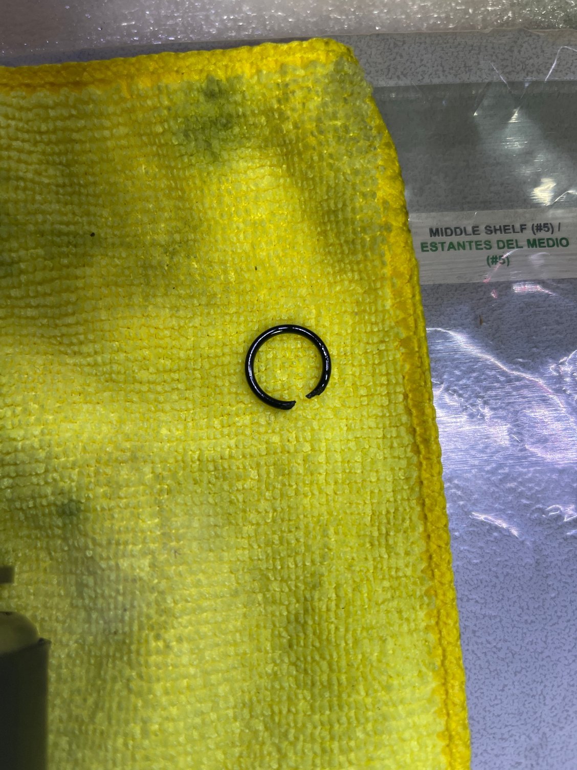

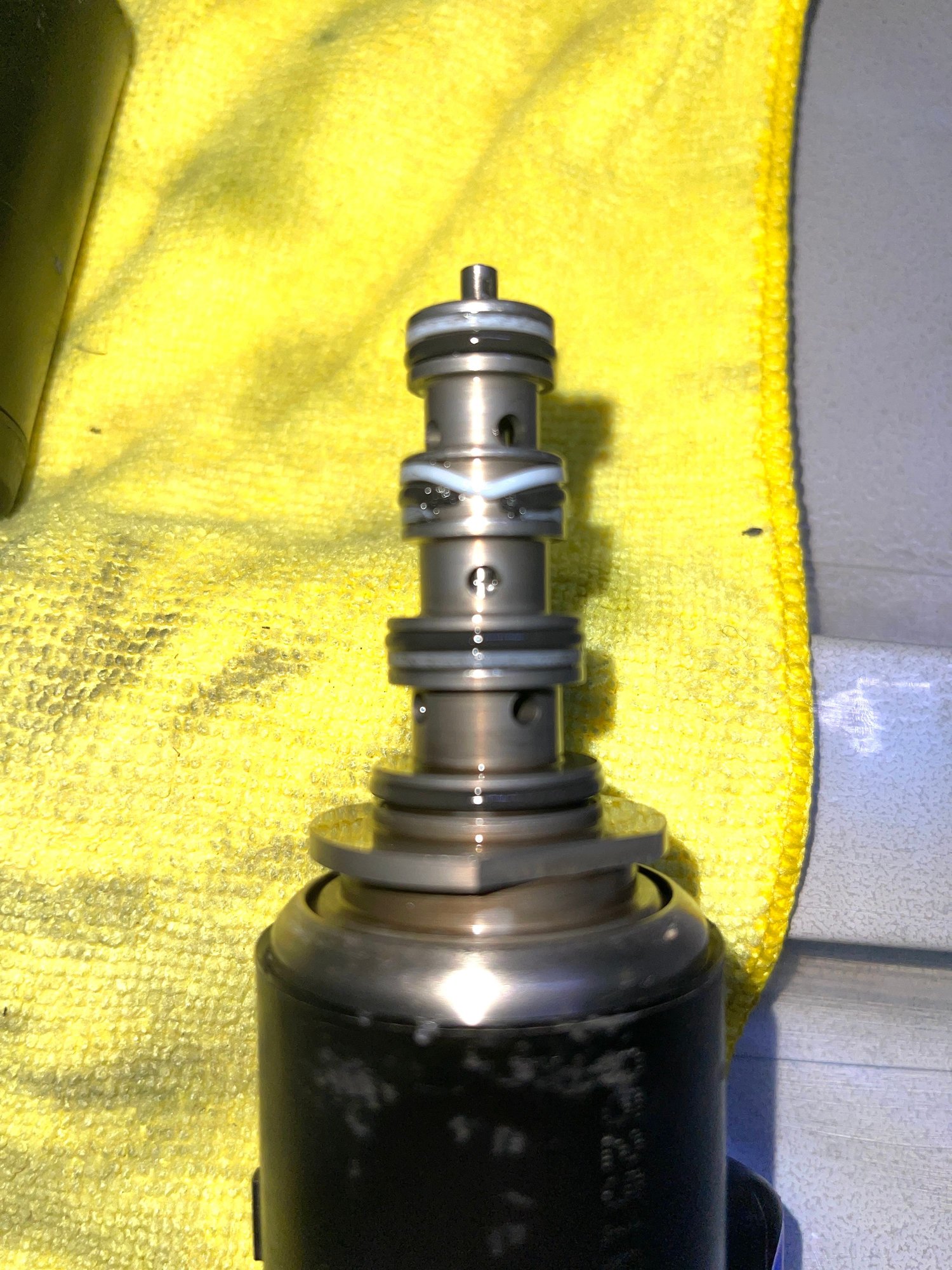

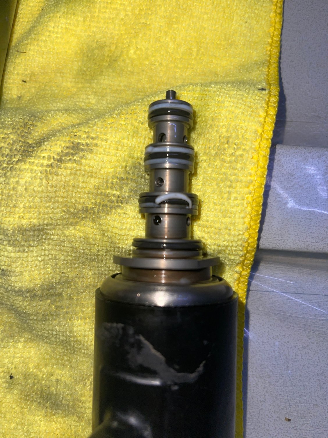

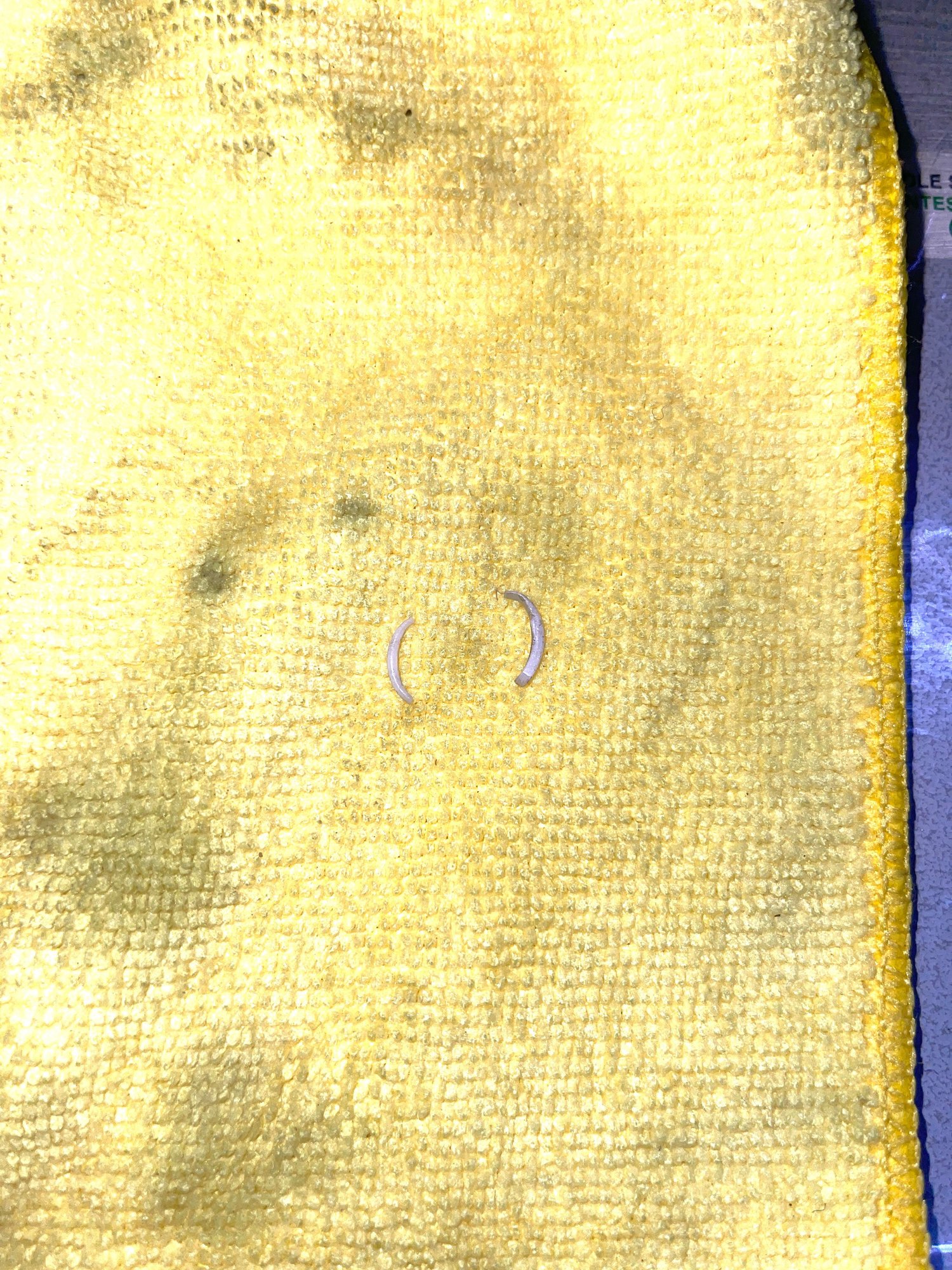

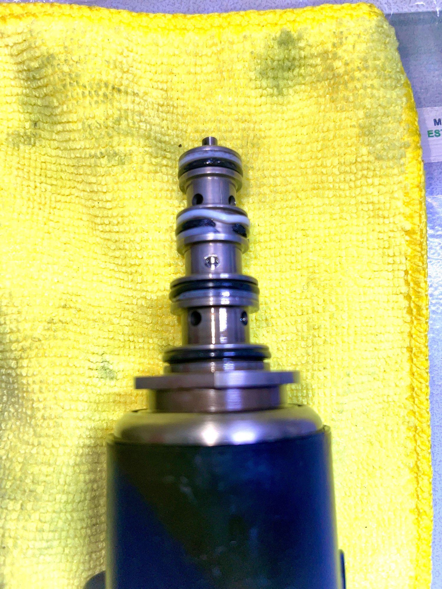

I pulled the front block out today and found some interesting issues! One locking valve had a piece of PTFE ring stuck in a hole! The other one seemed to be stuck in the open position? Non of the rings on both locking valves were compromised. You may notice one doesn't have a white ring because I destroyed it 2 years ago when I was trying to seat the valve back in the block during the rebuild. (I had to re-used an old rubber ring). So it seems all the broken up PTFE pieces came both control valves! I didn't know they can migrate into the locking valves.
The one broken rubber ring seems to have split and I don't think there is a broken piece that is now floating around somewhere. I haven't clean out the block to see if there are any pieces stuck in there. I was initially happy thinking this was the cause of my problem. However applying 12 volts to BOTH locking valves did not activate them. Both control valves work fine. Assuming both locking valves were bad before I pulled them to test, would have there been more serious issues besides the left shock raising all the way up? Again, I was able to do full calibrations sessions and two rodeos when troubleshooting before I pulled the block today.
Ordered a used tested valve block and should have it by the weekend.

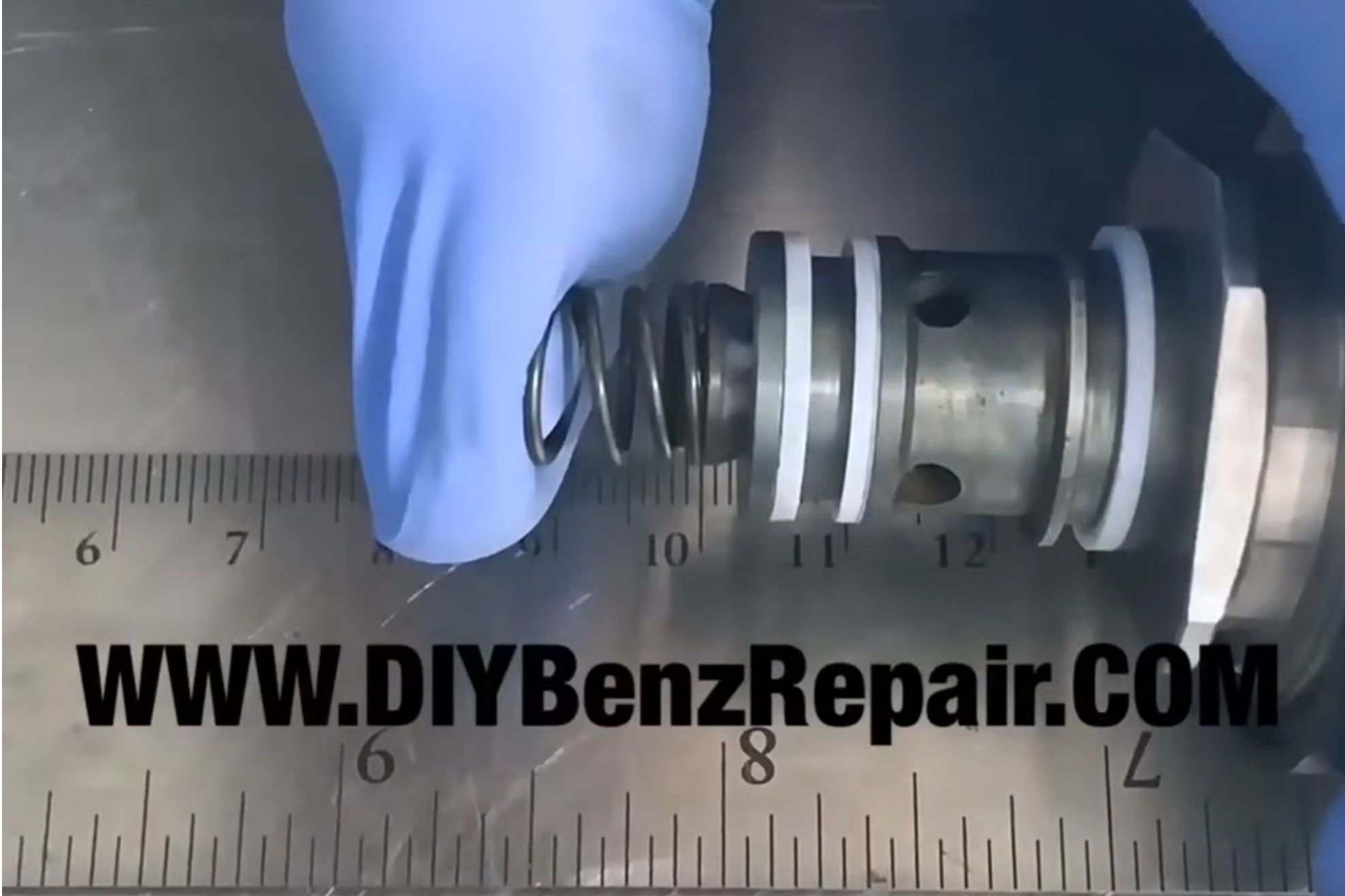

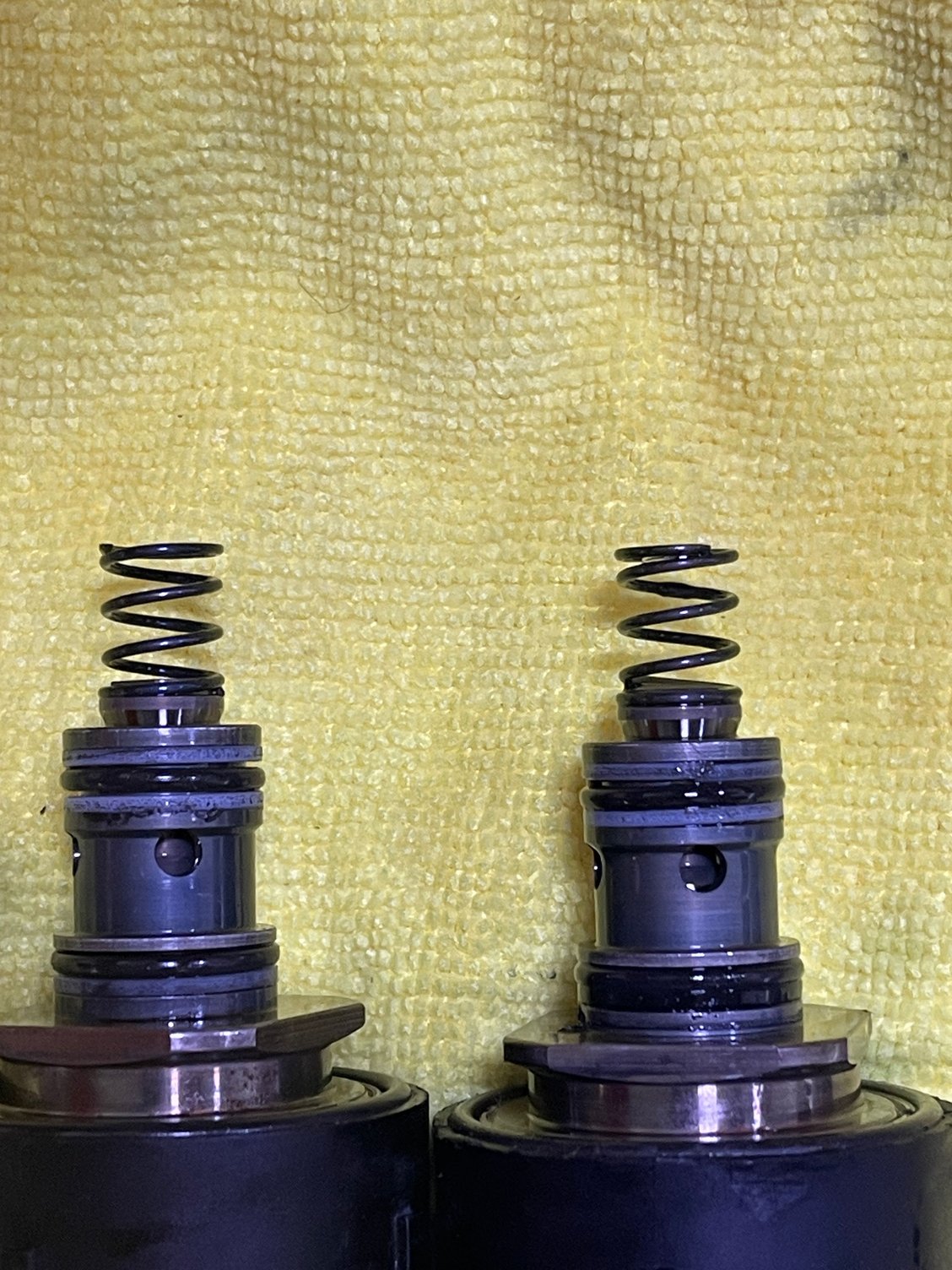

Stop the presses! I figured out why both my locking valves were not actuating during my testing. I was not applying pressure to the spring when I fed 12v to them - just like in the video. I know the author of the video implied this but, my mind didn't catch it last night.
So if anyone is trying to test their locking valves - make sure you apply pressure on the spring just like in the video. The control valves don't need you to apply any pressure on them to activate w/ 12v being introduced.
Video:
I'm going to replace all the o-rings and after a thorough cleaning and button everything back up. Wish me luck.

I was able to activate the locking solenoids on my 4th try by putting pressure with my finger on the spring! The valve needs physical resistance to actuate with 12 v introduced in case you missed that in my post.

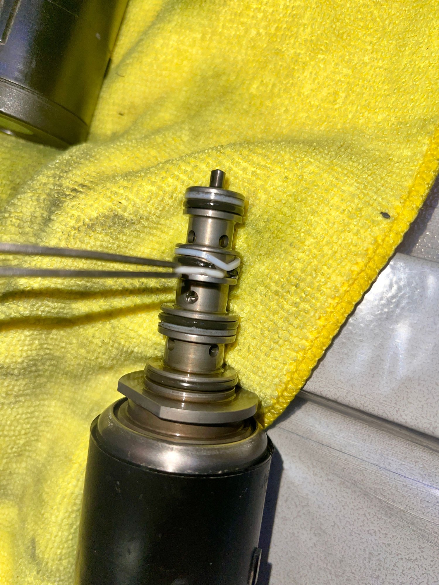

I too was hesitant to buy a remanufactured block because I know all they do is test them and replace o-ring. I don't think the valves are rebuildable from my research. The rebuild kits with the split PTFE rings are annoying and stressful to install. They tend to bind when you slide the valve in and get pinched. There is no way to verify they didn't get pinched unless you pop the valve out again. I pulled one back out to check and sure enough one broke and another was deformed. I had to use non-damaged old ones to finish. I lubed the crap out of the block, valve and rings and tried it again carefully. Apparently the locking valves can be rotated 360 degrees to verify they are seated correctly with no pinched rings. I was able to test that. However, the larger control valves won't rotate 360 and you just have to pray no rings got pinched.
