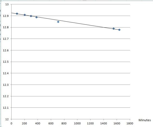

After the initial drop when I disconnect the charger, the voltage drops from 12.92 to 12.78V over a 24 hour period.
It looks like my voltage drop theory might be busted though.
