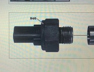

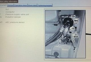

Anyone know a source to get this pressure sensor? I got the ABC visit workshop and when I run diagnostics it points to the pressure sensor B4/5 being bad.
cannot seem to find a source online.

Star Diagnosis says to check the voltage supply to the sensor and its output signal voltage. Since a new sensor can only be had by spending c. $1000 on a complete pressure supply valve block, I would do those voltage checks.
I have to vent. This is one thing that sucks about Mercedes...You have to buy the whole assembly to get the broken part you need!
Need an upholstery clip? Have to buy the whole panel to get the clip!
Best bet, if the sensor is faulty, is to get a used part. I have a good sized bin with used parts for expected future repairs. If they don't fail, they eventually go back to eBay!
