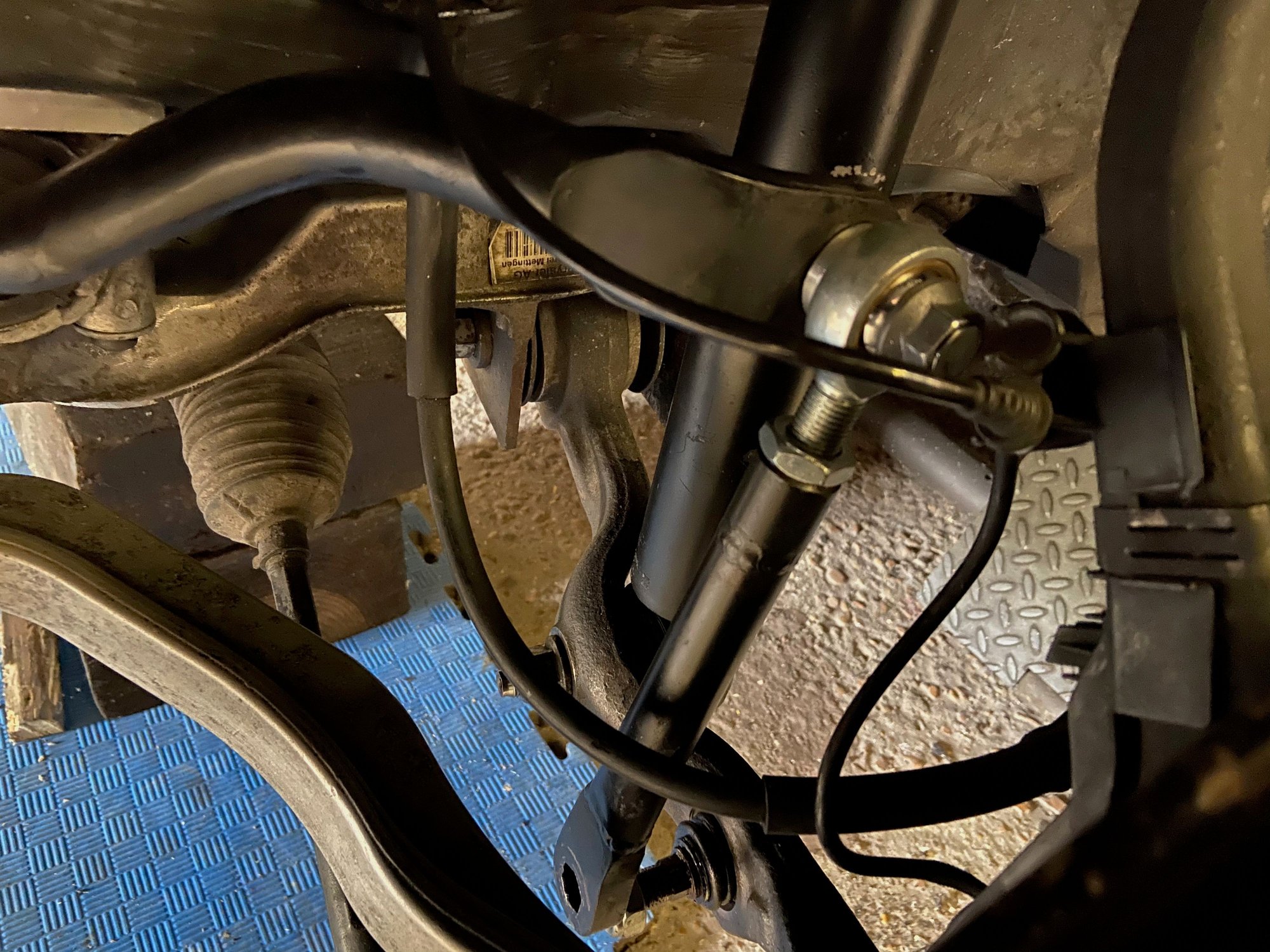

Old Feb 20, 2021 | 02:10 PM

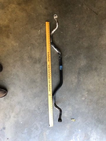

Tony, I am about to install my sway bars and looking for all the info I can.>! Your pictures are great, but if you would have taken one looking straight into the bar mount at the chassis it would have been great.! I wonder if you do not get noise from those universal joints?? I have a bar that found at my local boneyard, and trying to figure if it fits..! The eye spacing is right, but wonder if the inverted bend at the arms will be an issue!

is this any use to you?

I believe the sl55 and sl500 have different oil pans, so it may be a different design?

Keith, appreciate you sharing that pic.. The issue that have me hesitant is that the bar I got has everything right, excepting the bend in the arm shown over your pic. The distance from mounting axis to eye is 6-3/8".! I wonder how much is that distance in your bar?? Everything else in this hefty bar seems to fit.
Old Feb 1, 2022 | 06:09 PM

[QUOTE=elMacko;8504191]Keith, appreciate you sharing that pic.. The issue that have me hesitant is that the bar I got has everything right, excepting the bend in the arm shown over your pic. The distance from mounting axis to eye is 6-3/8".! I wonder how much is that distance in your bar?? Everything else in this hefty bar seems to fit.
I doubt I can get to measure it. My car is covered up over winter. If its fine at the weekend I'll see what I can do.
