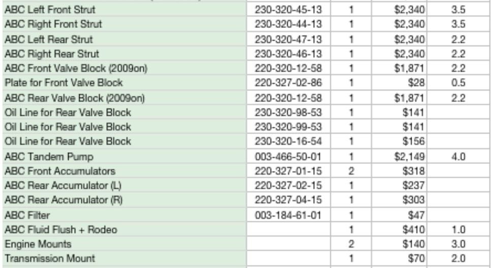

Over six years ago I dealer priced ABC with associated parts for reference and here is the Canadian price list at that time, plus labour time (all costs will now be significantly higher). NOTE : labour time to install is far right column.............
None of the above items are currently present on my SL55 AMG and I still have a totally MB OEM vehicle, that drives even smoother and better than with ABC.
