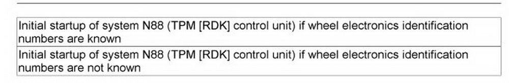

James is right
Tire pressure might come back on it's own, you need to drive a bit
if not you need to reactivate with Xentry

If needed in Xentry, if unknown Identification numbers
use these fonctions
