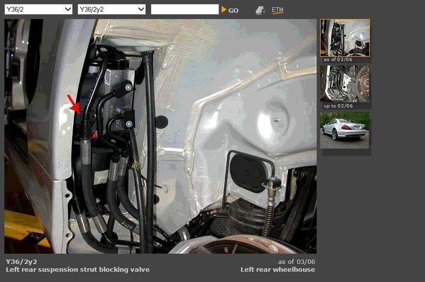

your old vintage system shows that as "strut blocking valve"
it is a plunger check valve
check if connector is ok over there
Not sure if I understand u, but I was talking about y36/2y1 where it shows 9.8mA. It is control valve, the longer solenoid. Old or new software, it means the same solenoid, not y36/2y2.
