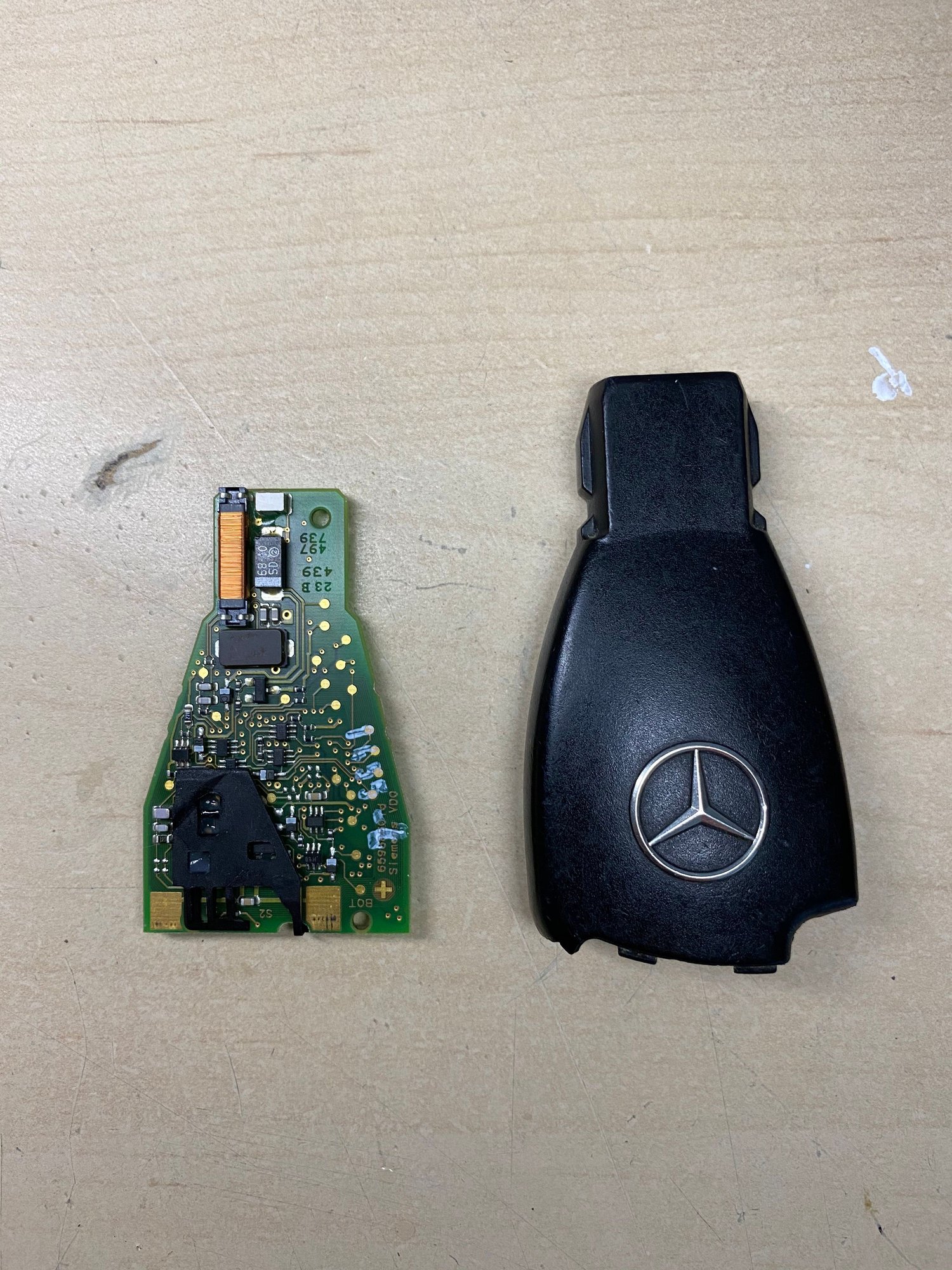

I took apart the old key that came with the car, not the duplicate one since if this old key that the dealer was using cant use keyless-go, I doubt the new duplicate key would be able to use it.
Back of the old key
Front of the old key

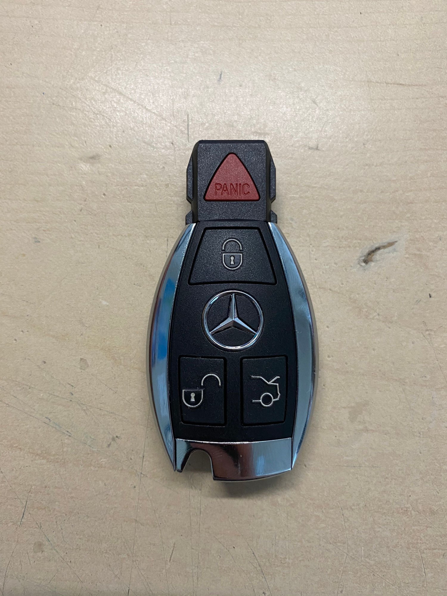

I'm also going to attach the front and back of the new duplicated key if it helps to let you guys know how the second key looks like.
Back of duplicated key
Front of duplicated key

I had a similar issue when getting an official spare key from a main dealer, it worked everything except Keyless Go. Forgive me if I get the terminology wrong but from what I recall the Car has a number of tracks for the keys but a number of keys can be programmed to each track. However for Keyless Go, the keys must be programmed to different tracks. Ie if two Keyless Go keys were put on the same track they would both open and start the car but none of the Keyless functions would work.
If the keys come from Mercedes using their factory records they automatically are set to track one. Same as original.
When my dealer worked out what was happening they just reallocated the new key to a different track and it all started working properly.

Your 1st key shown copper coil, its keyless go key.

It's my guess that the older key is original to the car and that this is not a key programming issue. Before you do anything, consider reading up on Keyless Go. A handful of documents in the WIS discuss it in depth, and that includes a procedure for programming keys.

As another member mentioned, the black key is an original KG key. They are not able to be be purchased. It likely has a battery, coding, or “car side sensor (one of the sensors that sees the key)” problem.
The silver and black key may or may not be keyless go but only could be if the key was programmed at the dealer.
