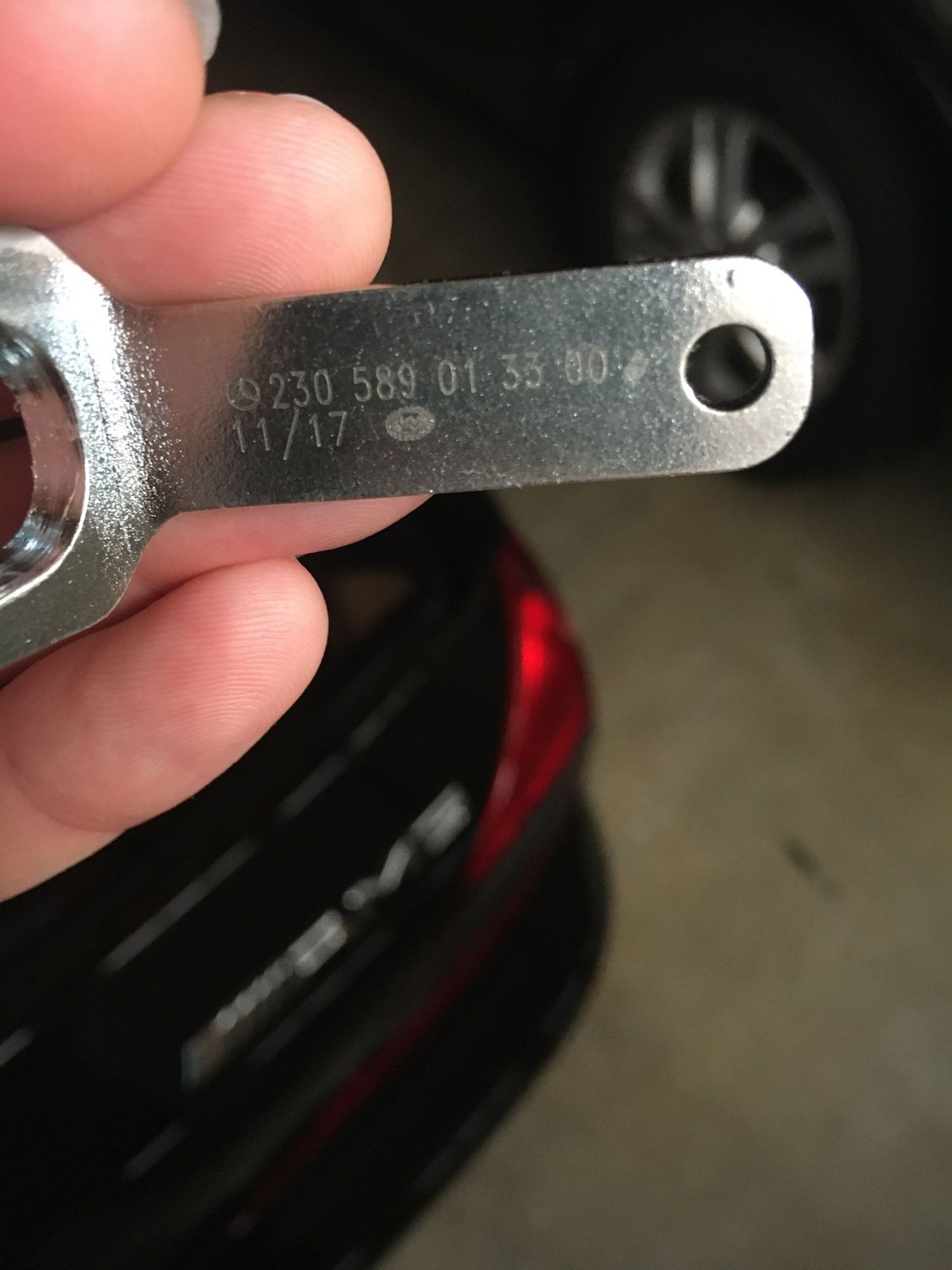

The best way to remove the rear valve block is to first relieve pressure from the rear struts by opening the 11mm bleed valves at each rear wheel and then use this tool, sold by Mercedes to detach the quick disconnect hoses.

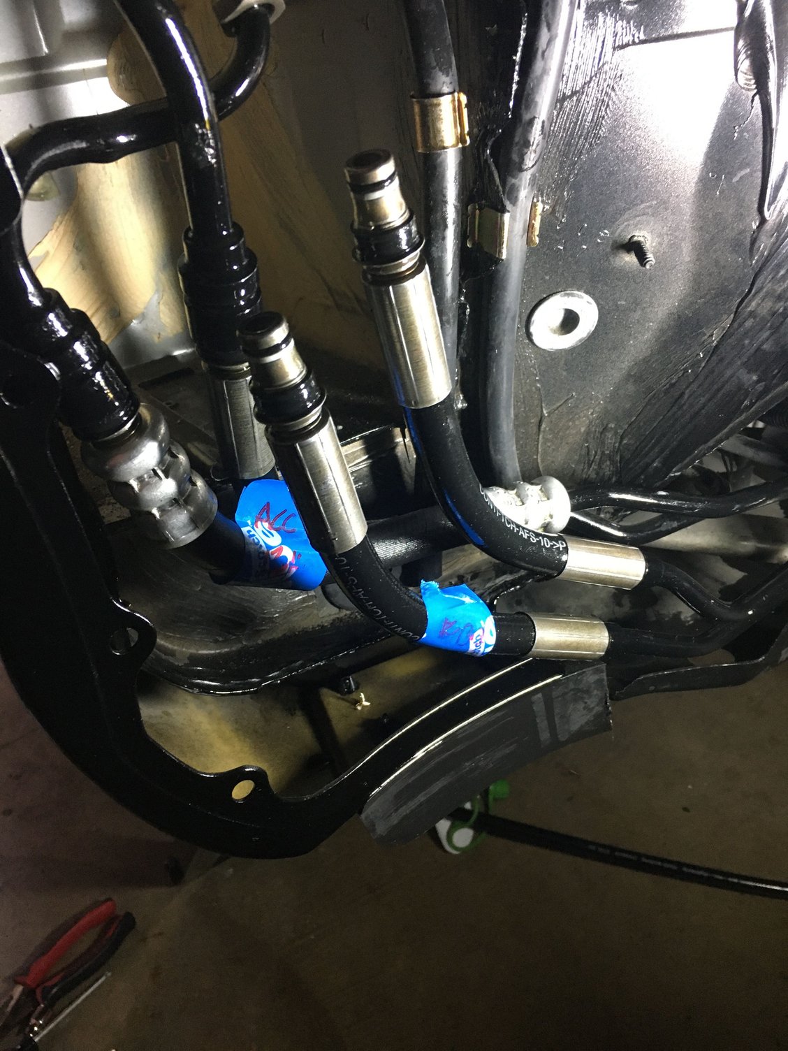

In the rear there are metal tubes that connect to the valve block using the same threaded fittings as the front valve block.
Rubber hoses connect to the metal tubes with the quick disconnect connectors shown in my photo.
Taking apart the quick disconnect connectors is much much easier than unscrewing the metal tube fittings due to clearance issues in the rear.
