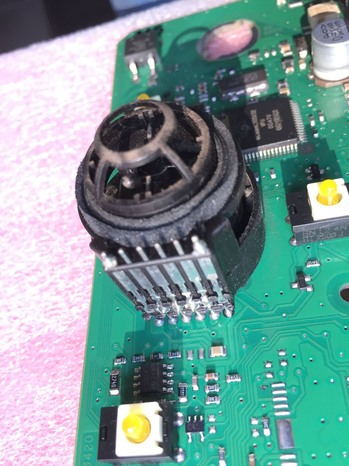

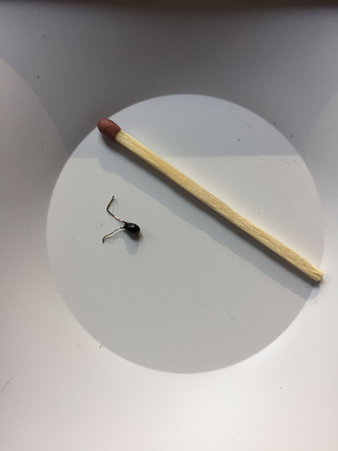

But you can repair the fan. I did. It’s all very small (and dusty) but quite simple, squirrel cage type of fan. Perhaps it’s just scraping dust. To be more precise: had to re-solder the temp sensor, which sits inside the fan cage.
Seeing the fragility of it all, I recommend not to hold a vacuum cleaner against the grilles and cause a tornado in there. You’ll surely break or at least dislocate the thermistor.

Squirrel cage fan, perhaps 15mm in diameter.
Thermistor (temp sensor) which lurks inside fan cage. That match is standard, not king size.

The photo's I posted above in #7 are from the overhead panel. There's a similar setup in the AC control unit. The two buddies supply interior temperature info to the climate control system.
