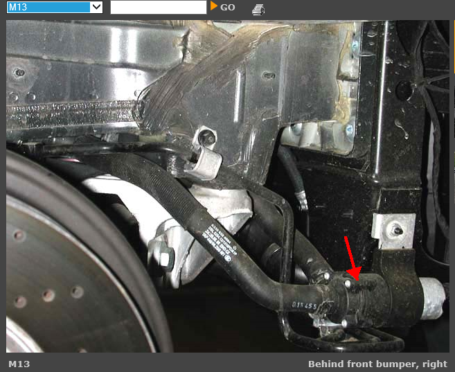

The first thing I would do is measure resistance from the load side of fuse #23 to chassis ground with the fuse removed. If there is no wire shorting out you ought to have a fairly high measurement. If that checks out, then I would unplug the coolant circulation pump, since it is also powered by fuse #23.

yes, resistance was checked it seems to be a short. coolant circulation pump was unplugged and still. Is my only option chasing at this point.
