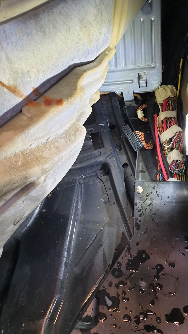

Absolutely right. Look into the air inlet of the vent system. If there is visible water, the drain is blocked, and you have water in the passenger side, underneath the carpet. There is a Canbus C connector underneath the carpet, right side, and if that gets water, it either short circuit or create connection to ground.
The car then behaves exactly as you describe.

Definitely look at where SLcharge said to look, looking in there is a must, if the drain by the hood vent is plugged with pine needles or tree debris you must address that!!

I'm having similar problems with my 2012 SL63 AMG which has been sitting for 5-8 months thanks to this covid *****. Yesterday being a beautiful day I decided to start it up and check things out. As soon as I put the key into the switch the washer started pumping spraying fluid all over. The engine started OK but the washer kept pumping until it was empty and still kept pumping. Some troubleshooting showed the battery in the trunk was dead. I replaced it today and am still having all kind of problems, mainly the washer pump running along with lights being on, windows not working properly etc. Any ideas? I pulled the fuse in the engine compartment (f14 7.5 amp) and it kept running. I must note that inside the fuse box was wet which I dried the best I could and blew it out with air. Is there anything else on that side of the car that could be what I'm hearing, under the battery?
