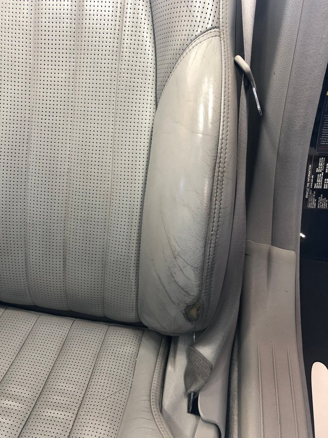

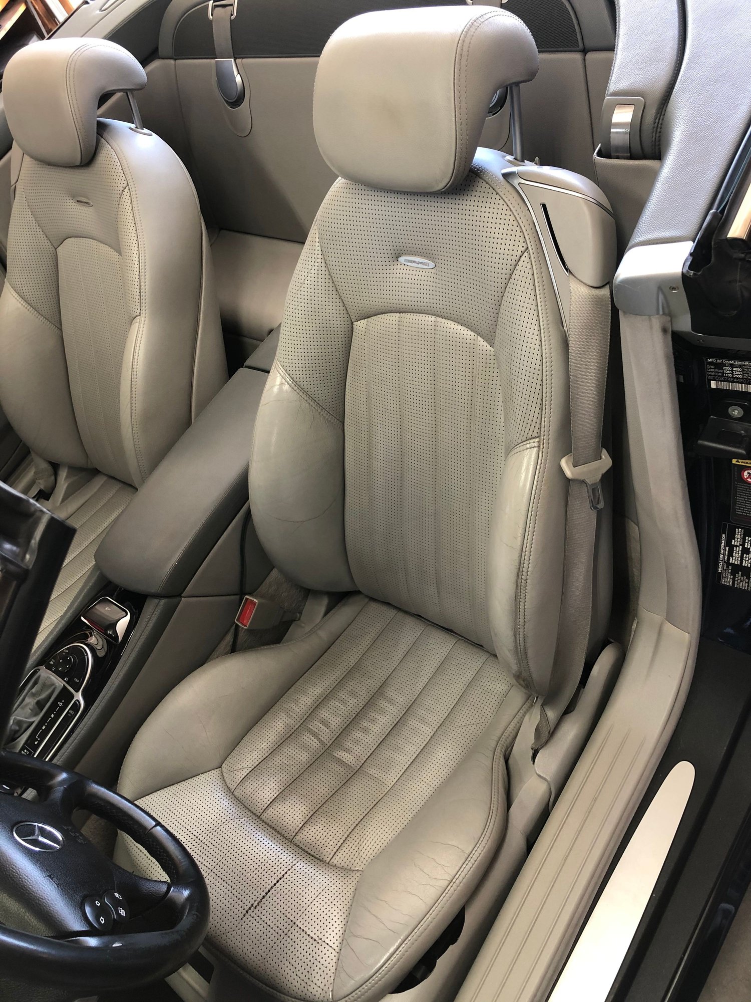

Everything was just worn and tired. Finally got a rip in the bottom, prompting me to just pull the trigger on some new ones.
This was a local "leather repair" guy - he warned that the color would rub out quickly, but at least the hole was fixed. Again - just really couldn't deal with it anymore.

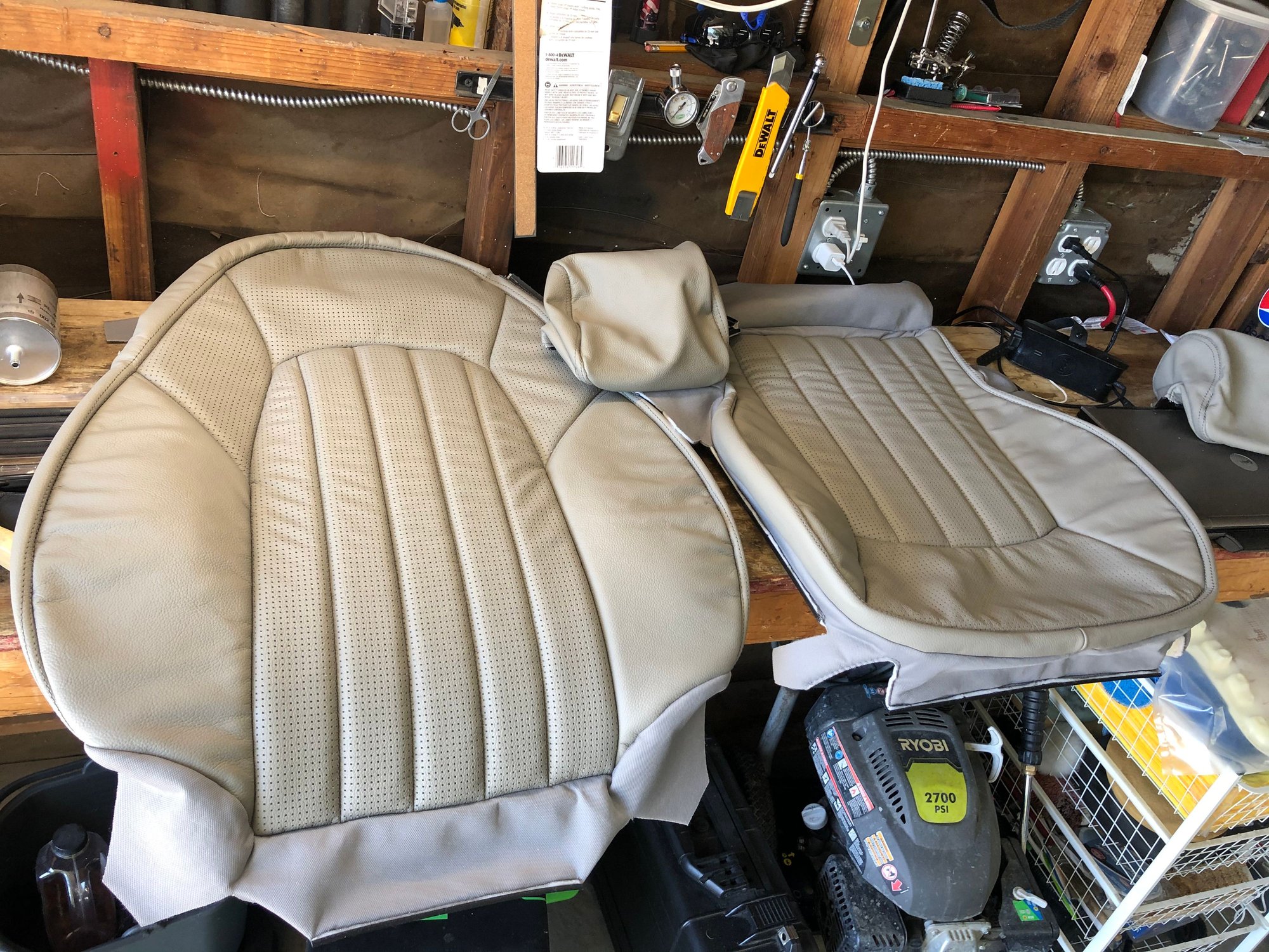

This is how the new set comes.

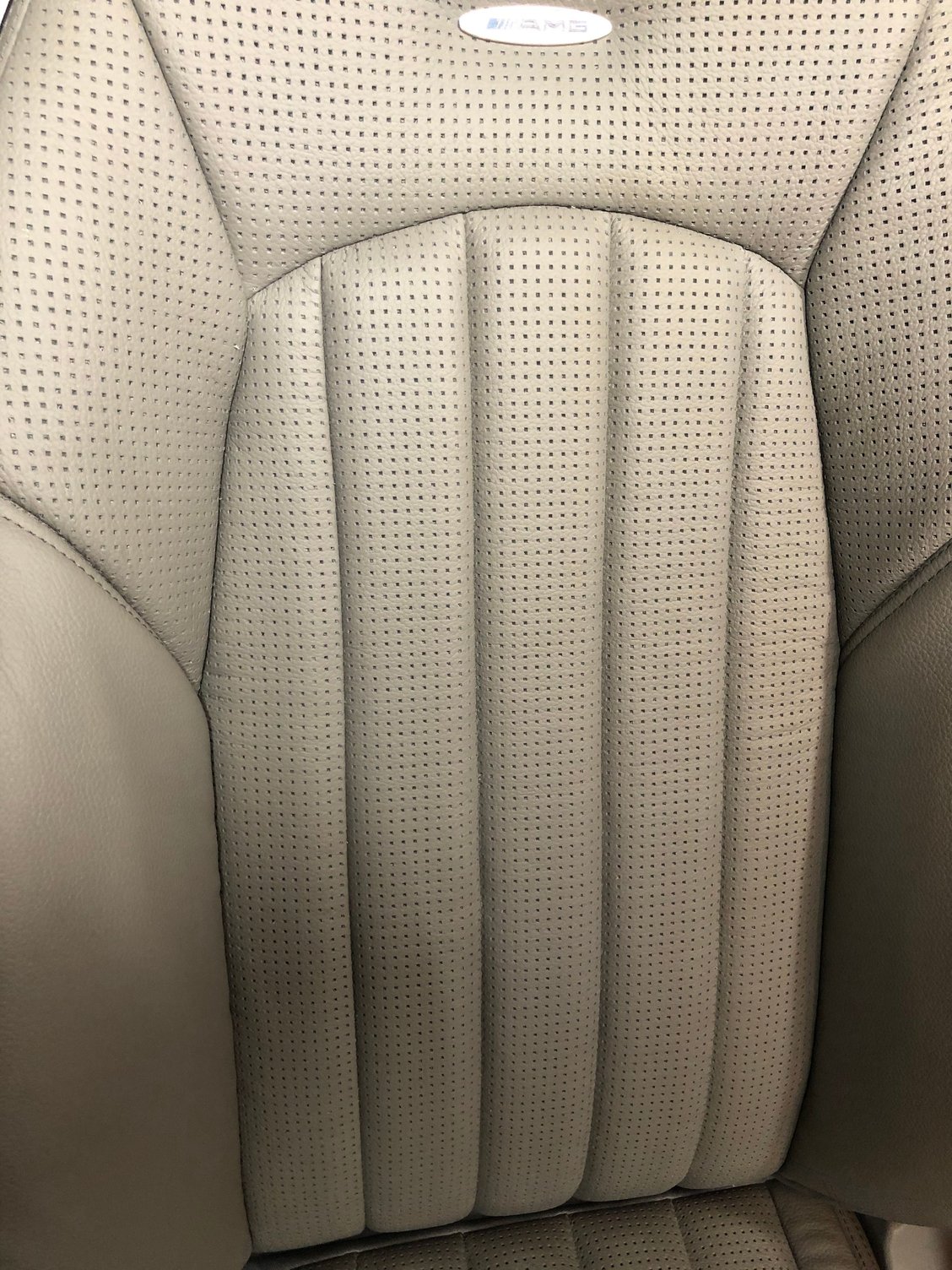

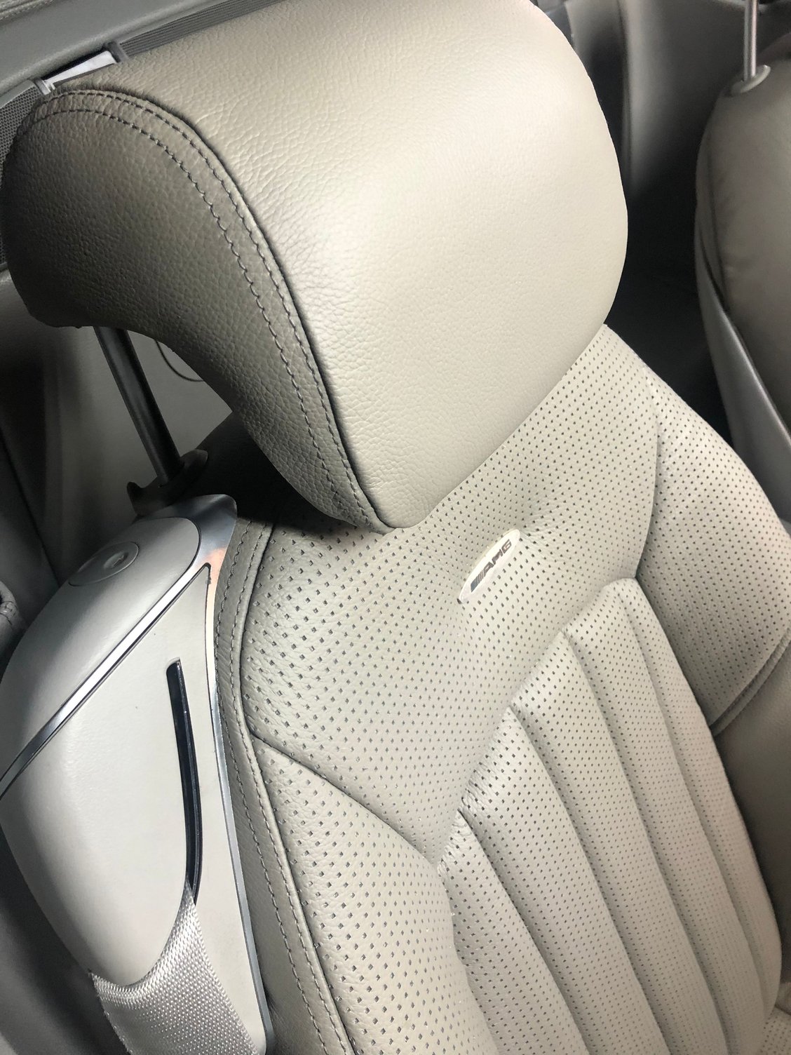

Close up, just to get an idea of fit/finish
Another close up - everything was original, even when I lined up the AMG tag, the perforations were placed exactly the same distance from the seams as the originals.

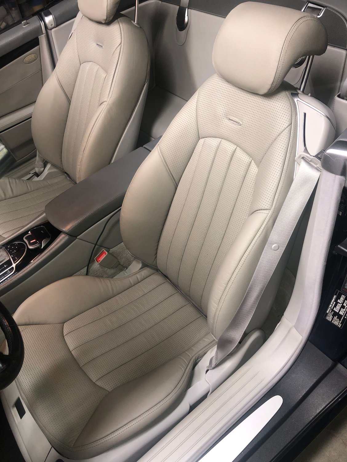

Finished product. I was told to let the sun and driving smooth them out - don't use a heat gun. I'm patient. They seem to be settling in quickly.

Chris - The emblems did not come with the new seats. I wasn't sure when I ordered and would have purchased new ones if I'd known they didn't. The emblems are easy enough to take off and put on the new ones, but know that the upper portion of the seat has 2 layers and the emblem goes through both with a backing plate. It's just like an old-school file folder with two holes on top where you fold the tabs over. As the pictures stated - the perforations were in the exact same place as the original (in reference to the seams), so I simply counted the numbers up from that bottom seam and pushed them in.
As for the heating elements - If you want to keep them, you have to mail your old covers in so they can transfer them into the new ones. I considered this, but I think I used the heaters once in the past 5 years. I simply don't drive my SL in the winter and Northern California is never that cold anyway. On the coldest days, I'm usually in my truck or my E class. That being said, I decided to take a look at how they're integrated and there's no viable way to do them yourself. They really are thin wires that are somehow embedded in the felt backing before it's attached to the leather.
If your seat is worn, I'd order a new pad. I don't have venting on mine, so it was about $35 and 2 weeks from the local dealership. I only did the driver side as the passenger didn't have much wear (my wife doesn't like convertibles).
This was a 2 day process, simply because I really took my time to ensure I didn't bugger it up. I did the first one starting around 1pm and quit right about the time the bourbon was giving me the courage to jump into the second one. The next day I did the passenger side. I'd say each side took about 3-4 hours. Start with the headrest, as that took the most patience. (Double folding into itself)
The main tools I used were needle nose pliers and a door panel tool from harbor freight. Besides the headrest, the only other PIA was the 3 metal rods in each seat back. They hold the rounded contour in place by utilizing little hooks that are buried into the middle pad. I creased the seat back over my knee, used the pry tool to open the hook and the pliers to push down on the rod to release it. There's about 4 connections on each side and 3 on the top. I attached the new ones with the same process.
Also, check the bottom springs. Mine were arched inward so I just pulled them and straightened them out. Made a huge difference. Use this as an opportunity to clean the seat belts. I used a 5 gallon bucket with some warm water / a bit of Clorox 2, a 2x4 across the top of the bucket and a small fingernail brush. After, I simply refreshed the 5 gal bucket with clean water and rinsed. Used a towel to dry, but left a potato chip bag clip at the top to keep the belt pulled out so it could fully dry (and to make it workable whilst cleaning it).
The only other thing I can think of is to check the back plate alignment before you cut holes in the back tabs. You might need to work/stretch the top corners a bit to ensure they lay under the panel. Then, just pull the fabric in the rear and use a razor to slice where needed to attach them to the seat frame.
