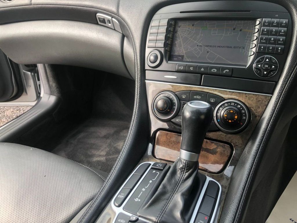

Here is my head unit
A lot of websites describe this as NTG2, hence confusion.
It is different to a lot of sites advertising Android replacement head units though, as it fills the whole space in the top of the console like below
I have DVD Navi Processor in the boot, so can not be NTG2.
Thanks

You've got MOST. I can tell by the 'big' Comand unit, no wrap around trim.
No, I've got no bad messages for you, just for the fun of it I tracked where the car was when that Comand nav screen photo was taken...
Many thanks for clarifiing MOST. Just need the facia adapter and I am sorted.
