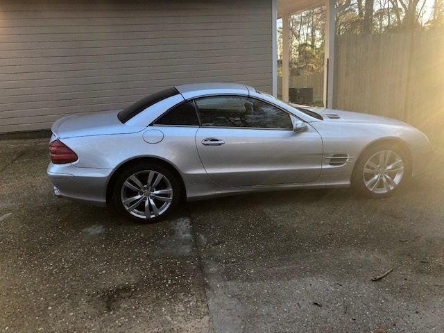

Well my forum friends, thanks to your wise advice and posts, my ABC problems now are part of the past..... replaced the hydraulic shocks for coil overs, recirculated the tandem pump and removed the fuses. Car is perfectly level now! I have one remaining issue, the Vario roof does not open. I have the troubleshooting guides and will be cracking my head to find the culprit. My scanner shows no fault codes for the roof..! So, something is hidden somewhere! Any good hints will be appreciated to facilitate my search for that hidden link...! The previous owner told me it was working fine till one day it quit..>!
My new puzzle!
