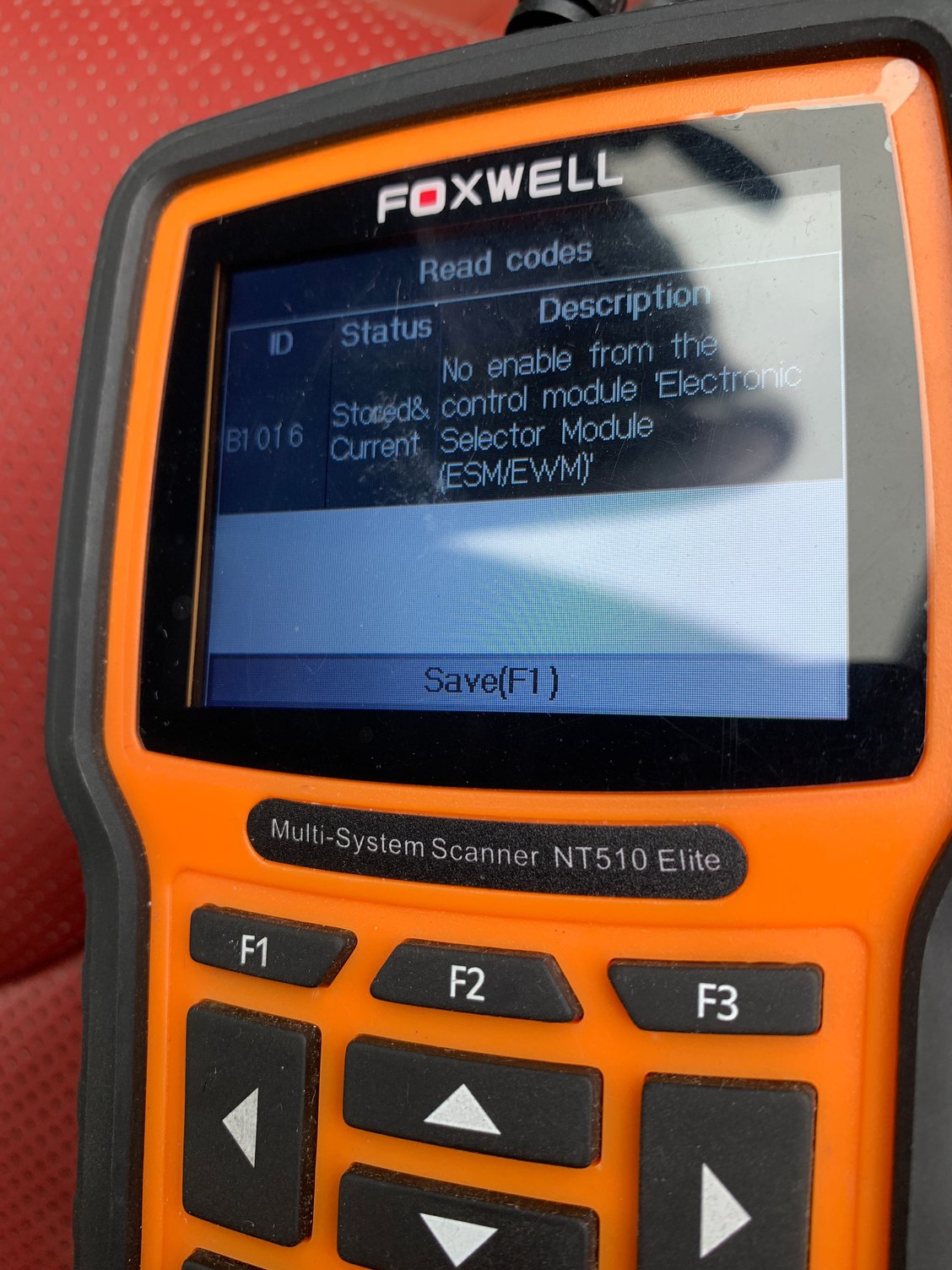

its a loud clicking from under the bonnet when I turn the key. I’ll investigate further as you have suggested but will be next week now as snowed under with work.
Pulled this code off with my Foxwell, which is making me think again about the safety interlock on the gear selector.

Everything with your issue points to a failed starter motor, because you can hear what sounds like the starter trying to engage.
But. That code you pulled sounds like the EIS not getting the security code from the shifter, in which case it wouldn't attempt to crank.
Can you move the shifter out of park easily - repeatedly - with your foot on the brake?

No I can’t move the shifter at all, it’s locked in the Park position.
However when I was turning the key and trying to move the shifter, the key locked in the ignition slot and I got the red “put gear-lever into Park” message, even though the shifter was already in Park.
Another clue perhaps that the shifter sensor is failing?

2) Can you confirm that the starter solenoid is definitely clicking in when you try to start? You might need someone under there listening while you try to crank. Should be a loud thunk - hard to miss. If so, then the starter permissions are all working.
3) Put your ear down near the roof switch, and with the ignition on, listen for the click when you push the brake. This will tell you that the lockout solenoid in the shifter is working. It's pretty reliable so it's probably working.
4) If you've got the click then the lockout pawl in the shifter is broken. Don't even think about the replacement plastic pawls - they're rubbish. Buy one of the nice milled-aluminium pawls on eBay - set and forget.
5) Search for the emergency shifter release technique (it involves a hammer and block of wood). Or you can cut the shifter lever and weld it up later - that is what I would do. You have to get it out of park to remove the console trim.
Then it sounds like you have an issue with the optical pickups in the shifter. Read through https://www.benzworld.org/threads/ca...ifter.3096231/
