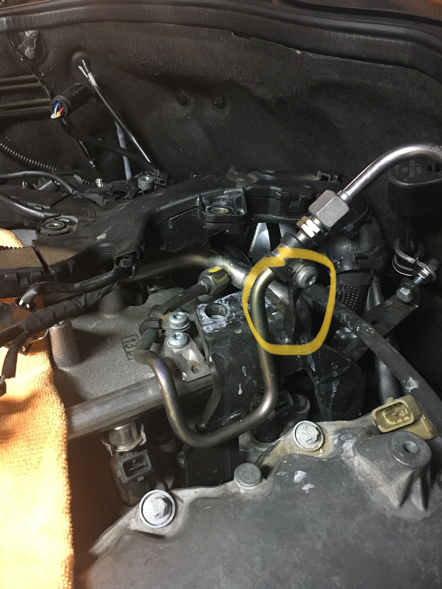

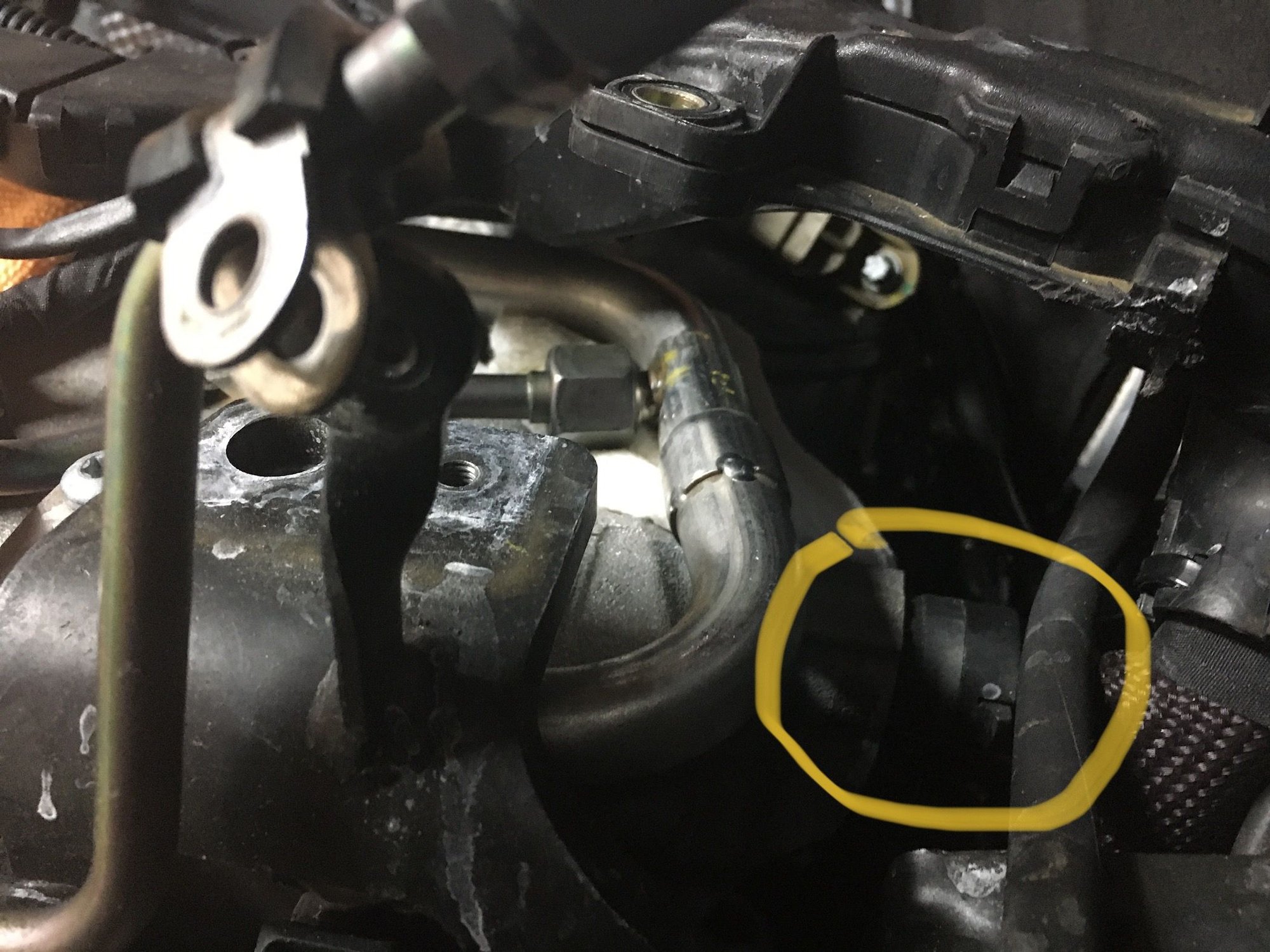

To see the o-ring, you have to get access to the rear of the intake manifold and remove the black plastic plug, it’s best if you just remove the manifold, which is a big job.
Heres some photos showing the general area of it. I removed the manifold from my car and took it to a welder who just welded the hole closed. The hole is in the manifold because cars without SBC (C215, W220…etc) have a brake booster connection there. On the R230 the hole is not used because SBC doesn’t use engine vacuum, so it’s just plugged because Mercedes couldn’t justify unique tooling for a intake manifold specific to the R230.
