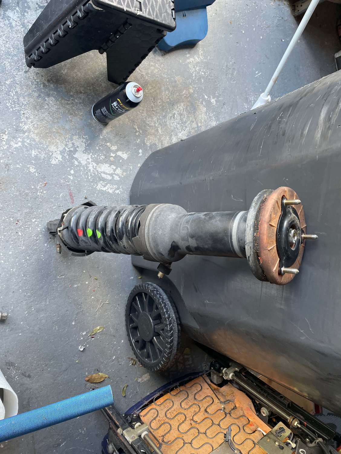

Anyone know how to replace the strut mount rubber? I have the strut off but not sure how to get the rubber bushing off. I take it you
loosen the square bolt/sensor with a socket/impact wrench? I tried a 27mm, too big, and a 24mm to small. I guess it's a 25 or 26 but I don't have those..
Not sure if I have the correct bushings either. They don't quite look the same.

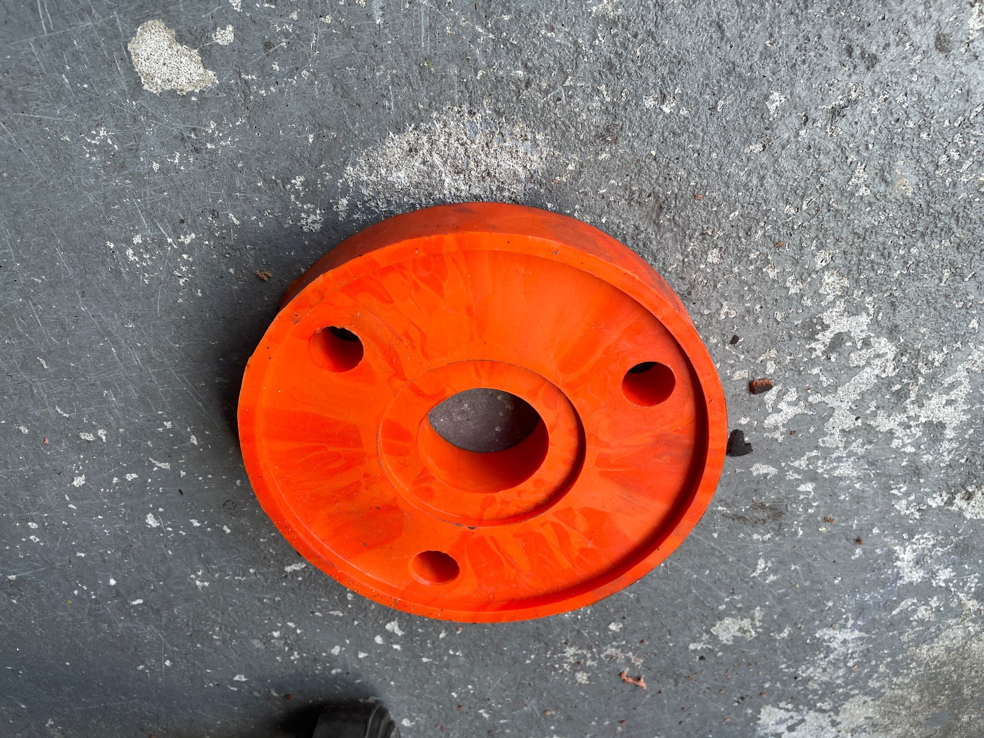

My bushings/pads got much worse since the above pictures and my struts started rattling more over small bumps.
I found this video on how the pads are secured. He is doing it the hard way. You don't need to do any hammering, just use a gear puller, ball joint press or tie rod press (I can't remember which one I used) and pop the top metal plate off of each bolt. You don't need to remove the bolts from the bottom plate. The orange pad is not rubber but a solid piece of plastic pretty much, like he shows in the video. It stopped the rattling on the passenger side but it now seems a bit harsh over small bumps. You can find them on Amazon now. I didn't do the driver side, I just tightened down the three bolts under the hood and that stopped the rattling on the driver side. I'll be getting some Arnott struts so I didn't take it any further.

Thanks for the reply. You have helped me by confirming the rattle issue is worn-out strut rubber. I've had the car for 2 years and have not had suspension problems before this. I don't want to take that strut off again but it should be easier this time. The person who did the original video told me he had rattle with the orange mount installed but I think I'll go ahead using your method. If the orange isn't quite thick enough maybe a shims or spacers are required to lock it down.

RMT replied. They only sell struts as a complete unit. I installed the harder rubber red Chinese-made bushing you can see in this thread. Works great with the original ABC strut that is working properly.
