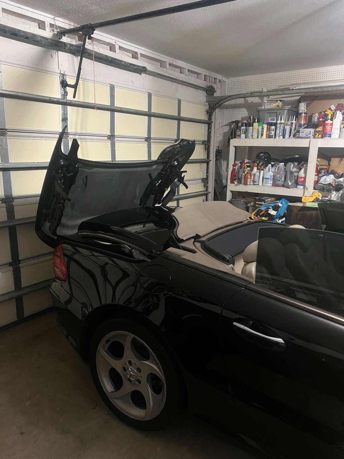

Hello all, recently picked up a 04 sl500. One of the hydraulic cylinders leaks bad. I’ve kept the top down to enjoy the weather but now it’s time to get it closed so I can repair the cylinder. It leaks too fast and the top won’t close by itself. Is it okay to more less assist the top by lifting it some while the button is being pushed? Not wanting to fully manually do it as I’m worried I’d have to have a computer to manually close the side flaps and need some sort of reset?
Old Nov 10, 2022 | 02:02 AM
Frederick NL's Avatar
Joined: Mar 2018
Posts: 1,442
Likes: 260
From: Netherlands
2005 R 230 SL350 (M112 3.7). Sold the 1966 W113 230SL recently
Manually assisting the pump in closing the roof is no option in my book. Instead, I would open the bypass valve on the pump and manually reverse the trunk lid and close the roof. Once that is done (see other threads for the how to's), you can let the car take of the flaps and trunk lid.
Old Nov 10, 2022 | 04:11 PM
jhicks6967's Avatar
Joined: Nov 2022
Posts: 16
Sl500
Okay

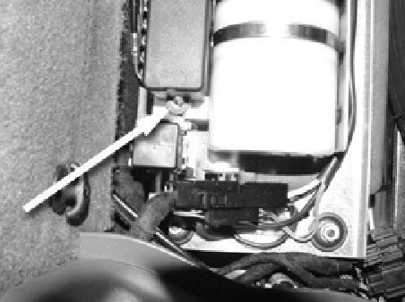

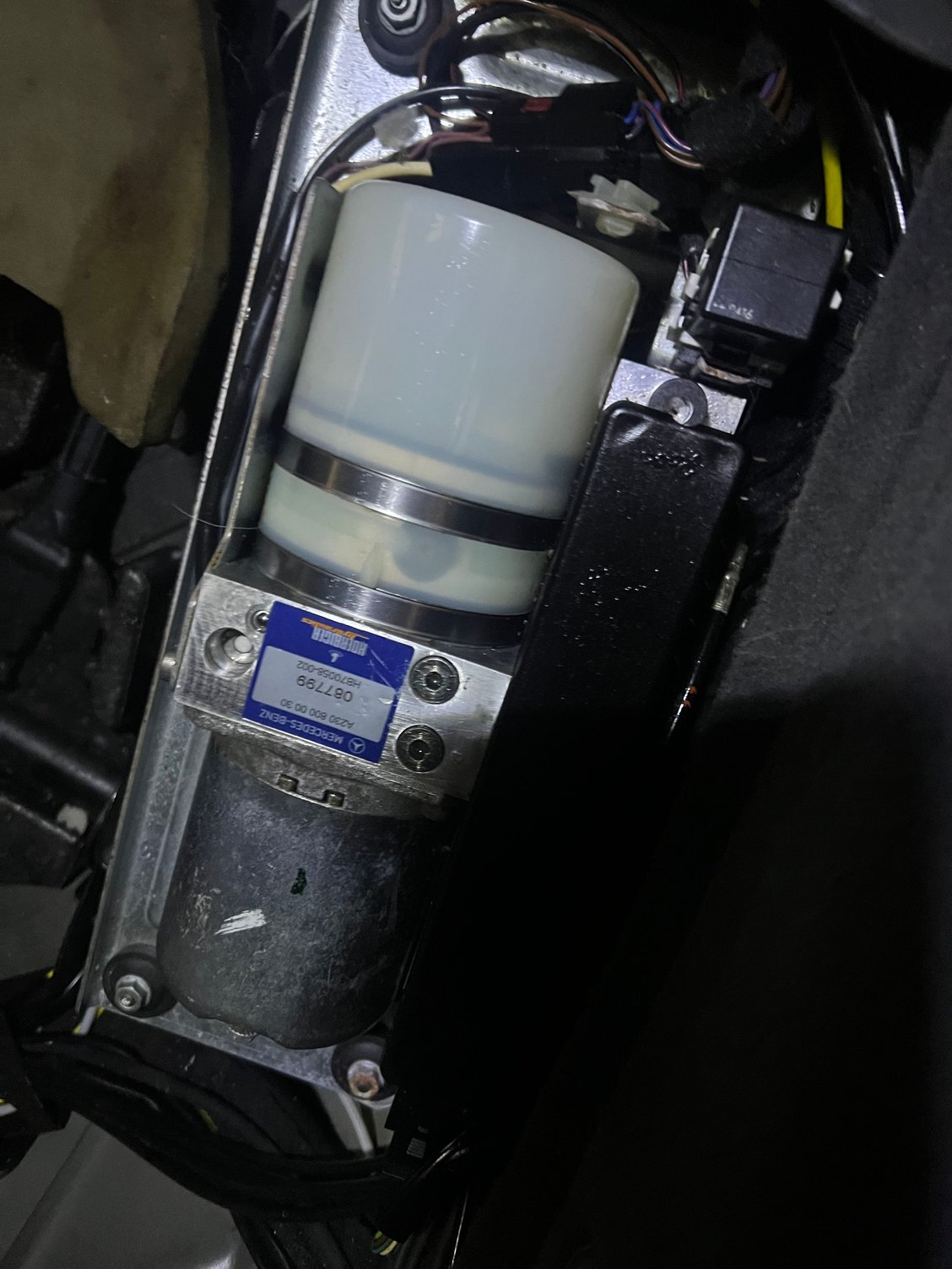

I’ll do that then. This is my current progress. From my understanding I need to release the pump pressure but I don’t get where I did that at. I see the two screws on the pump itself but the vid I have it shows another screw which I don’t see on my pump. After that it seems I need to release the two side brackets with the Allen wrench but they won’t budge at all. I’m lost lol
Old Nov 10, 2022 | 04:43 PM
Tom Manning's Avatar
Joined: Sep 2018
Posts: 746
Likes: 185
From: Melbourne, Australia
2005 SL 500 R230
Here's the official MB procedure in the pdf.
You do have the screw:
The tubular frame locks open easily clockwise IIRC - you're probably trying to turn them the wrong way. Only gentle torque required here.
Keep at it!

Old Nov 10, 2022 | 07:27 PM
jhicks6967's Avatar
Joined: Nov 2022
Posts: 16
Sl500
Thank you so much. I tried turning both ways and no luck. I’m wondering since I have the trunk popped in the backwards position instead of flipped forward maybe that could be why the bolts won’t budge ?
Old Nov 10, 2022 | 08:25 PM
Joined: Sep 2018
Posts: 746
Likes: 185
2005 SL 500 R230
The boot has to be open in the forward position, then the roof has to be moved to the load assist position, as per the instructions in the pdf.
Old Nov 11, 2022 | 01:47 AM
Joined: Mar 2018
Posts: 1,442
Likes: 260
From: Netherlands
IIRC the unlocking of the tubular frame is done by turning one side clockwise and the other side anti clockwise. In my car that does take a bit of effort and I think I took it in steps so as not to put friction on the tube and locks. Make sure the bypass is open.

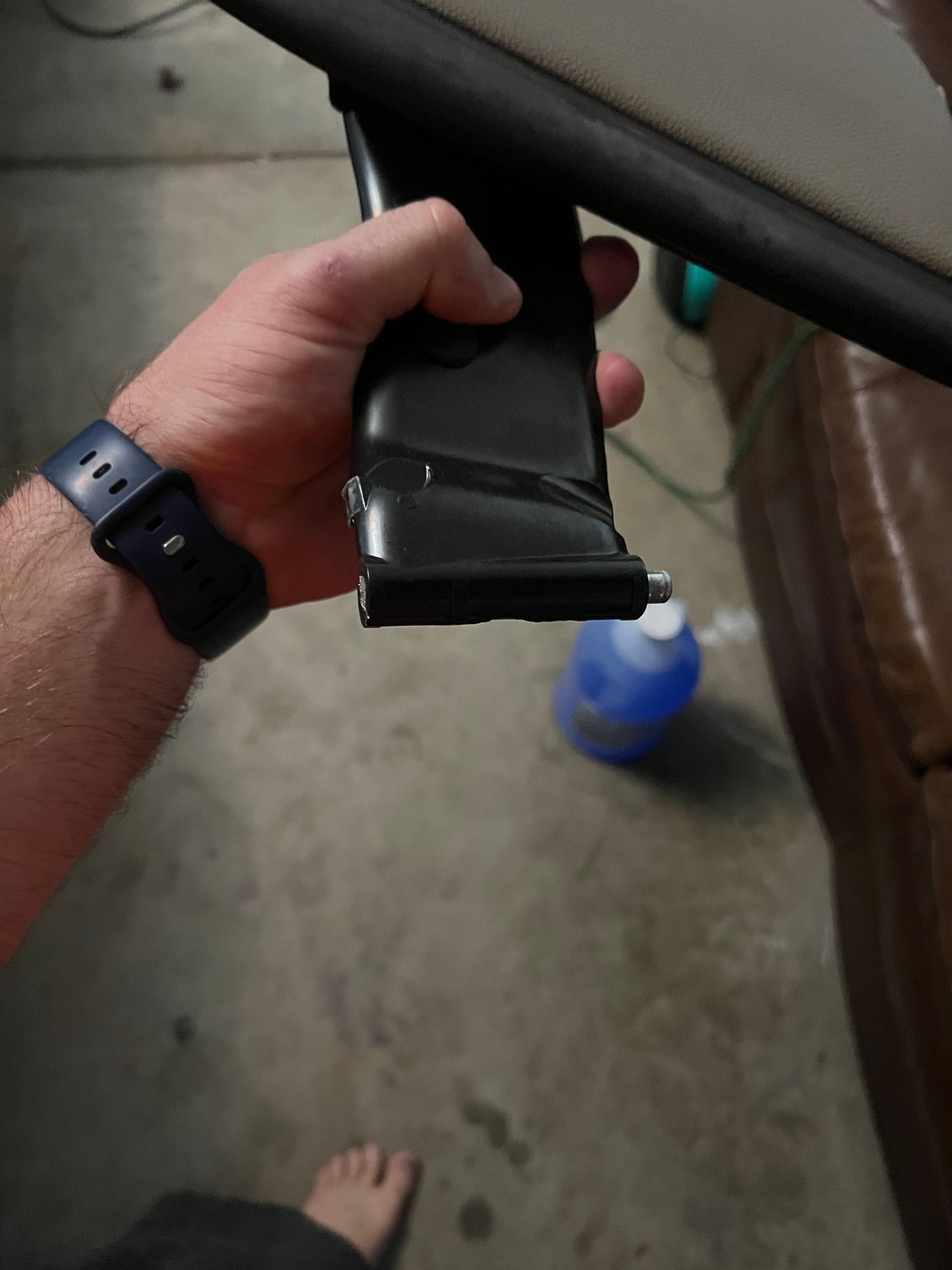

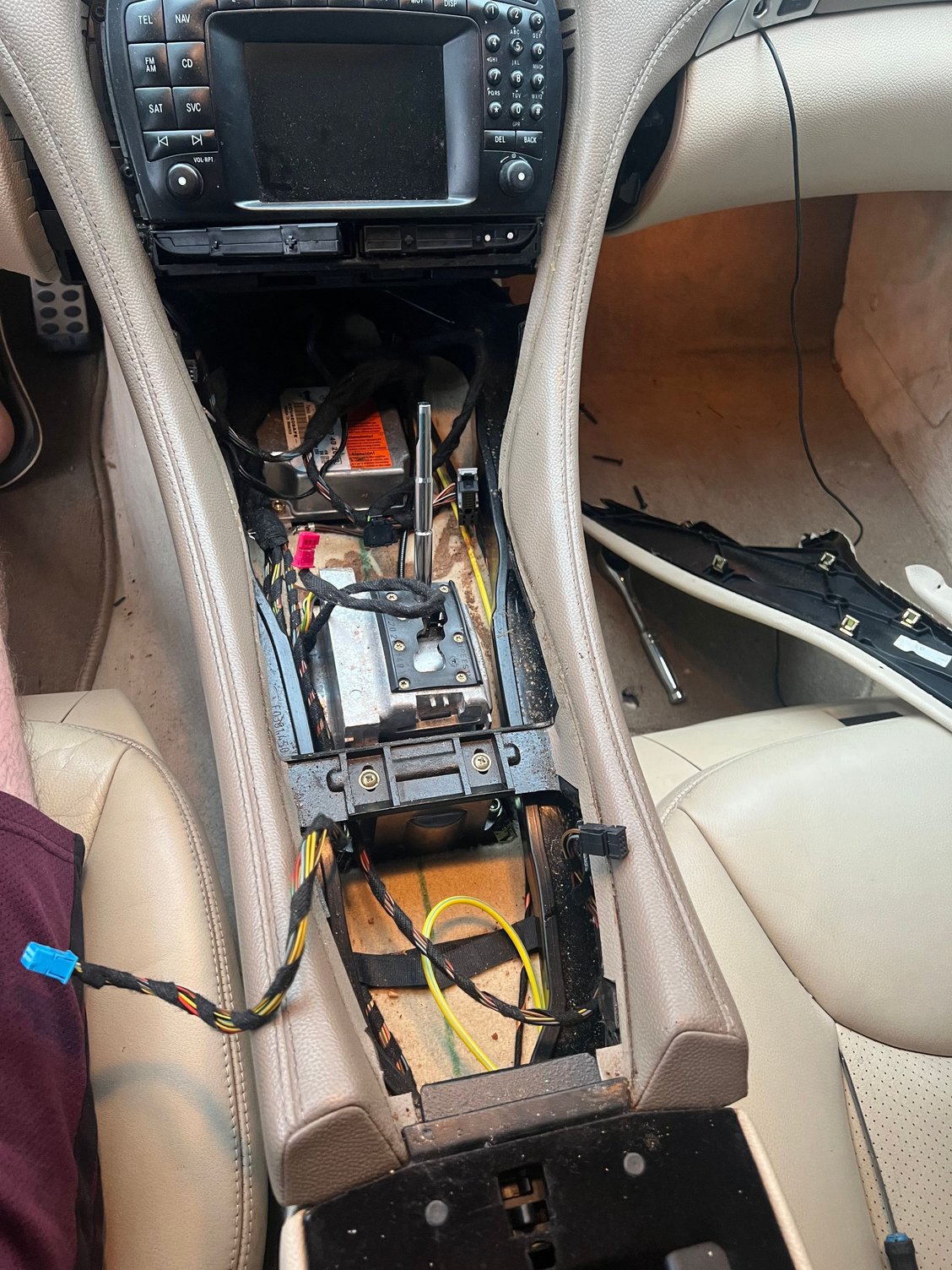

Joined: Nov 2022
Posts: 16
Sl500
Originally Posted by cdk4219
I believe the kit I got came with both levers in case. Not sure if they provide that anymore.
ah okay. Started the process of removing everything to see what lever I have. I’m stuck at this point lol. Have the 3 bolts and 2 screws removed. But the bugger won’t come out. I’ll have to do some research tonight at work to see how to do it without breaking stuff like I did before.
Old Dec 31, 2022 | 06:36 PM
Joined: Sep 2018
Posts: 746
Likes: 185
2005 SL 500 R230
If you're going to do it all from the top, then you have to cut the cross brace. There's no other way to get it out.
You can glue it up later or just leave it - the console is plenty strong with it cut either sided.
Once cut, wiggle it up and out gently then slip off the retaining clip that holds the selector rod. Replace the clip with the new updated design upon reassembly.
Old Dec 31, 2022 | 06:54 PM
jhicks6967's Avatar
Joined: Nov 2022
Posts: 16
Sl500
Outstanding thank you. I for sure don’t mind cutting the cross brace at all. I can always fab a new one from metal later. Thank you !
