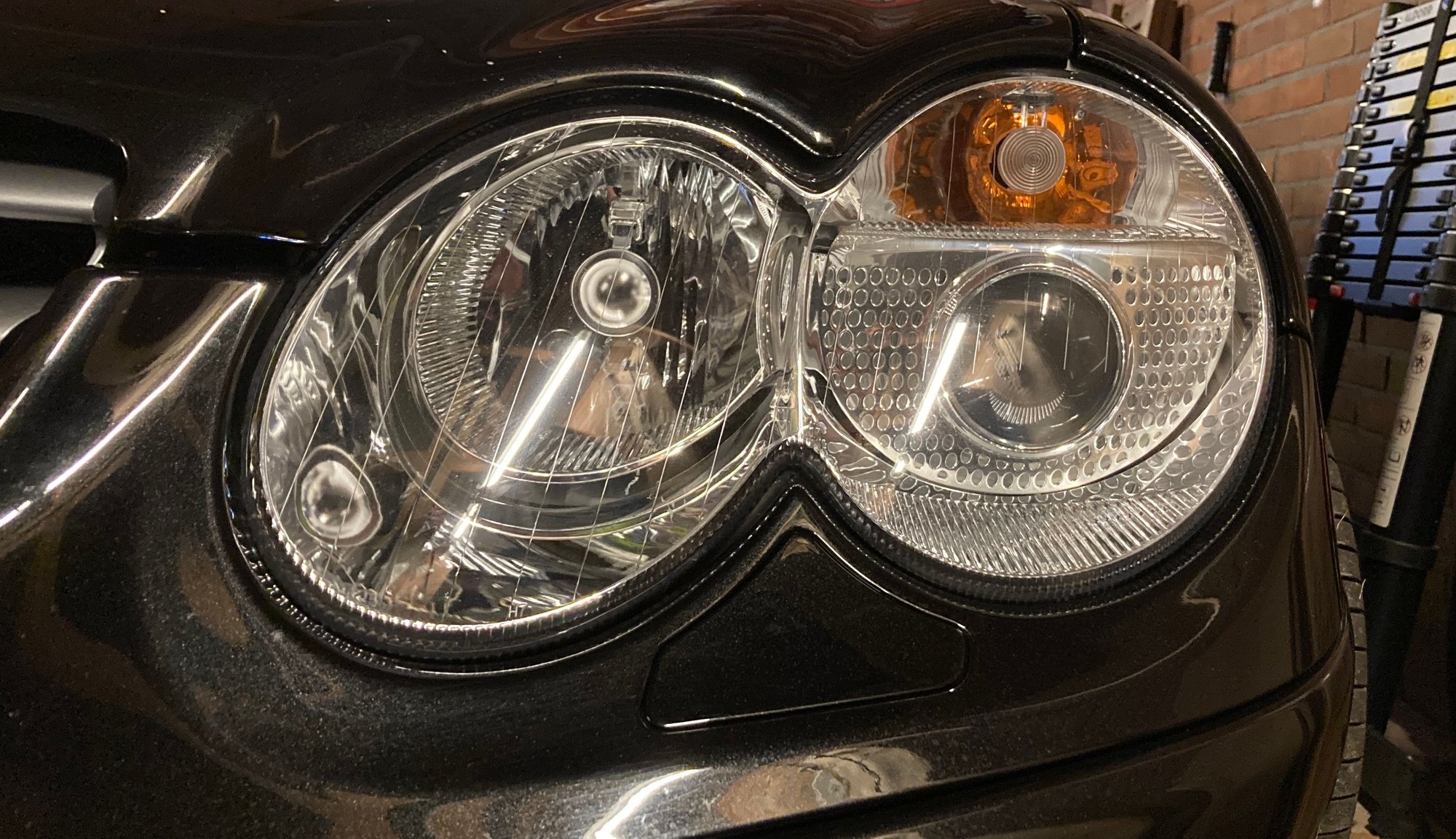

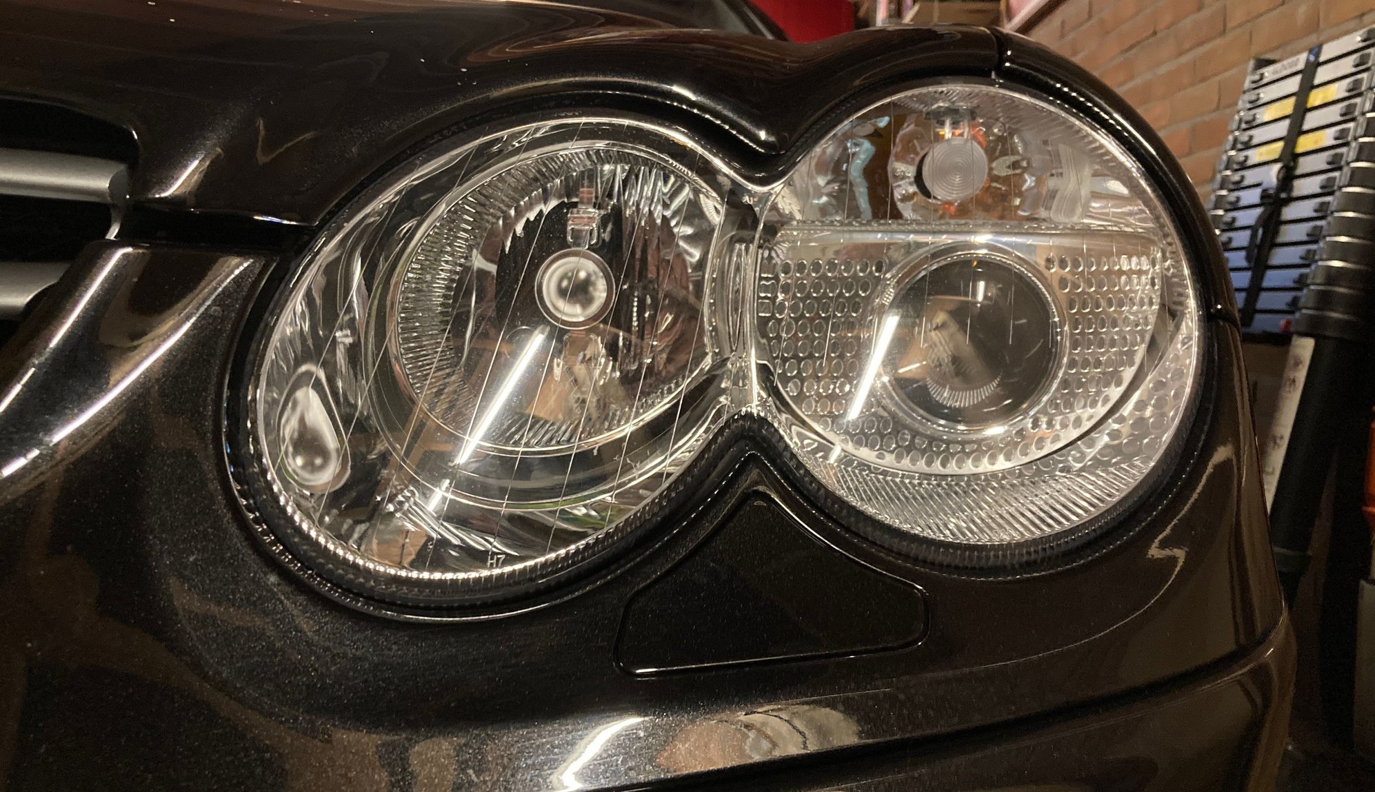

With patience and some hand scratching it can be done. My hands aren't particularly small. While you're at it, perhaps consider using 'white' bulbs. They are as orange as can be when lighting up.
standard
Osram Diadem
