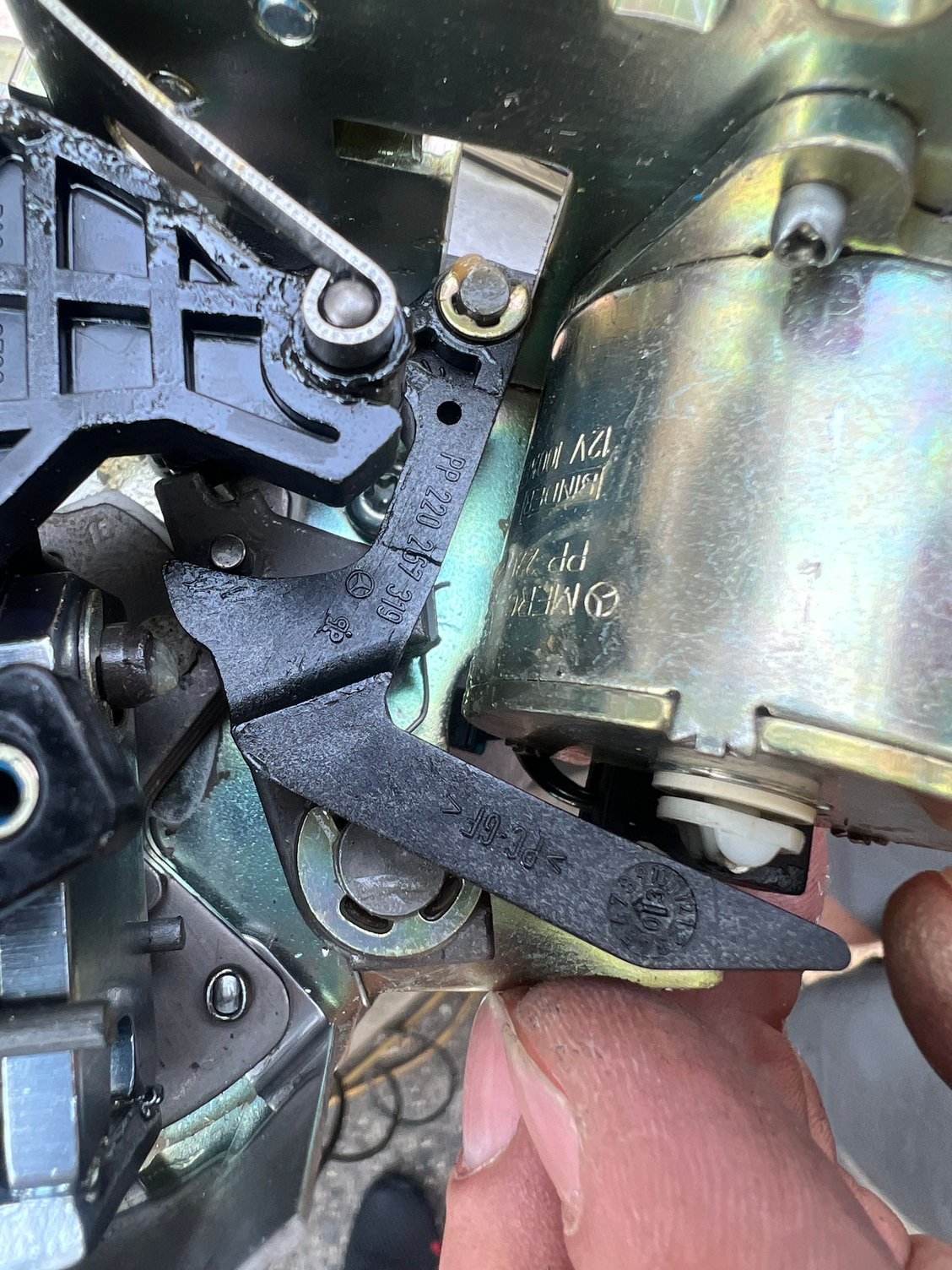

SL/R230: Sticking in park

Is there a guide for replacing plastic piece that holds shifter in park Any help appreciated thanks

Getting the shifter out is the time consuming part. Easier through the top - cut the brace across the console and wiggle it out.
Replace the clip that holds the rod to the shifter https://www.benzworld.org/threads/ne...#post-18403272
Once the shifter is out on the bench it's easy to get apart and replace the pawl.

You can hear it, not see it.
The plastic pawl makes a soft click which you can hear with your ear to the shifter.
The new milled alu pieces make a very audible and quite loud, satisfying metallic click when you apply the brake. It's really clear. Was the design ever improved? AFAIK the alu pieces are all after market.
On the clips that hold the rod to the shifter, the new one really is a far superior design; you can tell by looking at it.

I'm currently experiencing this on my car. It has gotten progressively worse to the point I'm not driving much right now.
It started off a being a little harder to shift to now me needing to use considerable and strong force to shift it from P to D.
I replaced the brake switch to no avail. My options are now to remove the shifter and get rid of the piece all together or replace to an aftermarket aluminum piece.
Also think the replacement shifter is 400-500$ but for what? a 30 cent plastic part? No Thanks!

I'm currently experiencing this on my car. It has gotten progressively worse to the point I'm not driving much right now. It started off a being a little harder to shift to now me needing to use considerable and strong force to shift it from P to D.
Classic sign of the pawl cracking before it breaks. That's how they fail. Once you have it out and under a mag light you should see where the crack starts.

Good news gentleman I got this repaired and resolved.
I want to thank Victor from Restore your Mercedes, what a class act. He was able to tackle the whole job from the top without going under the car to disconnect the linkage and without cutting or modifying the cross bar! What a master technician. He was thorough and meticulous with the car as if it were his own. We took no shortcuts and did everything by the book leaving nothing to chance. Including re-adding rivets to the shifter, increasing the width of the aluminum shiftier slot as well because it wasn't an exact match in diameter(probably a micron to snug). He was able to complete this in 4 hours and I was on my way. Silky smooth shifting now and no clink that I have read about. I couldn't be more happier and can drive the car again with peace of mind. In addition to that my plastic piece was on it's last leg, it has a micro crack and 2 hairline cracks on the backside...it was only a matter of time before I got stranded. I can't thank him enough because my alternatives were not looking pretty, i.e new shifter, dealer etc.
This is the piece I got from amazon- direct fit.
Amazon Amazon
