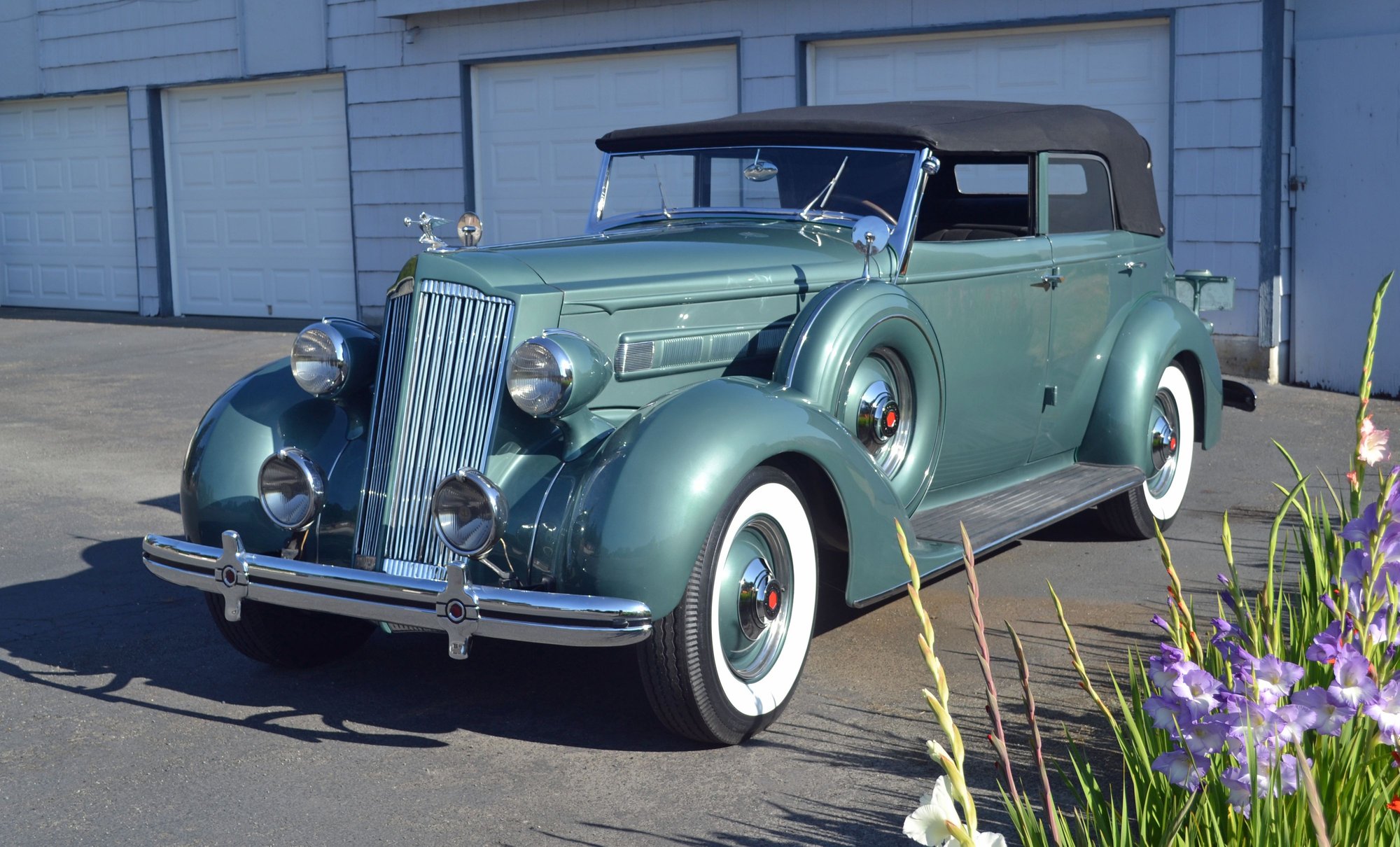

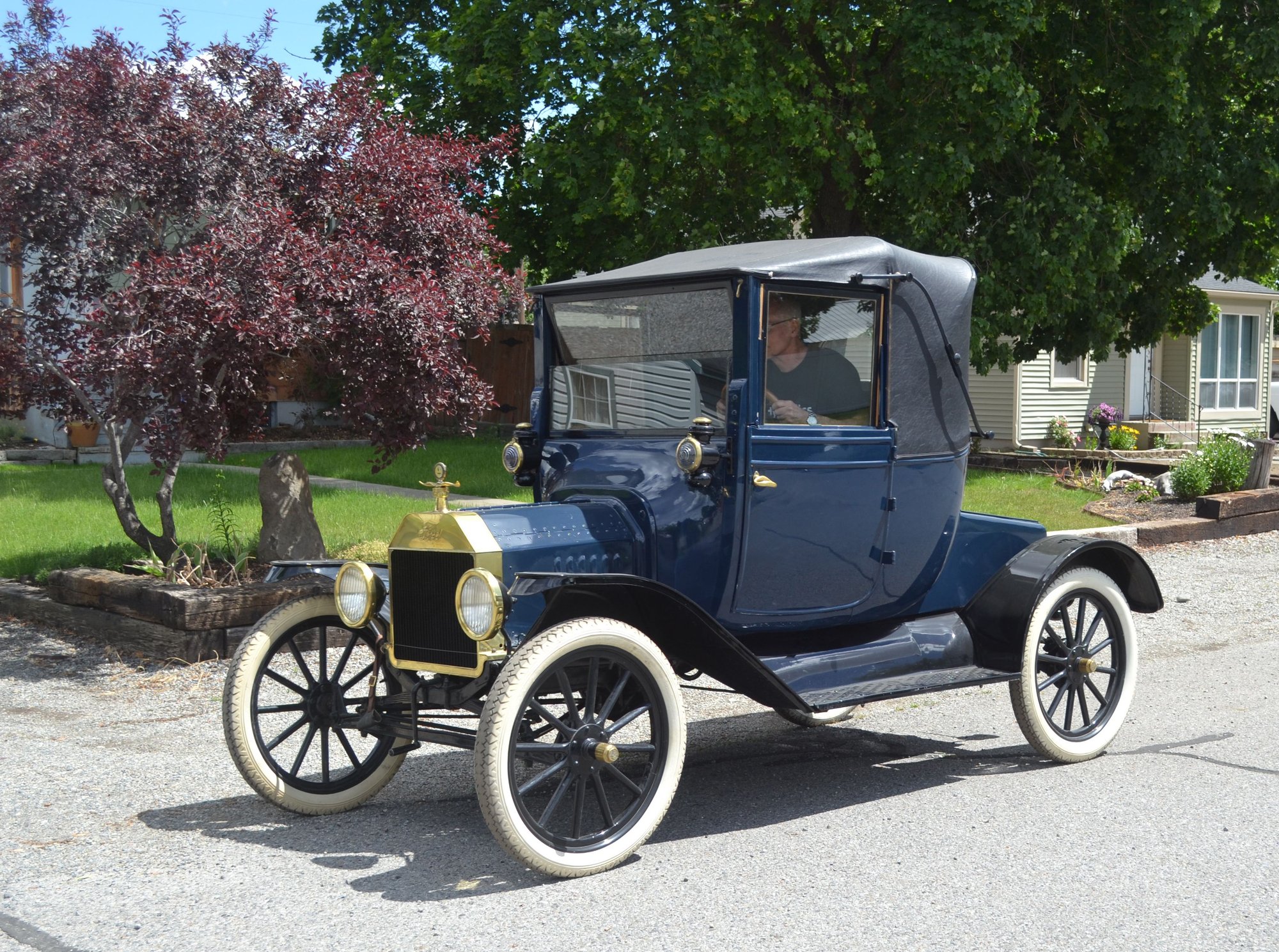

My 2 current cars.
A very rare 1916 Model T coupelet. Coupelets were made for 3 years and only about 60 are known to exist.
Last year I finished a total repaint, along with doing a new leather interior and making a new top for the car. I did the work myself.

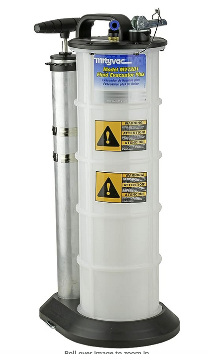

Another consideration is the 2015/2016 SL400. It has the M276 3.0 liter bi-turbo that can be easily tuned to produce about 400hp. Otherwise it's at 329hp stock. I found the big advantage to the SL400 is that the electronics are improved, is available without ABC, but still has adjustable suspension settings, is lighter, and MUCH easier to work on in the engine bay compared to a V8. Though you said your wrenching days are over, a simpler engine should mean cheaper maintenance costs. The sweet thing about all of these cars is that the oil filter is on top of the engine and accessible from above, AND the prescribed method for oil changes is to vacuum out the oil through the dipstick tube, and not crawl around under the car. MityVac (and others) make a nice extraction tool for about $100 or so on Amazon. There are both hand pump and air compressor models (I prefer the air compressor since I can start the extraction and come back after 10 minutes or so).
https://a.co/d/hA3EBE8

Beautiful antique cars, by the way!

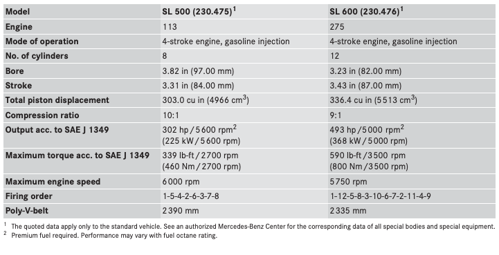

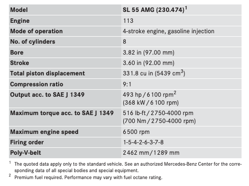

Here's the Operator's Manual from my 2004 SL500. That might answer your questions regarding tire size.

I love that green car!! Very very nice.

The standard 5.0 liter M113 was always rated at 302hp. There was a 5.4 liter M113 AMG version that produced 493hp.
