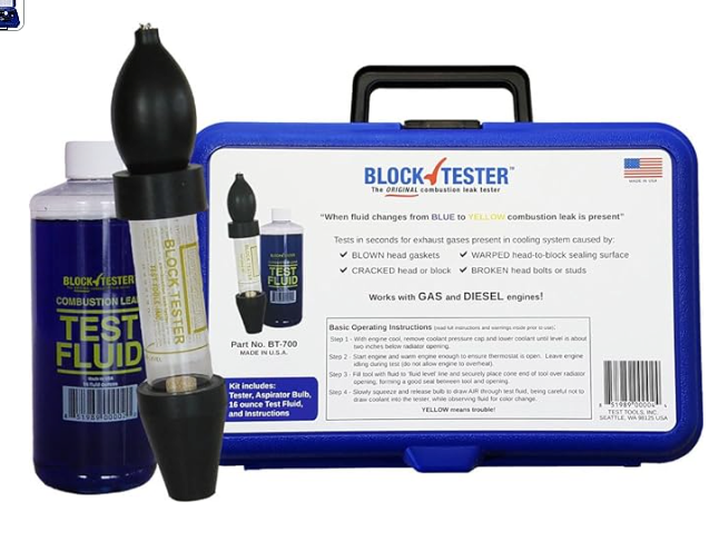

Have you checked for any coolant contamination in the oil or vice versa? Have you done an engine block test for exhaust gases in the coolant? If the car stalled when splashed with water, you can be assured enough water entered the engine to stop ignition OR something shorted out electrically. If the former, the cylinder block or head may have been fractured and when the car reaches operating temperature, coolant may be forced into the combustion chambers, causing the car to stall. A simple and inexpensive test of the cylinder block should be done by you or the shop. Use something like the kit below. If there are exhaust gases in the coolant, the fluid will turn pee yellow. That means you have a blown head gasket or a crack in the block or head somewhere. Hope it stays blue and then look for other causes. As far as the gas (a.k.a., petrol) squirting out by the filler tube, sounds like a blockage in the fuel line somewhere.
