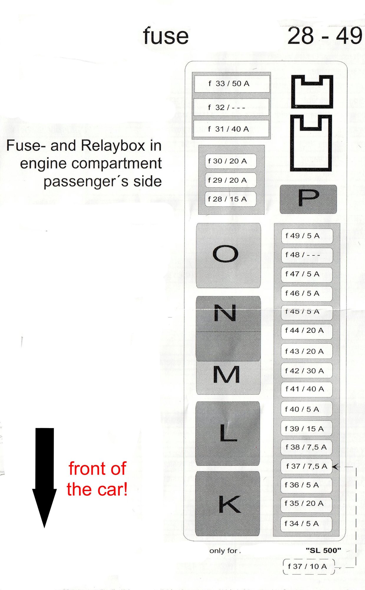

Turns out it was a blown fuse. Fuse 38 specifically. I tried again with getting LEDs to work with the dome but no luck. Sticking with the existing bulbs.
Hi where is fuse 38?
Old Jul 5, 2024 | 04:54 AM
tacotime's Avatar
Joined: Apr 2024
2003 SL500
Front drivers side fuse box under hood I think. Sorry don’t have the fuse diagram handy but it is on this forum somewhere.
Thanks mate

Originally Posted by Frederick NL
thank you
