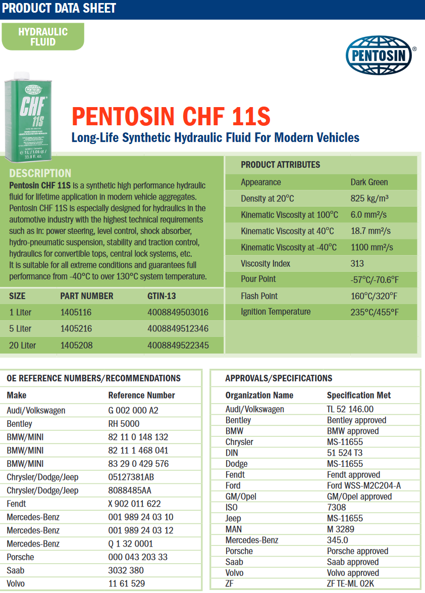

To make sure anyone reading this isn't distracted by misinformation, below is the data sheet for CHF-11S which:
-References the specs / approvals it meets for MB (345.0, also attached).
-Specifically links it to the part number of the "MB Genuine" hydraulic fluid.
"Pentosin CHF-11S" also happens to be printed on the "MB Genuine" bottle...so it's "essential to note" that they are one in the same.

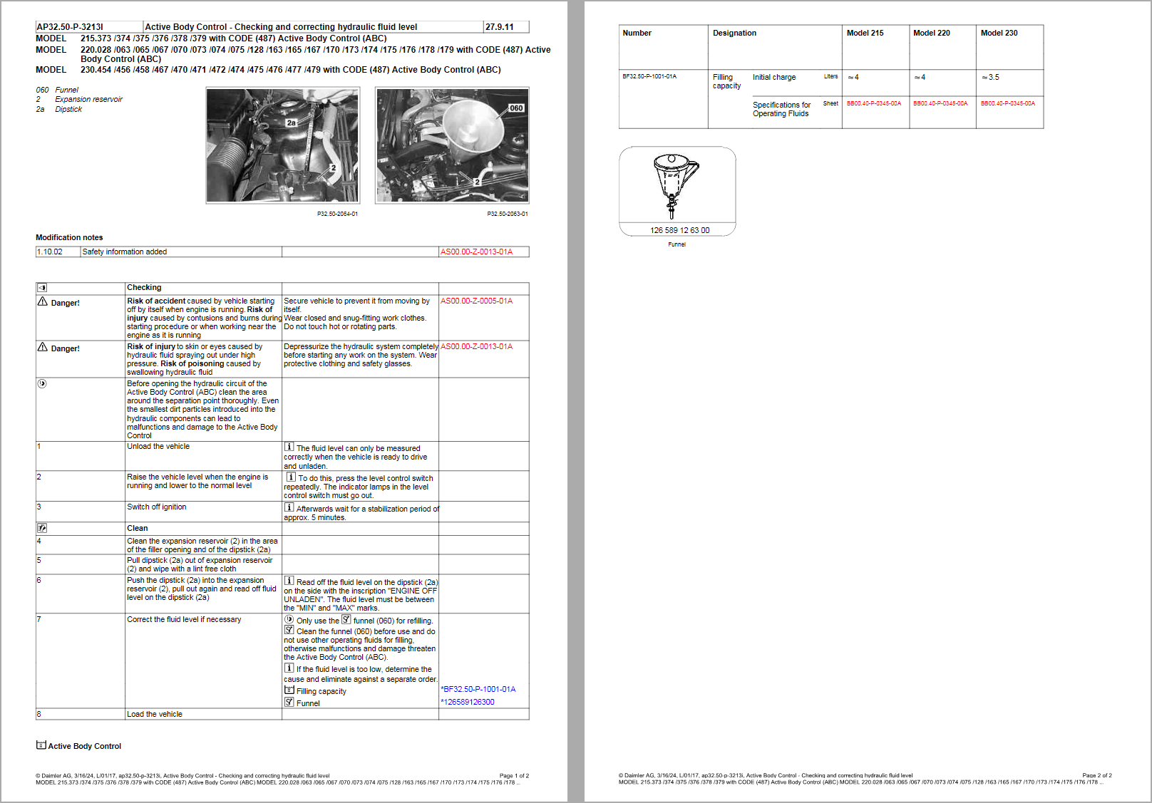

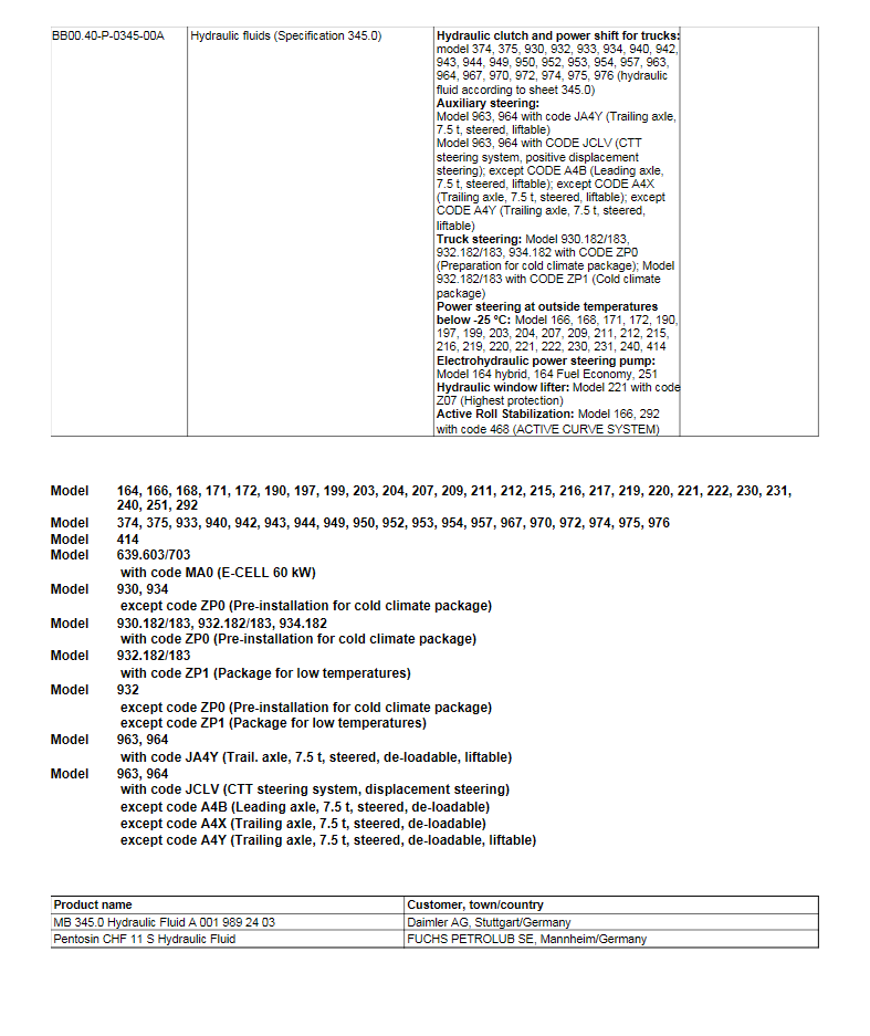

As for "MB insider information" to help settle the subject, here it is straight from WIS (factory service manual):
(Note the reference document numbers and how the MB Hydraulic Fluid and Pentosin CHF 11S products are bundled together).
