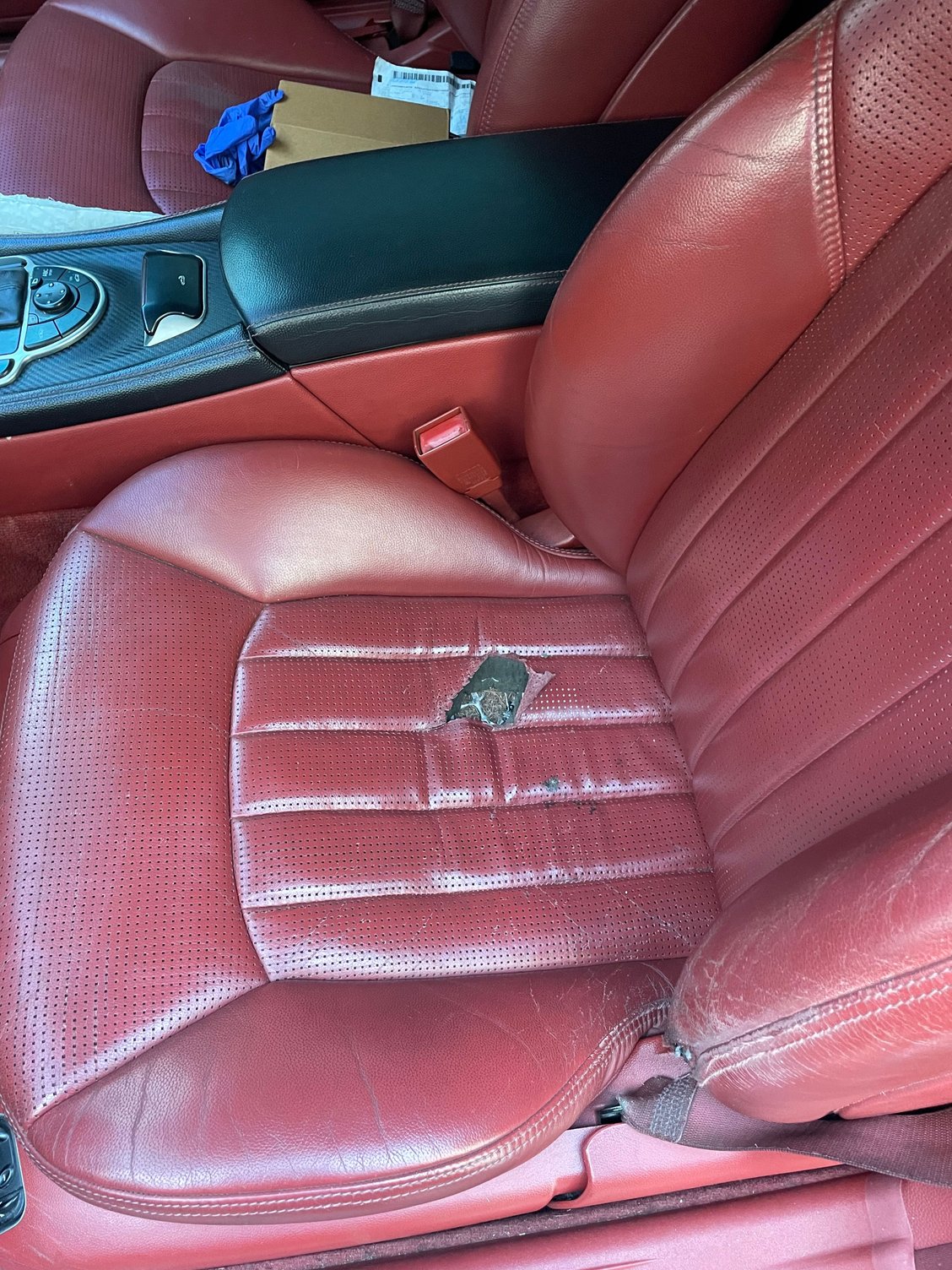

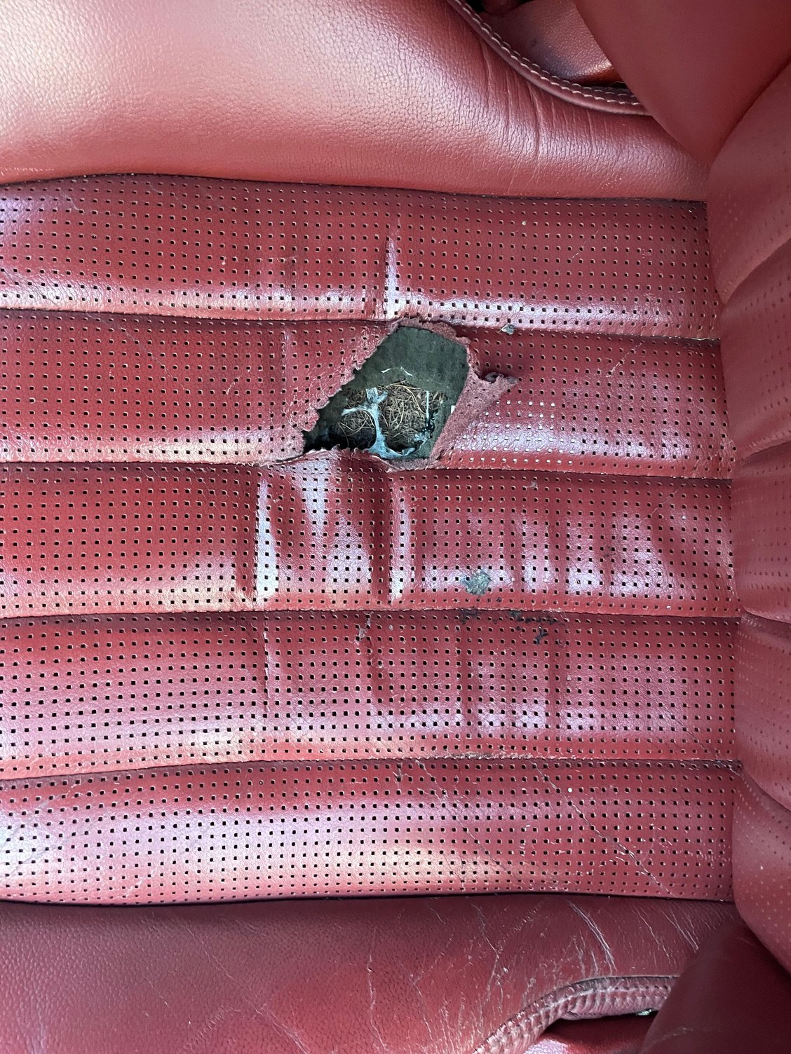

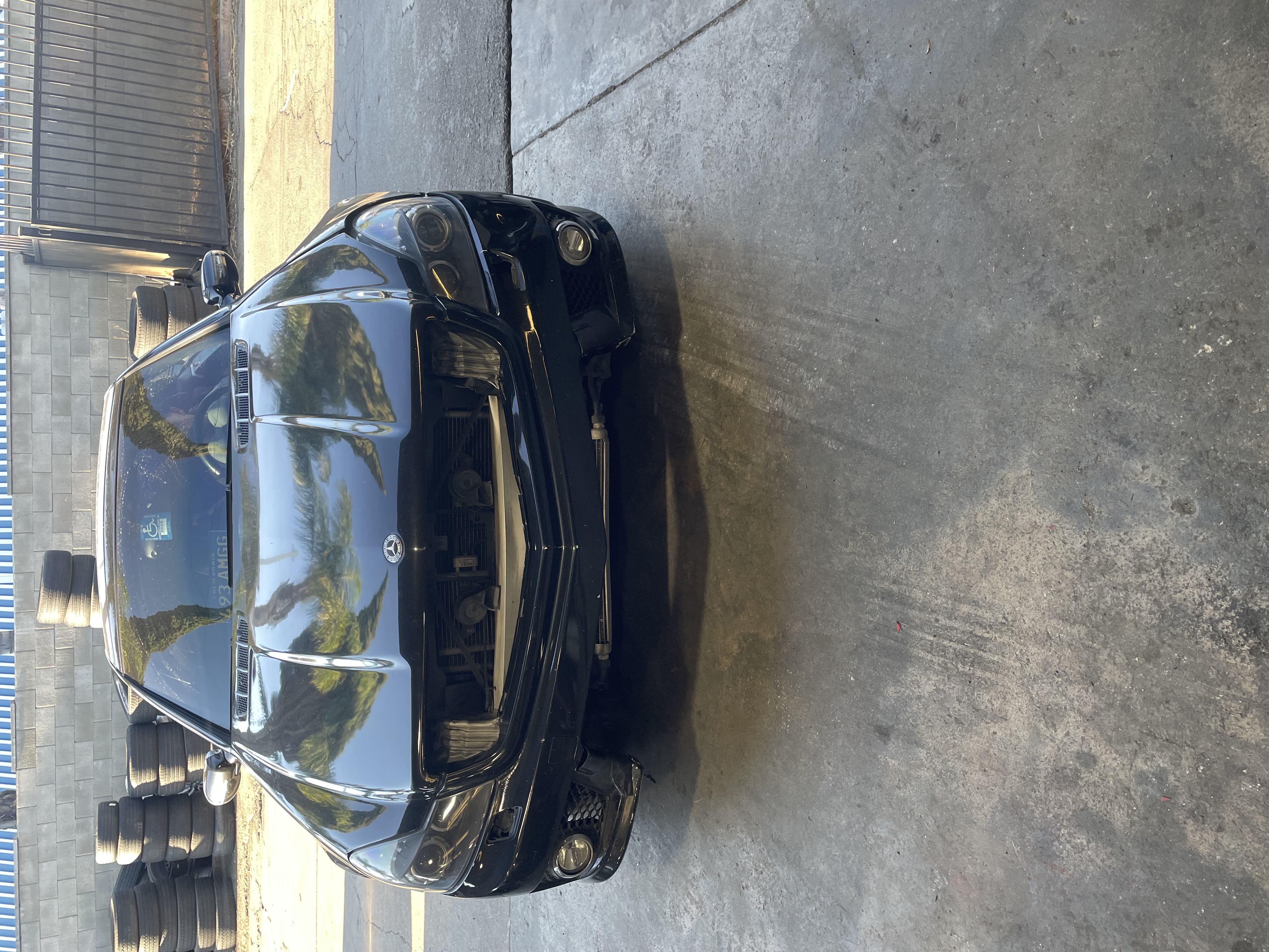

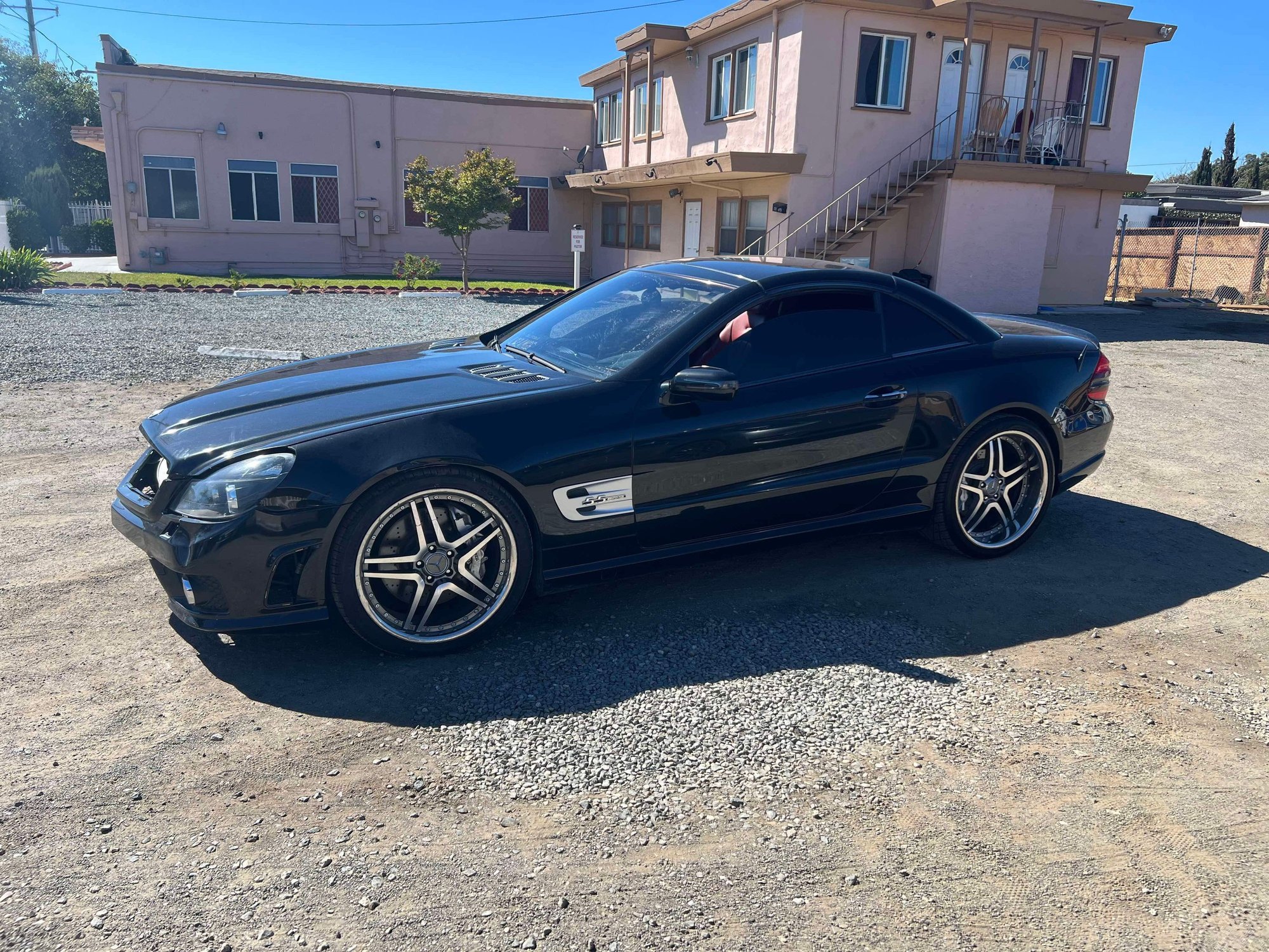

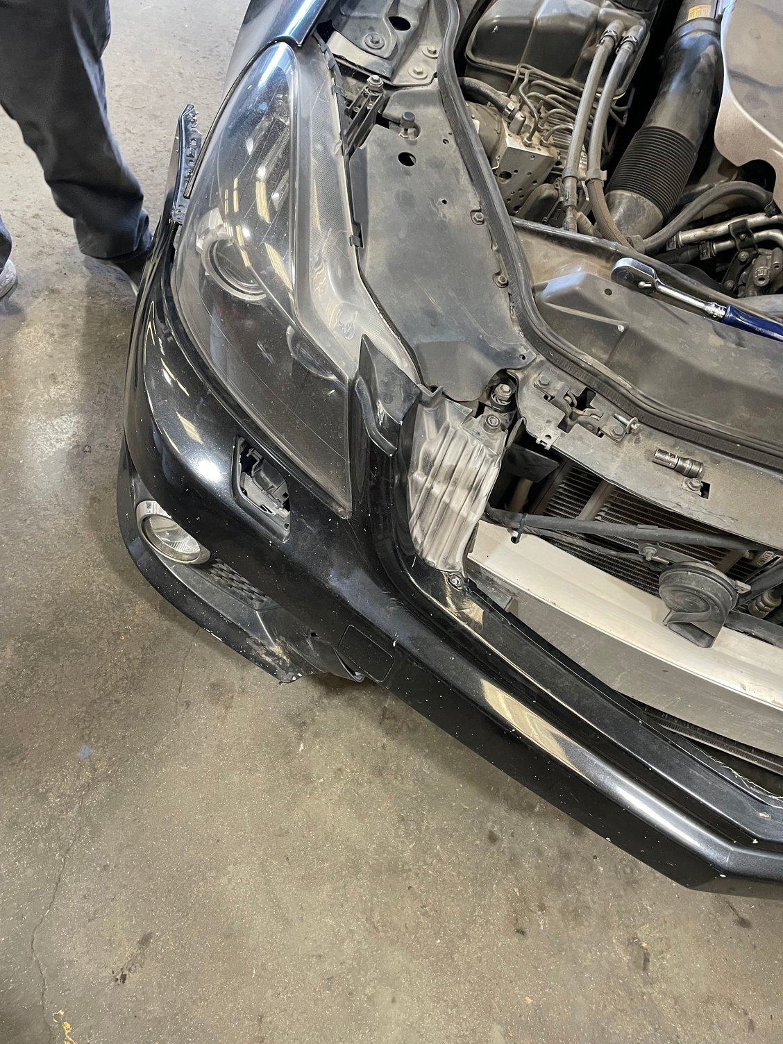

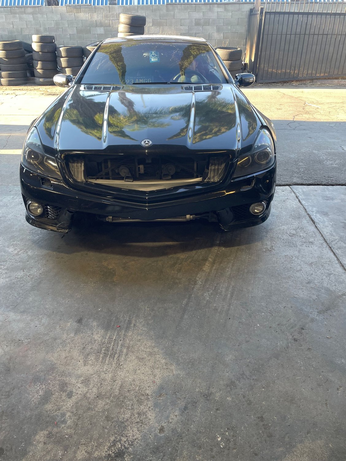

I am the current owner of what I believe used to be member @SpiritR230 ’s SL55.
His old FS thread could be found here.
Unfortunately, previous owner(s) between me and him heavily abused and neglected this once glorious beast.
45k miles later, destroyed front bumper, missing side vents, pouring coolant, torn seats, bent and cracked aftermarket rims, almost no electronic functions, loss of power, every single light in the dash is lit up, ESP, ABS, ABC, SRS, (over 15 malfunctions) and over 20+ codes coming up from my Autel scanner.
I am no stranger to MBs or 55 AMGs. I love this spec so much. Still not sure at the approach I am going to take upon restoring it. May my wife forgive me for taking on this money-pit.

So far my game plan is:
  1. find and address coolant leak
  2. Inspect BCM, send for repair if bad, and install fuse-mod
  3. check all fuses including underneath passenger footwell
  4. try to diagnose why the key doesn’t turn in the ignition (only Push-to-start works, SOMETIMES, it is getting worse)
  5. install second-hand Davies Craig pump from@SICAMG (thank you)
  6. source new plastic lens for headlights and replace aftermarket xenon with LED bulbs
  7. try to self-PDR the driver side fender
  8. replace the bumper reinforcement bar (bent in)
  9. look for a deal on a 63 front bumper or try to save the one I have by using a donor section from a sl550 (maybe?)
  10. repair the corner of the driver seat corner handle / seat belt hole (completely busted)
  11. get quotes for front driver seat upholstery repair or replacement seat covers from L-seat
  12. detail the car: ozone machine (remove the weed smell from the interior), and paint correct (soooo many spider-web scratches)
