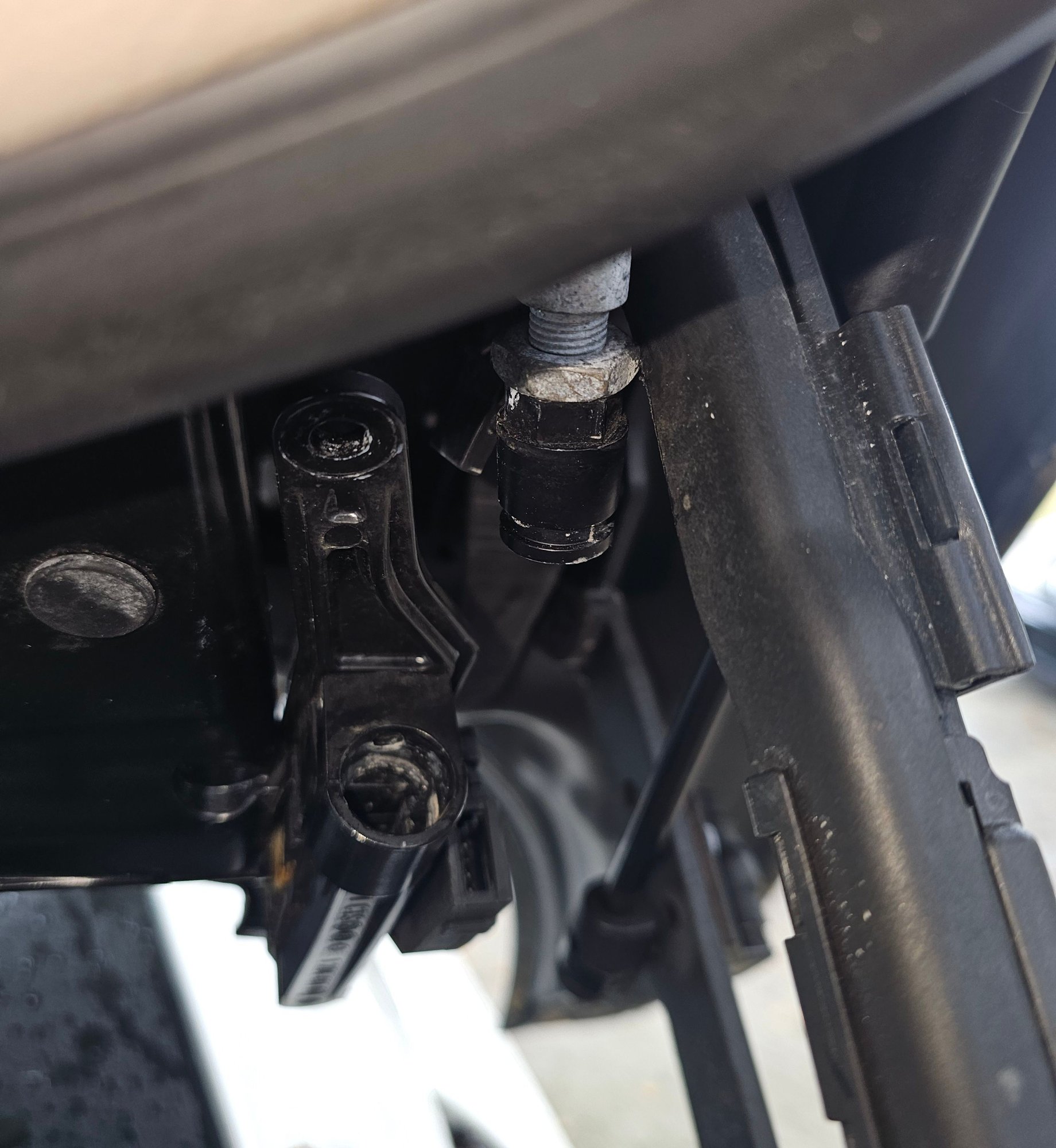

I purchased this car knowing it needed some work. Roof flaps move freely, appears to be missing part at the end of the cable that goes to the flaps. Any help with part number or availability? See photos.

There is supposed to be a rack gear. Unfortunately, it is not available as a separate part.

so, are you saying I need to purchase the assembly or are the cables available separately?
also, would you have the part numbers? I can start searching salvage yards that way.

Mercedes just sells the full assembly. 2308201942, lists for about $600, but around $400 from the discount dealers. Lots on ebay, but most are priced higher than new.

This rail gear is what I need.

Yes, but you will probably need to buy a full assembly to get it.

thanks. I found a guy that had what I needed and sold them to me.
