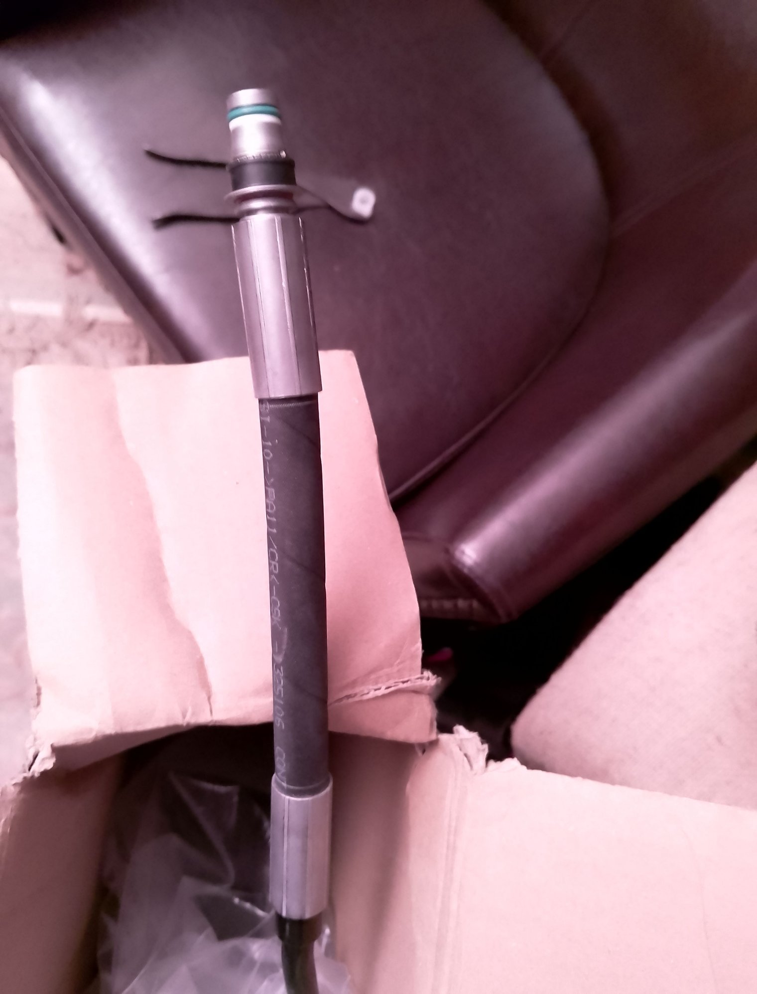

Question How tough to Replace Right Rear Hydraulic Hose to the Strut? Part a2309970352
How tough is it to Replace the Right Rear Hydraulic Hose that goes from the valve block to the Strut? Part a2309970352
Are there any how to videos or threads?
It looks like it goes over the exhaust and through tight spaces.

Question
A wild guess you need to remove the exhaust. It seems like 20 hours or more for me to replace the hydraulic hose. Although he does not use the coupler in this video Bing Videos I want to try this coupling Eaton Walterscheid Metric Hydraulic Tubing Fitting - Straight Coupling 10mm Tube | eBay This way I buy a brand new hose A2309970352 use a tubing cutter to cut off the metal tube about an inch away from the rubber hose crimped metal piece that is about 18 inches from the quick connect strut connector; and install the corresponding new piece. Do I have it right for 10mm od (outside diameter) metal hydraulic line? Will this work? See photos.

Hydraulic Line Quick Connect Right Rear?
Hi guys:
Is this connection just a quick connect where I just grip the black metal female sleeve on the 690 line, and pull it away from the silvery male connector on the 600 line? See pics of the line connected to the rear valve block at the right rear hydraulic line to the strut connector line.
