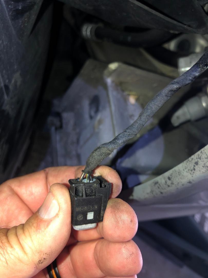

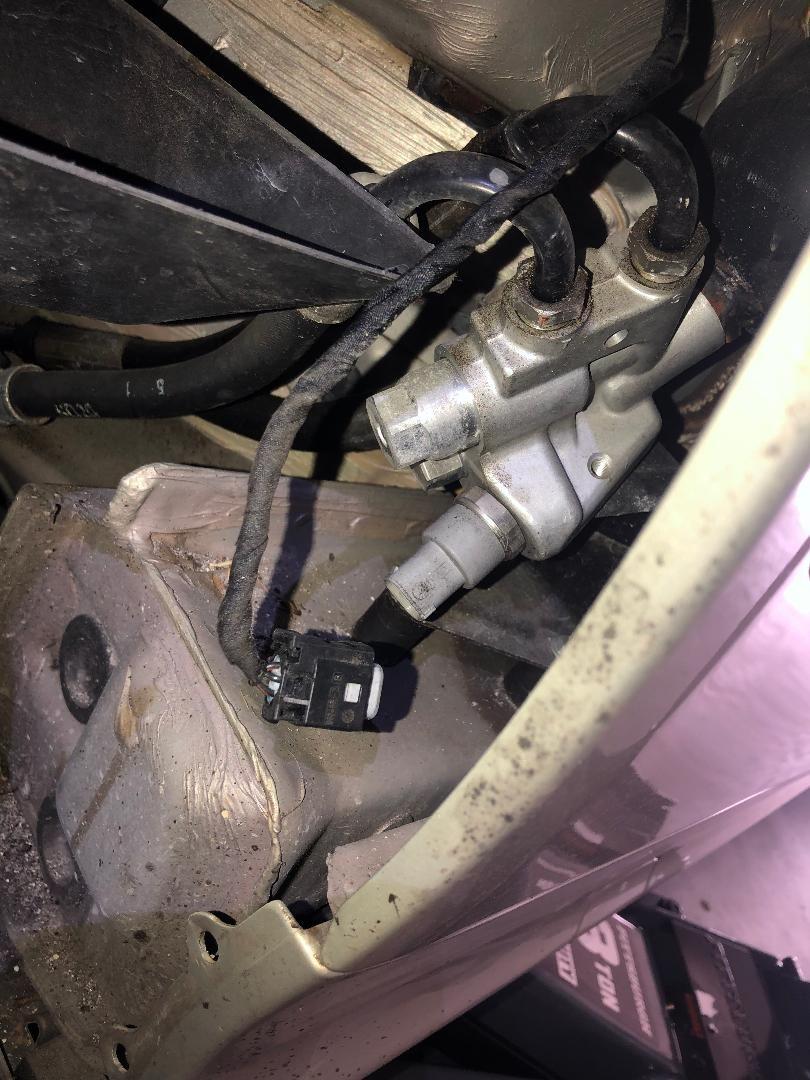

I am leaning towards a bad ABC pressure sensor =PS because sometimes 190 bar other times on start up 0 bar on my iCarsoft MB V3.0. Been that way for the last month.
what kind of voltages could I test for coming off the leads going into and out over the PS. looks like a brown/black wire red/black wire white/black wire ?
