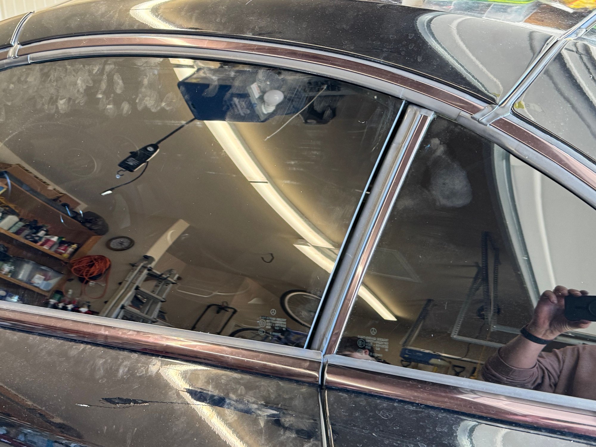

Hi everyone…
I finally tackled replacing the window regulator on my r230. It was pretty straightforward thanks to @marko69 video. The window works but when I close the door, it doesn’t do that little slide up to seal with the other door. Is there some sort of calibration that you must do to get the window to seal with the smaller one?

'01 CLK 430 cab, '04 SL500 (230K miles)
Do you have the big silver end cap on the end of the door? That piece pushes in the plunger to tell the car the door is closed. Hard to tell, but it looks like the back window is in the short open position.

Old Feb 1, 2025 | 09:41 PM
renncoder's Avatar
Joined: Jan 2003
Posts: 182
Likes: 18
From: Cedar Park, Texas
2013 Porsche 911 Carrera 4S, 2004 SL55, 2012 Lexus IS250, 2021 Toyota Highlander
No. I kept it off to test it out. That explains why the car kept chiming like the door was open. I've got to fix a fitment issue at the front of the door, but once I get that worked out and install the end piece. Thanks for the guidance on that.

Old Feb 2, 2025 | 06:47 PM
renncoder's Avatar
Joined: Jan 2003
Posts: 182
Likes: 18
Still need to fix my alignment issue on the window but I added the trim plate and sure enough, it worked as it should. Thanks for all of the help.
