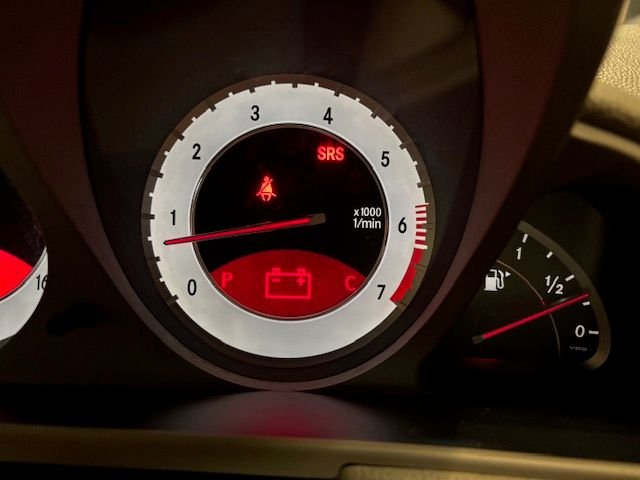

Originally Posted by RCBr230
Maybe someone can give me some direction. Since I have been working on this car for the last 3 months the red battery warning lamp has been on. I am not sure if it was on when I got the car about a year ago because the car was inoperative.
I replaced the rear/auxiliary/consumer battery about 3 days ago but the warning lamp problem was before that. Just fyi, that battery would not hold a charge. BTW, I have NEVER jump started the car. Just used a quality charger.
I have tested both batteries this morning below are the results.
With car off (and after it set over nightz0:
Front/Starter battery: 12.65 V
Rear/Auxiliary battery: 12.71 V
With car running:
Front/Starter battery: 14.00 V
Rear/Auxiliary: 13.85
The iCarsoft says charging is at 13.79 V but it does not allow to check at each battery so I assume that this the alternator charging voltage.
Any suggestions on where to start looking?
This is with car running.
FYI, the SRS problem will be addressed in a different thread.
Thanks.
