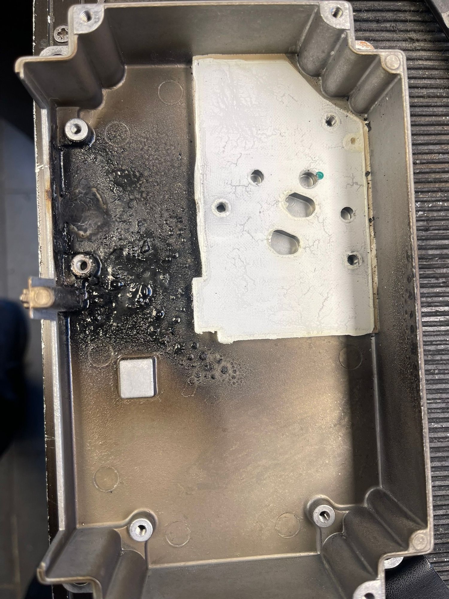

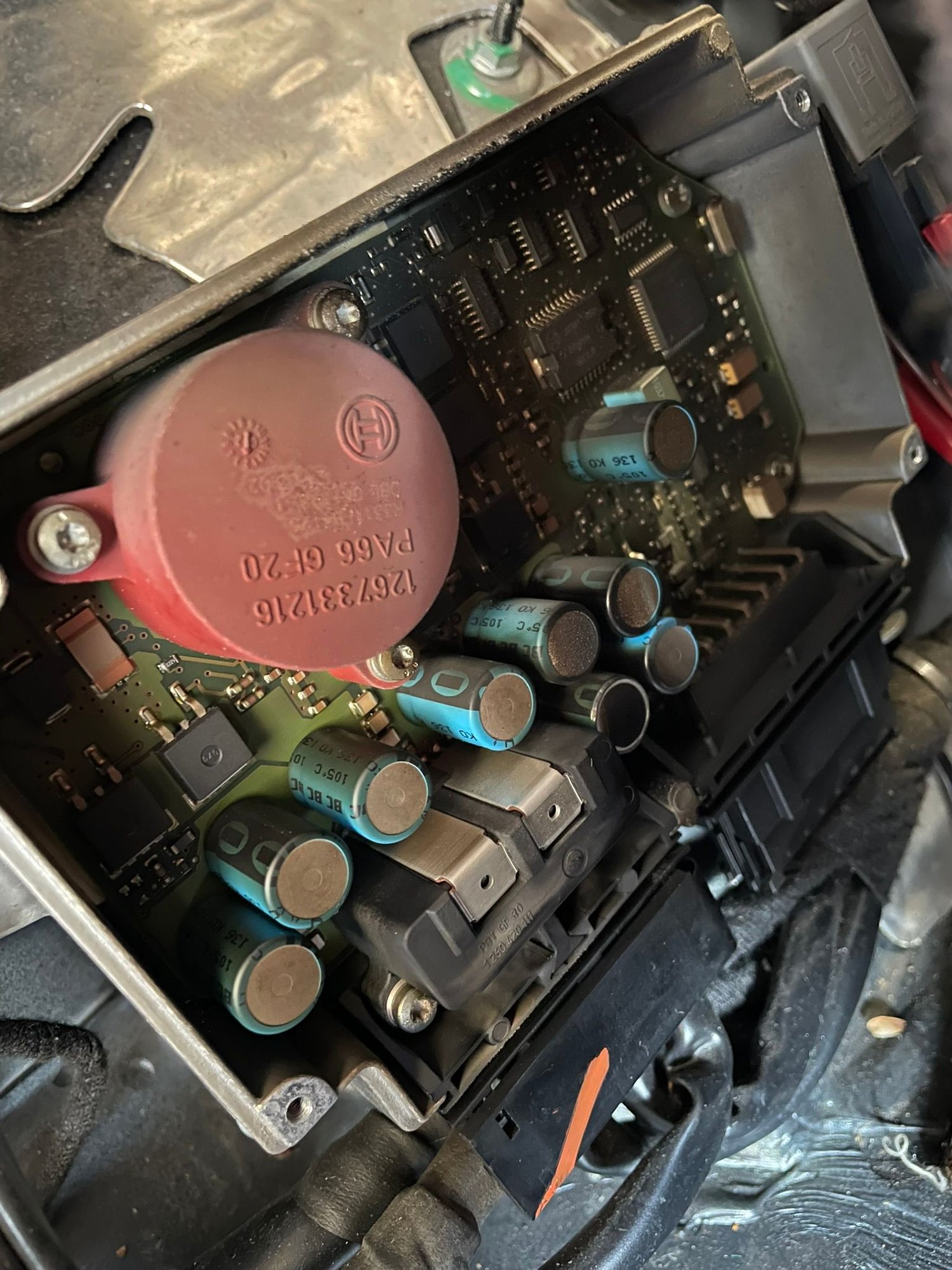

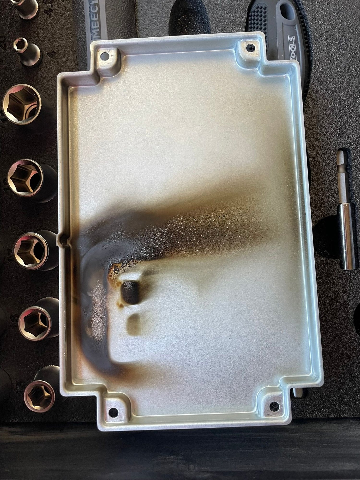

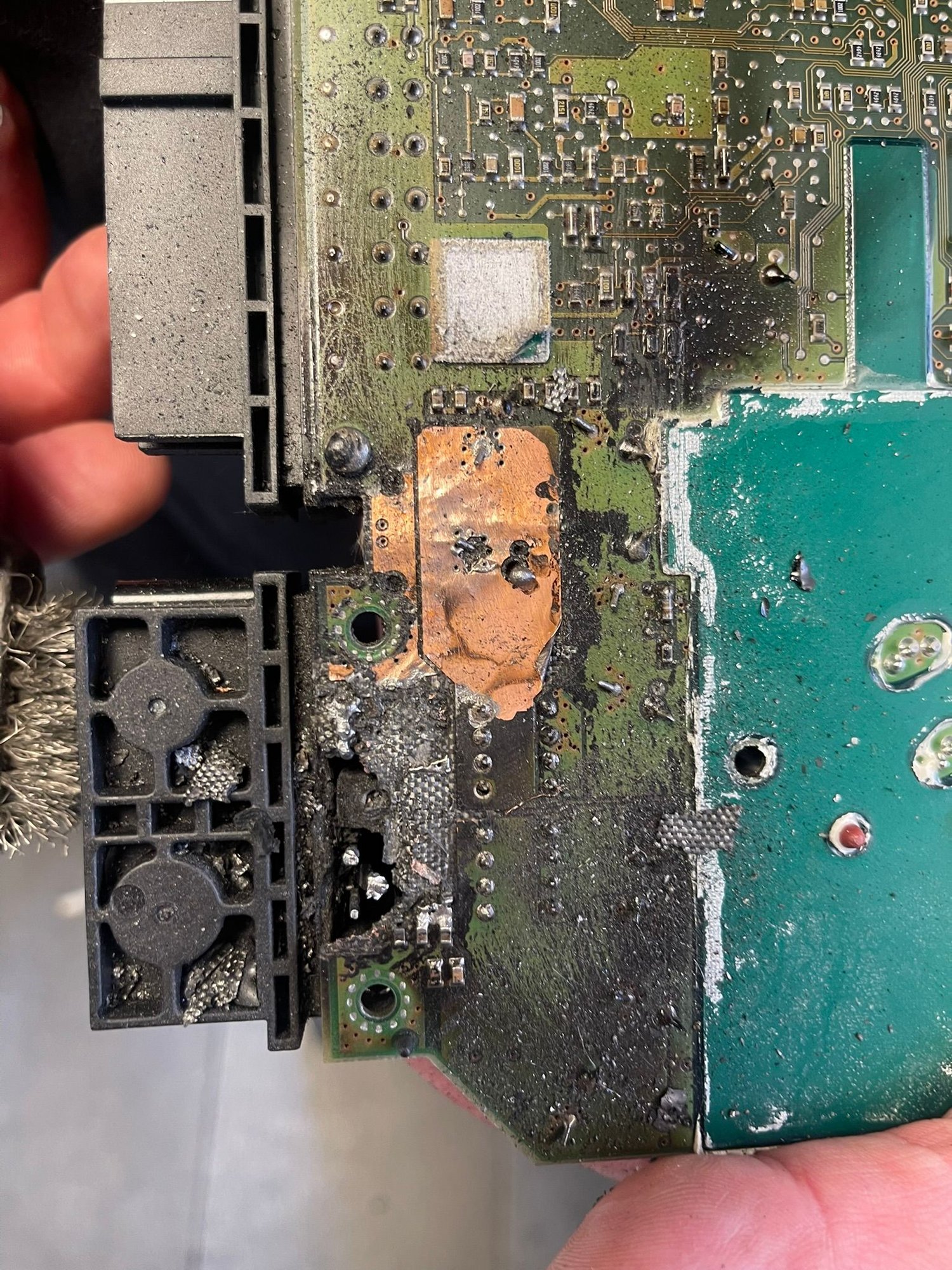

Hi Bob.It might that you have the same problem as I have with my SL 55 AMG 2002 mod.
The BCM nearly caught fire, and there was a big short circuit in the BCM.
I’m now looking for a new, or rebuild, CAN ANYONE GIVE ME SOM INFO ON WHO, WHERE?
PS, You should disconnect both batteries, find the BCM, and open it, It might look like mine.
I have attached some pictures showing what my BCM look like.
