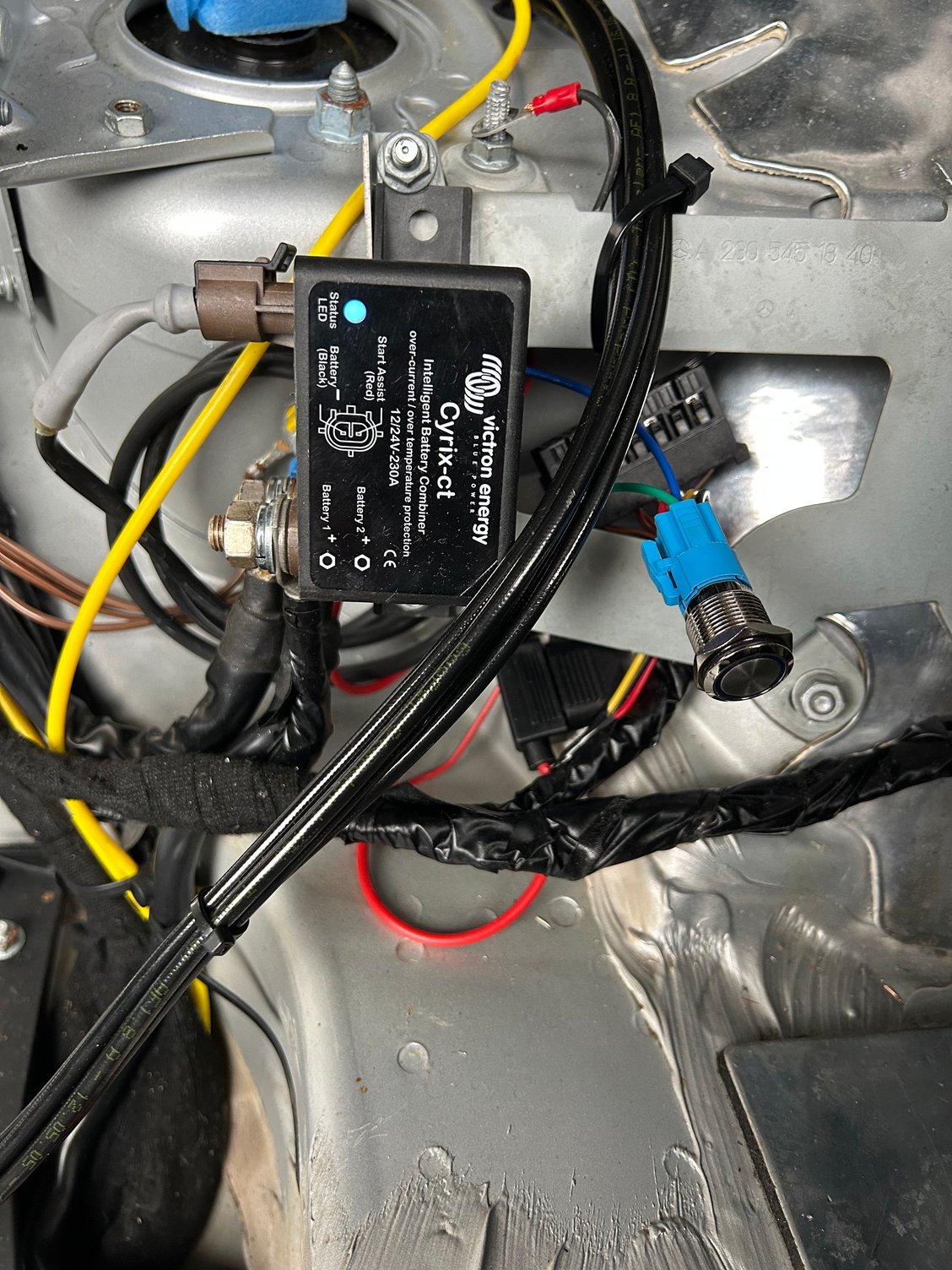

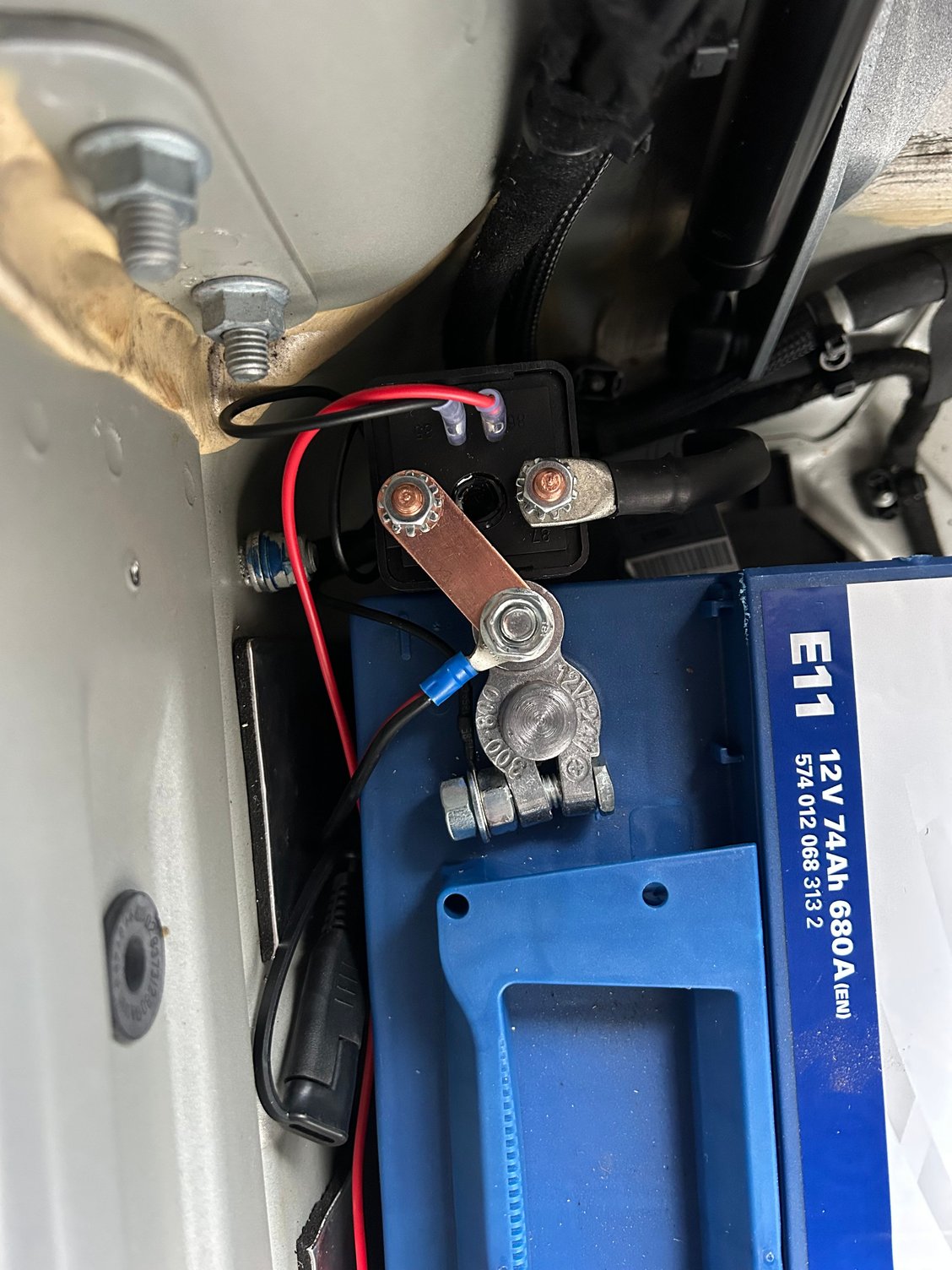

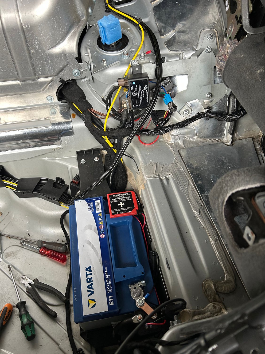

Hi All just finished my Alternative BCM fixing, i know you can buy other units but i thought i would try and help out especially now money is getting tight,
Firstly replaced the Convenience battery, then fitted a Victron energy Cyrix-ct intelligent battery combiner 12/24v-230 amp,
Secondly fitted a CAN BUS Emulator (for the dreaded Battery light on the dash)
Thirdly fitted a remote intelligent Battery disconnector 200amp continuous 800amp instantaneous,
now everything is working as it should for around £200,
pictures attached, before some of you guy's say this is wrong, its working and keeping the cars on the road for people to enjoy as some of these replacement BCM's are quite expensive,
It doesn't look the best but it all fits nicely behind the panels with no modifications,
I Hope this help's

The CAN Bus Emulator i brought from EBAY ( its posted from America)
look up Mercedes R230 battery light Emulator on ebay and it should come up, as for the wiring diagram all you have is a little black box with a pair of canbus cables going on to the can bus rail which is bottom left hand of the SAM behind the rear seat uk driver side, its a bit fiddly and the you just have a positive wire connection and a negative wire connection that is it, the diagram how to fit comes with the unit about £140 delivered, and ive tried everything on my car to make sure all things work ie roof
windows work as they should and charging at 14.32volts so happy days at the moment and also no risk of the unit catching fire, if you need anymore info please don't hesitate to contact me, good luck.

Thanks for posting your solution. Frankly I like it better than replacing the BCM with an aftermarket DC-to-DC converter. Just running the two batteries in parallel with some isolation makes sense.
Its that or simply eliminating the front battery.
