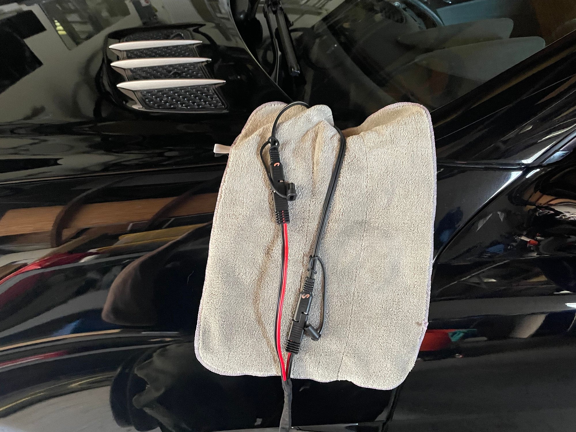

I forgot to connect the consumer battery the last time I got in the car. Just to see what happens, I tried to operate several things in the car before starting the car. The cluster, seats, and infotainment system worked. The steering wheel and convertible top did not work. The alternator is not providing power because the car is not running. That can only mean that the starter battery was providing power and the BCM was selecting what it would and would not power. Hence, the belief that the starter battery is only for starting the car is false. It also powers consumer functions when the consumer battery is not providing adequate power. It is my understanding that it also works the other way - the consumer battery starts (or helps to start) the car if the starter battery is not providing adequate power. Hence, the BCM is doing more than what you may think it is doing. I would not want to use a modified BCM that acts only as a DC/DC converter.
I am now keeping both batteries fully charged at all times. For convenience, I ran DC extension cables to the cowl. May seem counterintuitive, but if the voltage loss over the longer cables is excessive, you have to use a lower power charger. My 1A charger is working fine whereas my 20A charger failed. Because 20X more current means 20X more IR drop (voltage loss). Good example of less is more.
