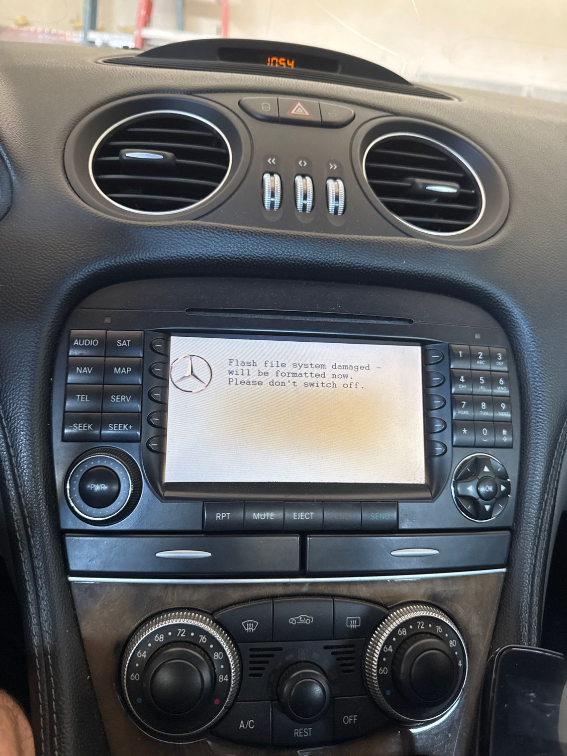

how do I instill apple carplay in my 2006 sl 55 amg it uses the most system and I want to still keep my cup holders this is a photo of it and it also uses the cd player behind the driver seat if you guys can leave me a link to the items that would be great

See my thread: https://mbworld.org/forums/sl55-amg-...004-sl600.html
Post #19 lists all the parts.
Of course, you already know that the 2006 uses the "MOST" converter instead of the "D2B" converter needed for 2003/2004.
