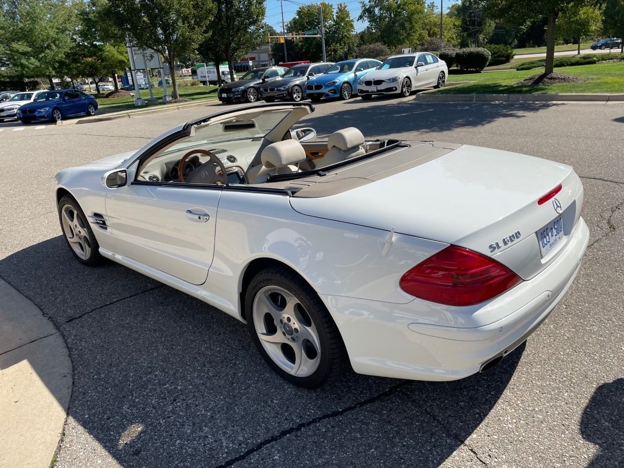

Advice for Apple CarPlay on my "new" 2004 SL600
UPDATE on Oct 30, 2021 - I was successful and very satisfied - see my post #19.
I just purchased a 2004 SL600 V12. Normally I would be hesitant of such a car, but it has only 22,000 miles and its looks brand new inside and out.
I recently installed an aftermarket CarPlay into my 2013 BMW M3 and would now like to install Apple CarPlay into my SL600. I read some of the posts here on the topic, but they were all years old and had no definitive recommendations and certainly no instructions. In contrast, for my 2013 BMW there is an almost-universal recommendation, step-by-step instructions and detailed trouble shooting on the M3 forum. (And every year there is a better/newer unit.) I want to replace the existing Radio/Nav unit.
Sorry if I just didn't search hard enough but I cannot find such a thread here. If there is one, please give me a link to it. Or give me a recommended unit; my only use is connecting to my iPhone and showing Waze or Google maps and playing Pandora; I don't care about radio, steering wheel controls, CD play, etc. I see multiple references to "Seicane"; is this still the best choice?
Also, on a different note, I'm planning to buy a tune from OE Tuning, which seems to be a popular choice here and half the price of RennTech.
Thank you for reading my first post here.
