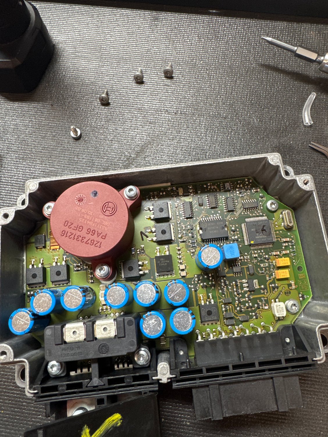

@mrvedit ... The 'U' cut. Nice. That makes things much easier.

I don't see any obvious bulging capacitors. Are you just putting it back with fuses or are you considering having the capacitors replaced anyway?
At this point, I might as well replace them anyway. I see a few repair services online. Anybody have recommendations?
