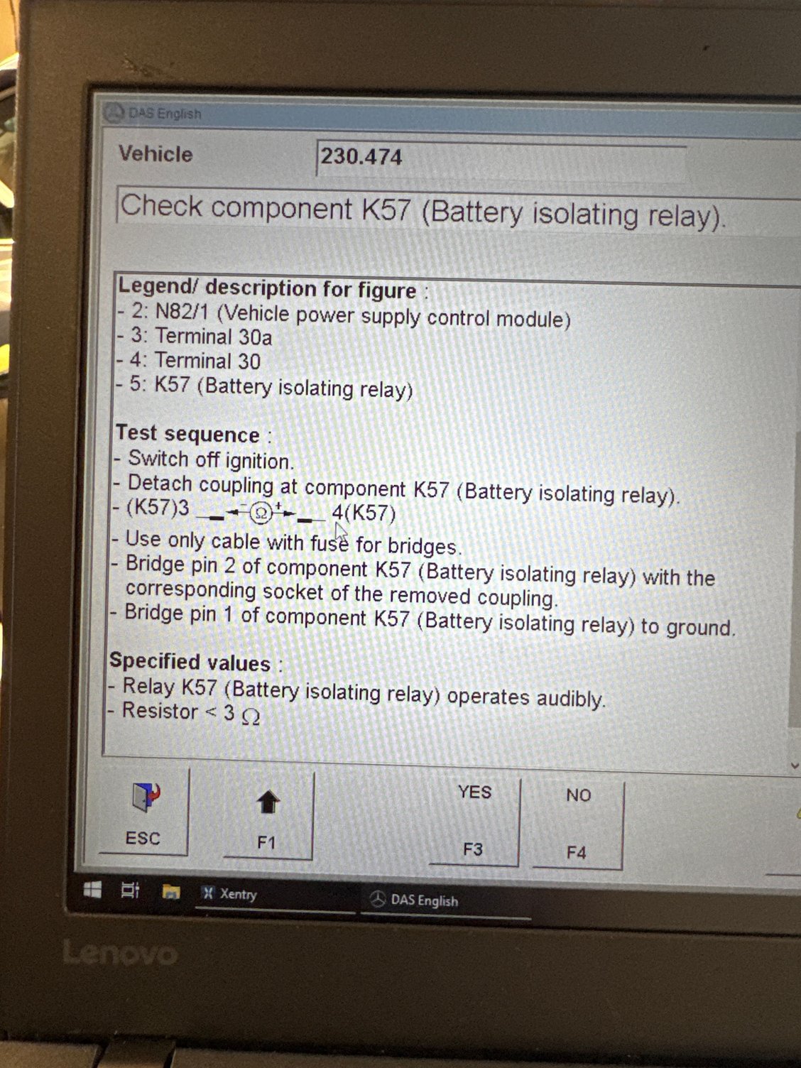

The K57 relay is not used for charging. It is only used in an "emergency" when the rear battery is too weak to power the engine for a cold start. The front battery then temporarily powers the entire car to get it started.
I would not worry about the K57 code until you are sure both batteries are working correctly.

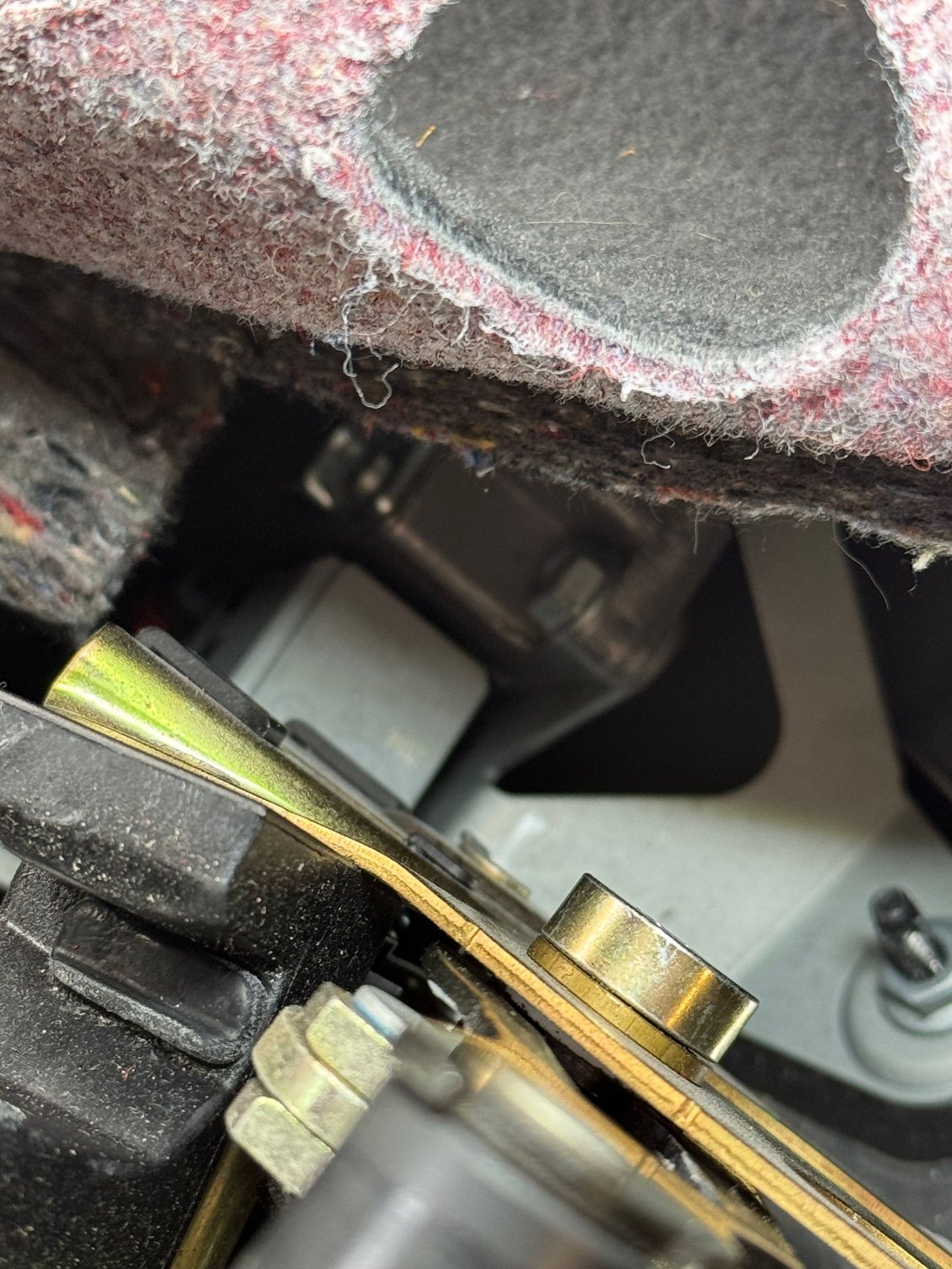

The K57 relay is next to the BCM in the right rear under the trunk carpeting.

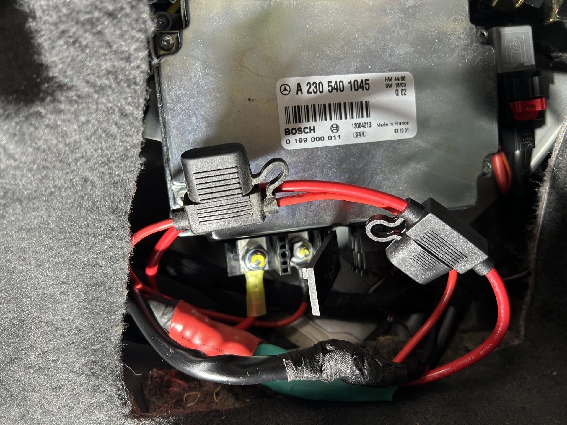

As many have mentioned here, it is STRONGLY recommended to fuse the BCM as documented here and on various YouTube videos. This is to prevent a major fire if/when the BCM fails and shorts the batteries to each other and/or ground. This requires access to the BCM. Some videos show removing the entire trunk carpeting (what a pain), or trying to pull up just one side (good luck). My solution was just to cut a "U" flap over the BCM area. This way I can access the BCM, its fuses, connections and the K57 relay within seconds of opening the trunk.

Unless you have a flap cut into the trunk carpeting over the BCM area, replacing the K57 relay is a frustrating many hour job.
Do you have fuses on your BCM? If not, one of the active members here made this detailed YouTube on how to fuse the BCM:

The code is still showing up. It shows a test sequence that I don’t quite understand how to implement.

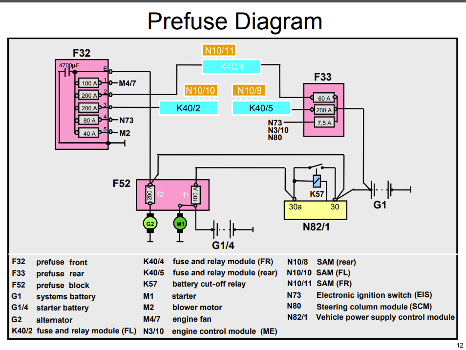

If you haven't already, you will want to read and study (!) the MB "R230 Dual Battery Electrical System" document.
It is available here on this forum:
https://mbworld.org/forums/attachmen...370d1591305151
I just read through that document again and still don't understand how your B1828 code could be determined. The K57 relay is never energized except during an "Emergency" when the rear battery is too weak (under 10.8 V). Perhaps the BCM runs just a small current through the relay, not enough to energize it, but enough to determine if it is there.

Here's my thinking on this. If the voltage regulator isn't providing enough power, would this put the car into emergency mode (albeit temporally?). As a result causing the K57 to kick in? The other thing that is pointing me towards a voltage regulator issue is that the voltage fluctuates. They are good batteries, one of them I just bought last month because it went bad. I'd had that one for since 2019 (or at least that's what the sticker said)

No, that is not how the MB document describes it. When the key is turned, it signals the BCM to wake up. It then reads the voltage of the rear battery and if below 10.8 V, it goes into Emergency mode and closes relay K57 for about 5 minutes. Note that the decision is made before the engine starts and therefore before the alternator is active. Now, might K57 stay on if the alternator is weak? Don't know. But you said you have 14V on the rear battery with the engine running which indicates a good alternator.

Mrvedit, do you have a picture of your trunk carpet where you made the cutaway to access the BCM? I'm thinking of getting fuses installed and would like to go this route to provide easy access. Don't want to cut in the wrong place

Here you go. Here is a pic of the carpeting "U" flap I cut for easy to the BCM and the fuses I added.

And here are pics of installing the fuses.
First pic shows how the the big wires that used to go to the left bolt on the BCM are now bolted together with a fuse line and with a large piece of shrink tubing ready to go on.
The second pics shows the final assembly. The big wires to the right bolt are similarly bolted together with a fuse line. (Forgot why I used cloth tape and not shrink tubing).
Notice that the other end of the corresponding fuse lines now go to the BCM. 30A fuses are installed. The max current that is supposed to flow through the BCM is about 20 Amp (15A ?) when charging the front battery through the DC-to-DC converter. Hence 30A fuses are plenty.
Now if the BCM fails internally causing it to short the batteries to ground or each other, the fuse(s) will blow instead of catching the BCM on fire.
For diagnostic work, such as chasing down battery drains or testing the BCM, it is now trivial to measure how current is going through the BCM. (For reference my BCM draws 0 mA when the ignition is off.)

On the subject, here is a very useful diagram from the MB document mentioned above. I know the diagram is listed in other threads, but to correct the Red Battery light, it helps to understand this diagram.
