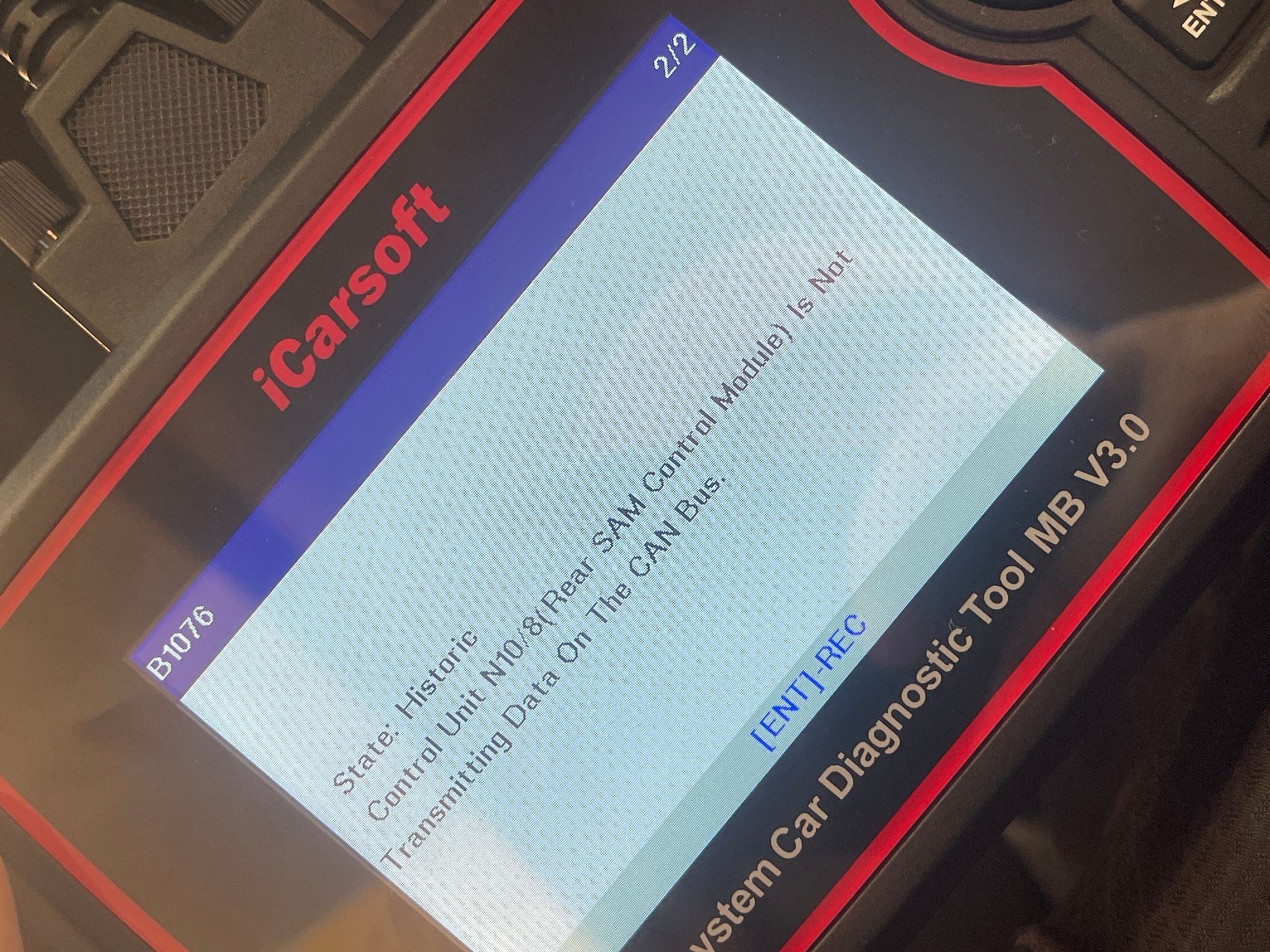

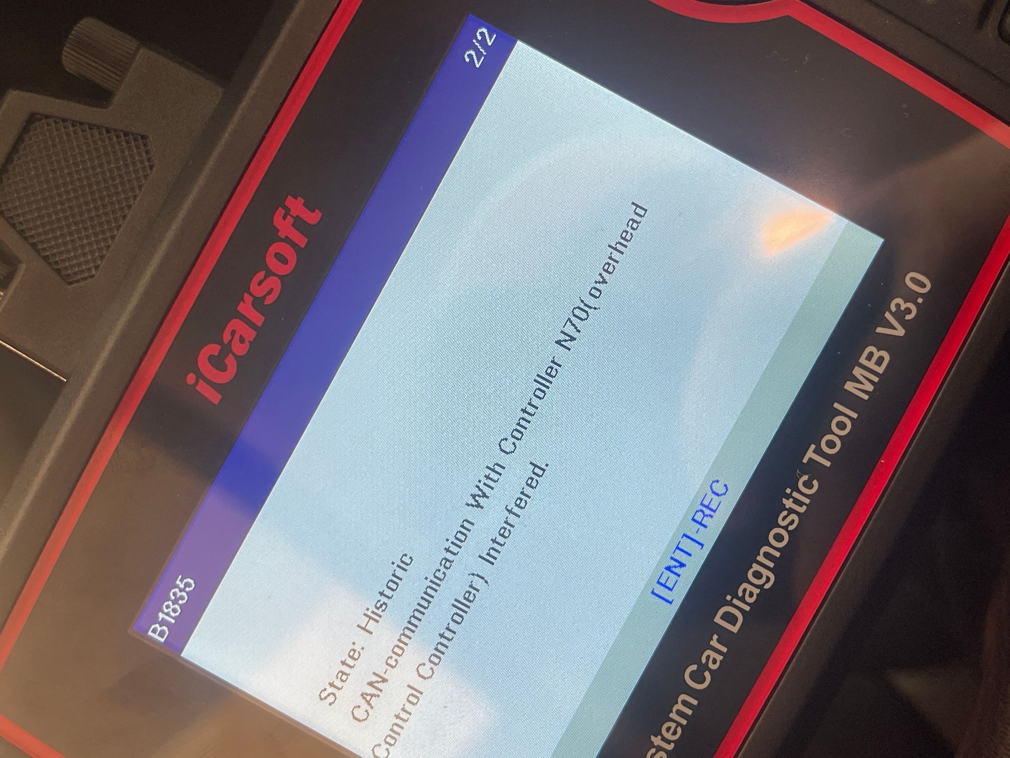

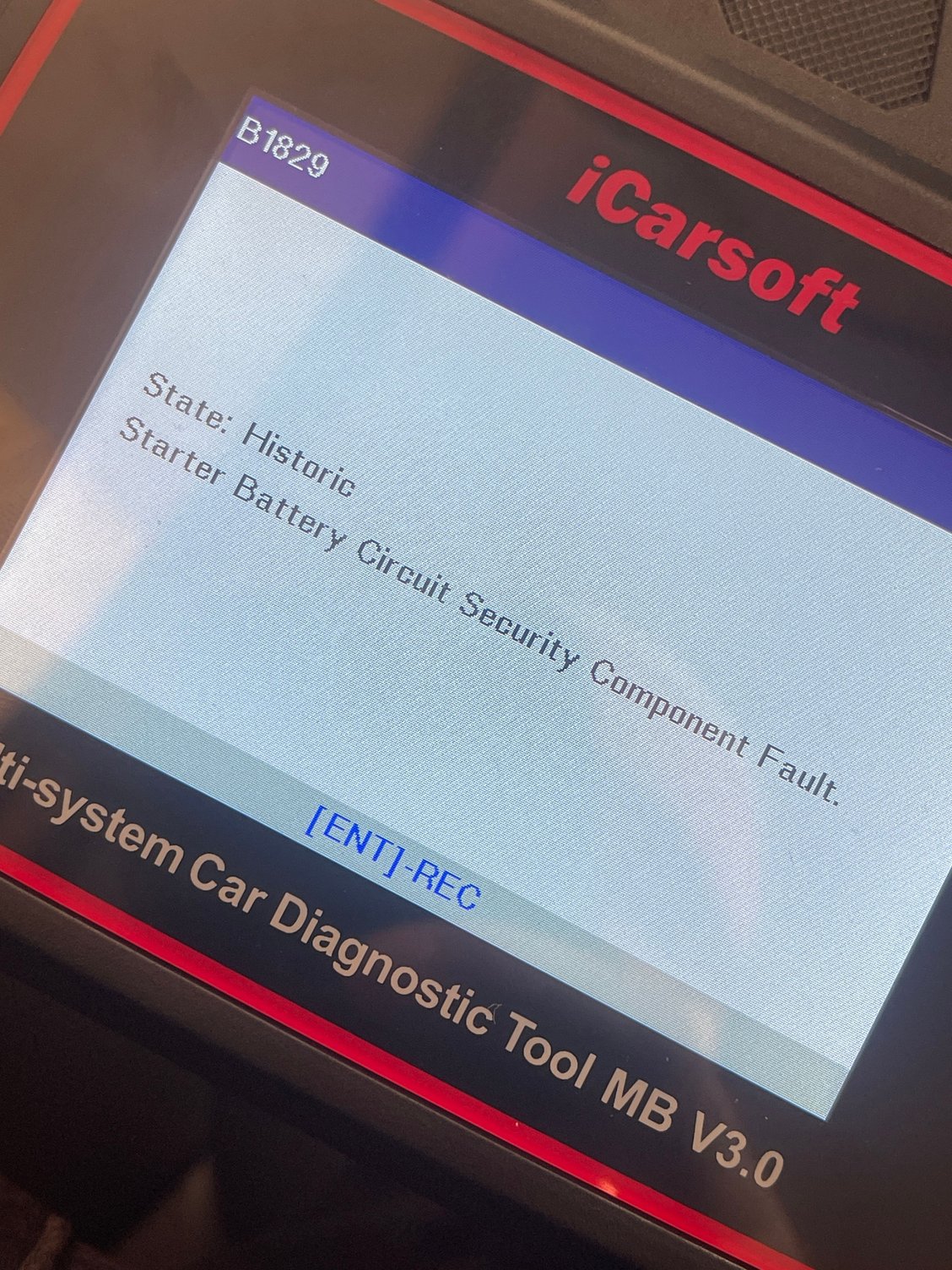

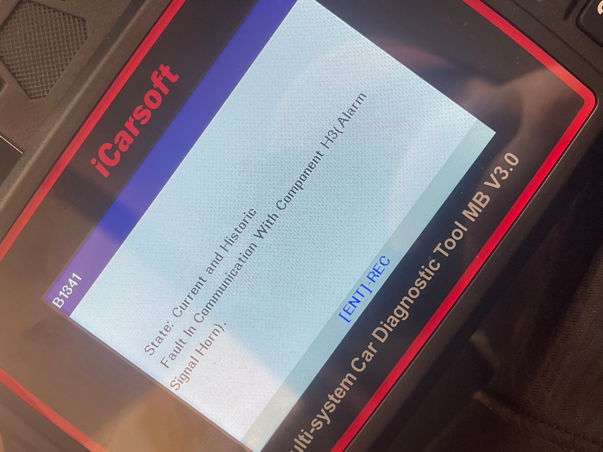

I ran my MB v3, and these codes came up.

Your security component error can be with the EIS. See discussion link below and ECU Pro link.
The H3 Alarm error is probably the corroded NiCad battery in the alarm siren in the driver's side wheel well. It is easy to replace and can cause mysterious problems. However, it does not usually cause no start problems.

Your rear SAM error might be the real problem.
Many here remove the fuse for the alarm siren; likely the old NiCad batteries in it no longer hold a charge and will drain the consumer battery attempting to recharge the defective NiCads. I don't recall seeing a scanner error for this begin disconnected.
