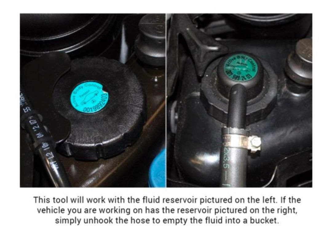

Don't start throwing parts or work at a problem you may not have. Dark ABC oil means it is dirty. A worn or broken ABC part doesn't cause this. Time and miles on the clock does. If it were me, barring any other problems, I'd do an ABC fluid flush and filter change. Pretty easy process. There are probably a half dozen threads on this forum on how to do so. Only thing of note is that you may or may not need a special tool to accomplish the task. Check the attached photos to see which type of ABC reservoir cap you have. That will tell you if you have the higher or lower style ABC return line and whether you need the tool or not. Here is a an ABC troubleshooting guide. Take a look at it before you do any ABC related work on the car. If you have any of the issues you MAY need to replace some parts. Do any parts replacement before the flush and filter change.
https://www.mri-auto-diagnostics.com...ng.Guide_..pdf
The tool is only necesaary if you have the newer (post 2006) cap which is on the left.
The tool is expensive ( ($150-$200)  and only does this one task. However, doing the flush without it (if you have the style reservoir  that needs it) is alot more difficult and a mess.  I would have bought the tool but thankfully mine was the older style reservoir so I didnt need it.

They advise to do the PITCH actuation when flushing. I did the following:
1. Took the car for a 4 or 5 mile run just to get things warmed up suspension wise.
2. Get your STAR connected and ready to go and familiarize yourself with how to get to pitch mode as I dont think it stays completely connected goung from ignition off to started.
2. With the car off direct return line into a 5 gallon pail. I srltarted with a clean white bucket, this way I could see if any particulate was in the old fluid that got flushed out.
3. Get your 10 liters of Pentosin ready to go. Put a large funnel into the top of the ABC reservoir.
4. Have a buddy start the car. Once the car is running you need to pour Pentosin into the funnel as it pumps out.
5. Get into PITCH mode in STAR.
6. Add Pentosin into the funnel. You need to make aure that reservoir doesn't run dry. If you get behind, have your buddy turn off the car until you catch up then start the process again.
7. When you start adding in the last quart you can shut the car off. Be sure to stop the car before you add all your Pentosin in. Save some to top off the reservoir.
8. Remove the old ABC filter from the reservoir. Put the new filter in.
9. Reconnect the return hose to the cap. put the cap back in place.
10. Fill reservoir with additional Pentosin if needed.
11. Pour old fluid from the bucket into the empty Pentosin containers. Dispose accordingly.

Most important thing when doing a flush is to keep Pentosin in the reservoir as it pumps into the bucket. It's not like draining the engine oil. If the ABC pump runs dry it's game over for the pump.
If your cap is like the one on the right in the picture, YOU DON'T NEED THE TOOL. Don't buy that tool if you don't need it. It's not like you can use it anyway. It's designed for the cap on the left. It won't work. You can buy most of the Pentosin and a new ABC filter with the money instead.

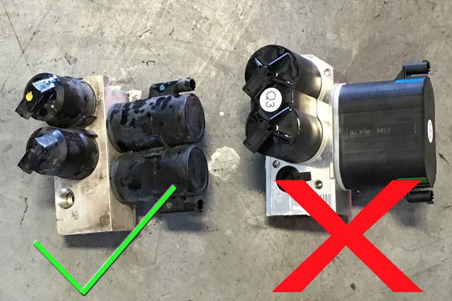

so the rebuilding seems to be impossible on the original SL500 blocks see here:

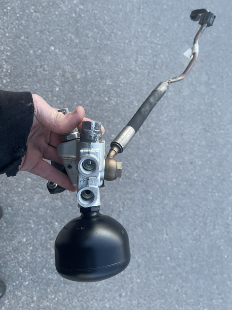

The pulse dampener sits on a smaller block which includes an over-pressure valve. (Or is it simply the pressure control valve?)
IIRC this smaller block with its valve is available on eBay for $100 or so. I recall a thread from a year ago where the OP replace this pressure valve block to solve his problem.

No, I am referring to something called the "ABC Suspension Hydraulic Pressure Relief Valve". It is the smaller valve block into which the pulse dampener screws.
There was at least one report of this pressure relief valve leaking and preventing full ABC pressure. For some (most?) cars it is part number 2203200858 and available on eBay with and without the pulse dampener for $100-$200.
Not trying to throw more parts at you, but personally I would replace that simple part before blaming the pump itself.
that's the "third" valve block ! no?
what do you call it? a pulse dampener?
Old Apr 20, 2026 | 10:57 AM

In this common diagram of the ABC system the pressure relief valve is 52B and an integral part of 52, which is part number 2203200858.
If the spring gets weak or the valve leaks you will not achieve 180 Bar. I don't know if the ABC pump regulates pressure, like a power steering pump does, or if 52B actually regulates the pressure. (If you know for sure, please let us know.)
