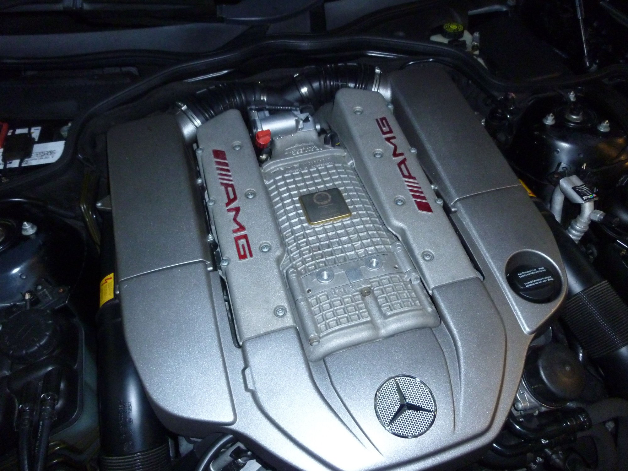

Best way to buy those NGK plugs is directly from NGK on their own website, there those plugs cost $13.72 each. This way you know they are genuine NGK the ones the owners manual that came with the car, specifies (ILFR6A) # 3588. They also sell a wire set. If your car is a 2003 SL55 AMG with the M113K Kompressor engine thast does have 16 spark plug wires those are about ten inches long thaer would be one for each spark plug. Engine should take 16 spark plugs.
2003 SL55 AMG with M113K Motor!!!
An AMG motor should have one of these name badges on top
Very slight variations in length so when replacing wires match them up to the old ones and keep them all separate doing each one at a time so you don't wind up with the last ones being too long or short. My total parts cost was about $400 for plugs and wires, the wires I opted for were Bremi brand made in Germany. Other wirers cost a little more. Benz dealers charge a lot for the spark plugs, then rob a guy on labor, it's insane, apparently they're geared to doctors who know absolutely nothing about cars. I admit that the rear-most plugs are hard to reach, and when I did this job it took me nine hours, but only because my left shoulder was NOT working at the time. I did the job anyway, kinda dumb, but dedicated. Might have been a six hour job otherwise, because I work slow and try to make sure every step is done perfectly... so I don't have any screwups. I should have asked ther Benz dealer how many hours labor they are trying to bill for!! I have bought headlight bulbs for my S-Class on Amazon those even come with a Sylvania hologram of authenticity and a website where you can enter the liight bulbs serial number to "authenticate"... the website itself was FAKE!!! It all looked almost real, but tiny chinese writing you could hardly see, made me wonder. I called the real Sylvania, they gave me their real website. The bulbs I had bought were fake!! I retuned those to Amazon, and gave a bad review, the amazon seller was angry to about Level 9. Kept defending himself, I was like You're aFraud. Bought real genuine Sylvania light bulbs and verified with the real Sylvania. Those chinese light bulbs may even have been "okay" and worked, but the real light bulbs cost about $60 so why try to save 20 bucks getting crap, especially when sold by liars and deceivers. Fake bulbs probably wouldn't last as long as real ones either. The M113K has eight ignition coils; Each ignition coil powers two spark plugs, and has wires about 9 inches long going to the plugs. NGK sells these ignition coils at $54 each. They sell a wires set for $327. Partsgeek sells the Bremi wires set for $184. They also have another Bremi set for $158
