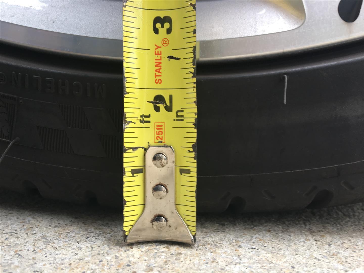

Ride Quality Choices
I also prefer to eliminate the run-flats for a smoother ride.
I picked up a set of 18" CLS factory forged rims with the same offset as the SL to give me a little more sidewall - and what a difference!
I got about 3/4" more sidewall using the same pressures. It doesn't look as aggressive , but the ride and pothole protection is superior!
Seems like the older you get the more ride quality becomes important! I could add 10mm spacers to move the out a little as well..
Hope the photos help....
2013 with the 18" CLS rims
19" AMG Rear with 285/30-19 PS3's
factory 19" Rim
18" rear CLS rim with 285/35-18 PS3's
18" front CLS rim with 255/40-18 PS3's
19" AMG front rim with 255/35-19 PS3's
rear with the 18"CLS rims

correction to previous post
I have been using the Pilot Sport AS3's and the AS3plus for the last few years with only one problem. I ordered a staggered 18" set from tire rack that had a blister in the sidewall after mounting.
Tire-Rack did a replacement at no charge. The 45K warranty period is cut in half because of the staggered sizes - per Michelin's rules. By 20K , they are starting to develop some tread noise anyway.
My previous posted photos had the AS3's incorrectly listed as Ps3's (or something like that).
