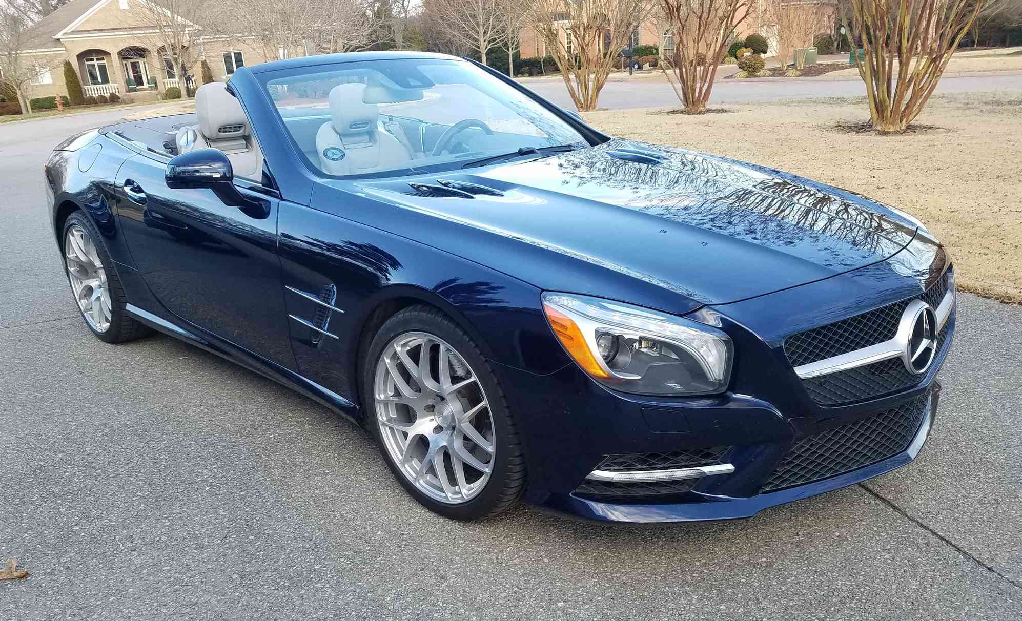

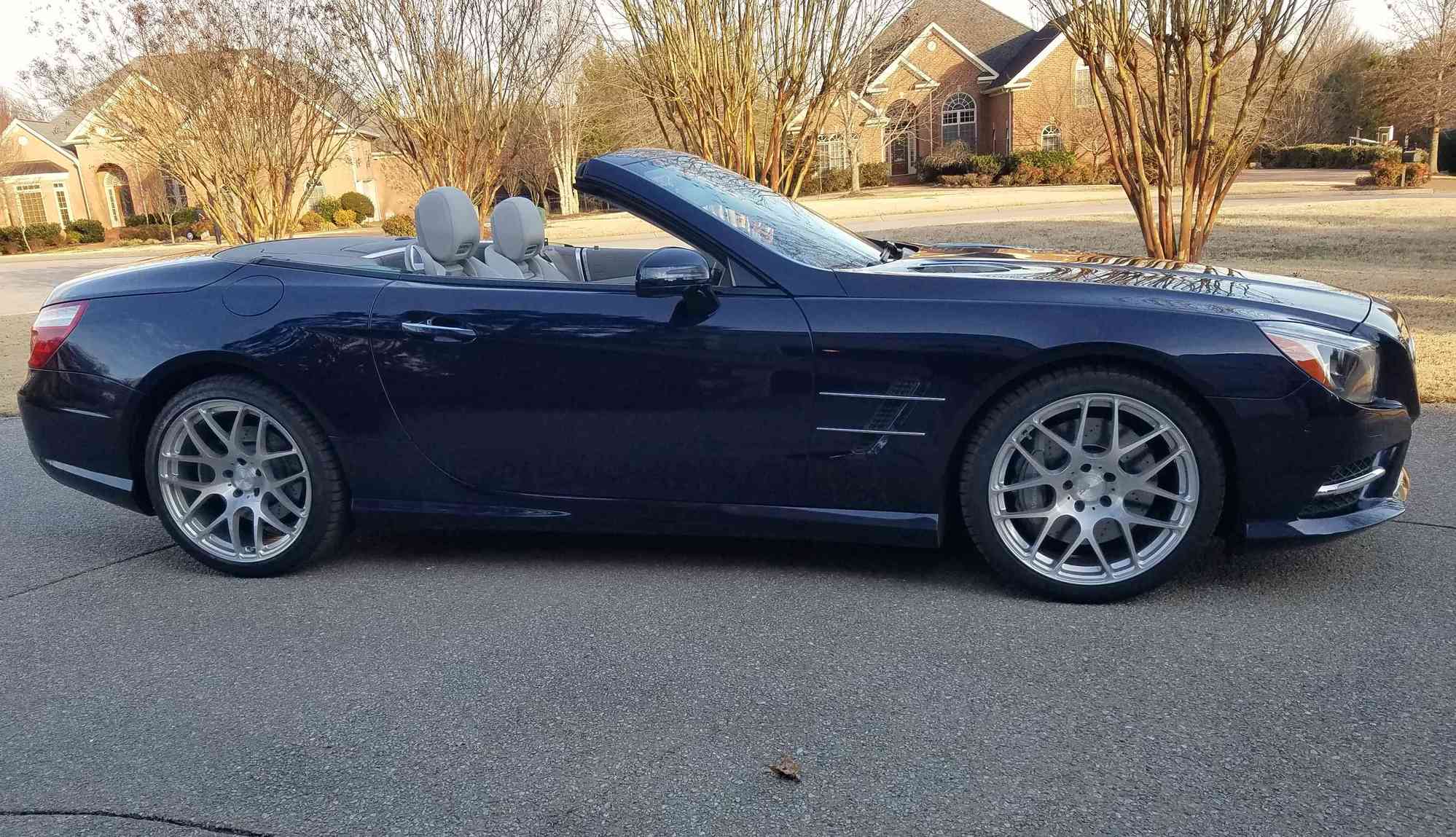

Got my Avant Garde M610's installed today, and I must say I am pleased so far. I realize others may not, but I do like the look and think that the brushed wheel is a compliment to the trim on the car. So now when I crack a rim it just won't cost as much! While I was picking up my car at the dealership, the Service Manager told me he got a call today from a customer who had trashed a wheel so badly, they called for a tow truck. The wheel in question is on a Maybach, cost? $3,500, and it will take two weeks to get in from Germany. Now I don't feel so bad. When I pick up my old wheels Monday, I will post a photo of the cracked wheel Liking the new look!

Those look smashing on that car! WAY better than any of the MB wheels that I've seen so far...and it's tough to depart from factory wheels on this car for some reason. Congratulations. I hope they hold up better for you, but I still suspect that the problem is the 19" diameter stock wheels. I have to go with Streamliner on this, that 18s would probably solve the problem...

The new wheels look great, nearly identical to the BBS style that I really like. The brushed look is good, personally prefer it to the chromed out look.
