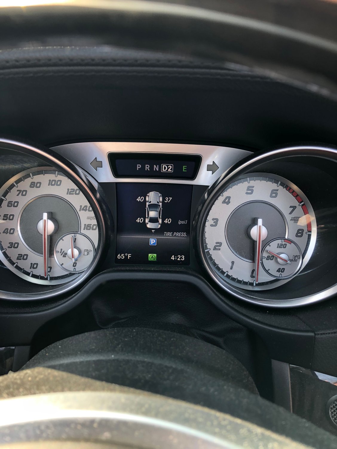

I was out in the country for the weekend and had some Saturday night tire drama - not the rear one with the nail in it but right front. Topped it off with my Slime compressor, then it was low again this morning. Topped it off again and two miles later it was still telling me to adjust air pressure saying LF was 35 and RF 34. My compressor's analog gauge said I had both over 40, but I hate that gauge, as it requires the filler hose to be screwed on like 10-12 turns, then I fear I'm losing air as I screw it off. So I went to a gas station with a coin-op compressor that allows you to set the target pressure digitally and it shuts off when you reach it. Checked it with my trusty OG stick gauge before filling and the fronts were both closer to 35 lbs, so I set for 40 and filled both. TPMS said both were then 42, but, "close enough" I thought. Drove a short distance to a lunch place and RF dropped to 41, so I thought for sure I'd be screwed after lunch, but both fronts said 42 as we left so I figured I was safe to make the 50 mile trip home. Along the way home, LF increased to 45-46 (doing about 75mph in high 70's temperature) but RF stayed at 42-43 (rears had been equal at 40 but LR went up to 44 while RR only hit 43). I had so many tire and TPMS issues with my last car that I get crazy tire anxiety. Looking forward to tomorrow (well, sort of) so my local tire guy can take a look. I wonder if he can even repair a run-flat, if it needs it.....

...and it appears to a moving target, at least as measured by the TPMS. Here's the beginning and end of of about a half hour round trip around town.

Temperature makes a lot of difference (hence always check pressures on cold tyres). Even a very short trip will heat the rubber enough to make a difference.
I had a off road set up ( Land-cruiser 200) with a heavy off-road caravan (with the same wheels as the Landcruiser) for travelling in the Australian outback. I had a fancy 6 wheel TPMS system with temperature display, memory etc. The tyre near the exhaust was always hotter and higher pressure - tyres on the sunny side were always hotter (thus more pressure) etc.
Even while standing in the garage, the pressures on my SL tyres change depending on ambient temperature.
I even found an app for my phone that shows correct pressure dependant on ambient temperature, expected highest and lowest etc......yes obsessive.....
I suggest you inflate & check your tyres when they are cold and then forget about them (~ once a month check, depending on your mileage) unless the TPMS comes up with a low pressure warning. I used to obscess and try and get all my 6 tyres perfect and it is impossible because of all the other environmental variables. I don't think the TPMS in the SL is the most accurate system around and is more useful to give you a general indication......
