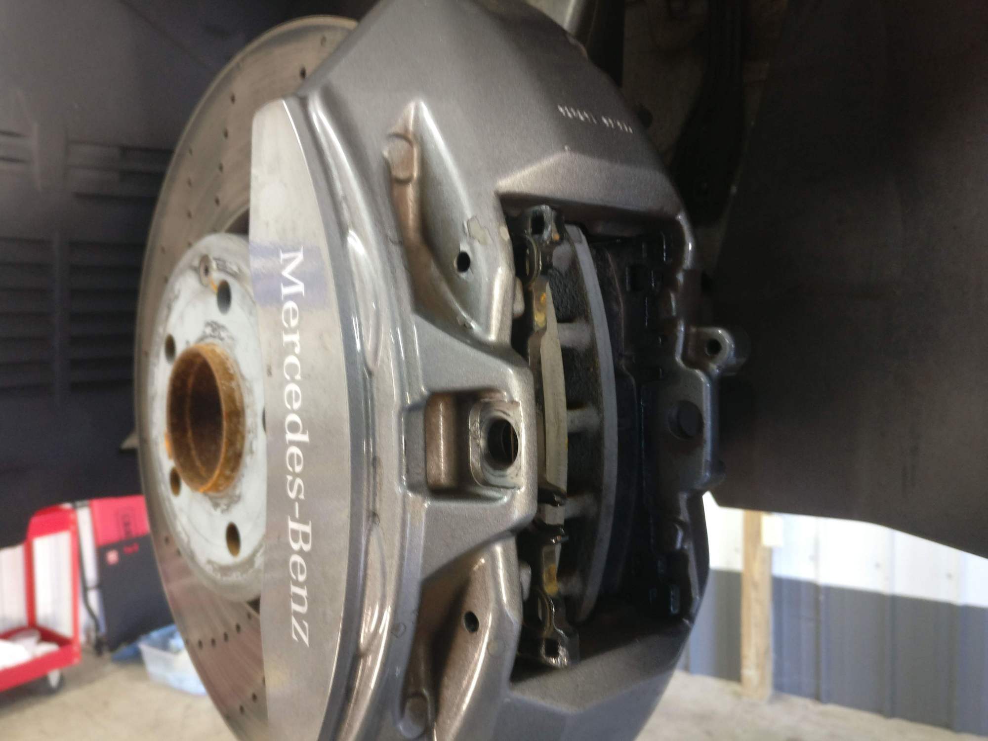

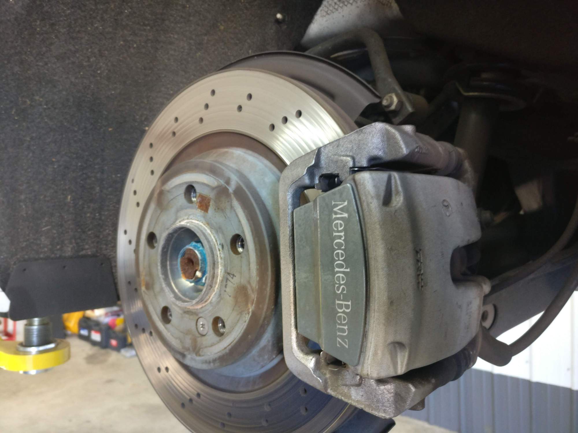

A friend and I installed the Power Stop Carbon Ceramic Brake Pads today on my SL400. The job took about 3 hours but this was the first time either of us had installed pads on a Mercedes. We did view a couple YouTube videos during the job to assist in removal of the old pads.
The new pads did include silicone lubricant. We reused the hardware so no additional parts were needed.
The Power Stop pads fit perfectly. I have only driven about 25 miles but so far, so good. No squealing or noises. I will update this post in terms of the amount of brake dust after I have driven a couple hundred miles.
Brake sensors were located on the right front and right rear wheels. I could have reused the sensors but since I had purchased new ones we did replace the sensors with new ones. I have 2 extra sensors if anyone needs them. $8 each including shipping. The same sensors are used on front and rear.

After a 250 mile road trip I would estimate the amount of brake dust on the wheels is reduced by about 60-75%. Also the dust that is present is lighter in color and thus not as obvious on the wheels. No brake noise at all and braking performance seems to be equal to the OEM pads.
First photo is the rear wheel. A little more dust on the front wheel. Overall, I am satisfied with the results.

I'm looking to do this myself as well. Any hints/tips you can share or any lessons-learned? I've changed brake pads on several of my cars (all american cars) in the past and it seems like it should be pretty straight forward. The only "extra" I've come across is releasing the electronic emergency brake for removing the rear calipers and then re-engaging it when done.

We did not remove the calipers as the rotors were not replaced. The front caliper has a large bolt holding the pads. The nut on the inside end has to be removed and then the bolt is removed with a punch. Figured this out by watching a YouTube video. Everything else is straight forward.
