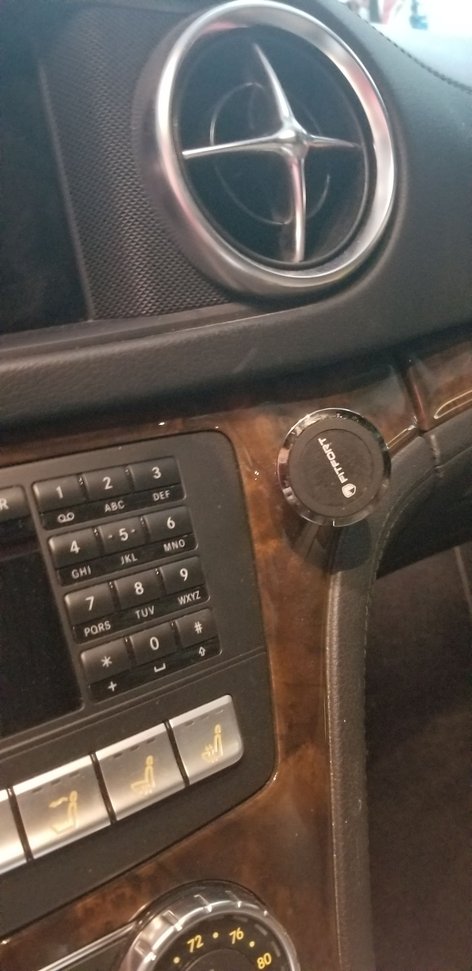

2Intense, I have been using a fitfort magnetic holder and love it. It does mean I have to take my cover off before I can use a wireless charging pad, but I think it’s worth it.

Thanks, I ended up doing basically the same thing.
