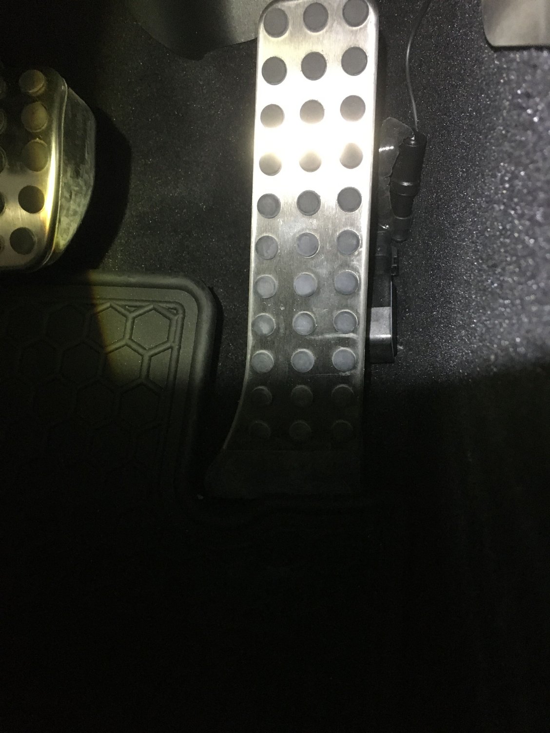

Negative. Do not know where you're getting that info from. Sprint Booster (as well as all other such devices, like pedal box, etc.) is installed inline as I've described. (Just remove the "permanent" as of course one can as easily uninstall).
EDIT: Just watched the above video. Not clear what the issue is, nor if Sprint Booster will address it. From the video it sounds like you've got an initial response, then delay (or backed off the throttle), then got power back. The issue that SB fixes is delay in the original response (which you said you had even before the tune), which is impossible to see/hear in the video since only the driver knows when pedal was pressed and car responded.

Thank you for your feedback(s) and photos. On hard acceleration, the vehicle does go, then suddenly pauses, then picks up again as you should be able to see and hear in the video. I did reach out to OE Tuning who we received the tune from. They concurred is it not the "tune" and also stated that SprintBoost should/might resolve the problem. I was under the understanding that SprintBoost was installed via OBD2. Not the case as you confirmed.

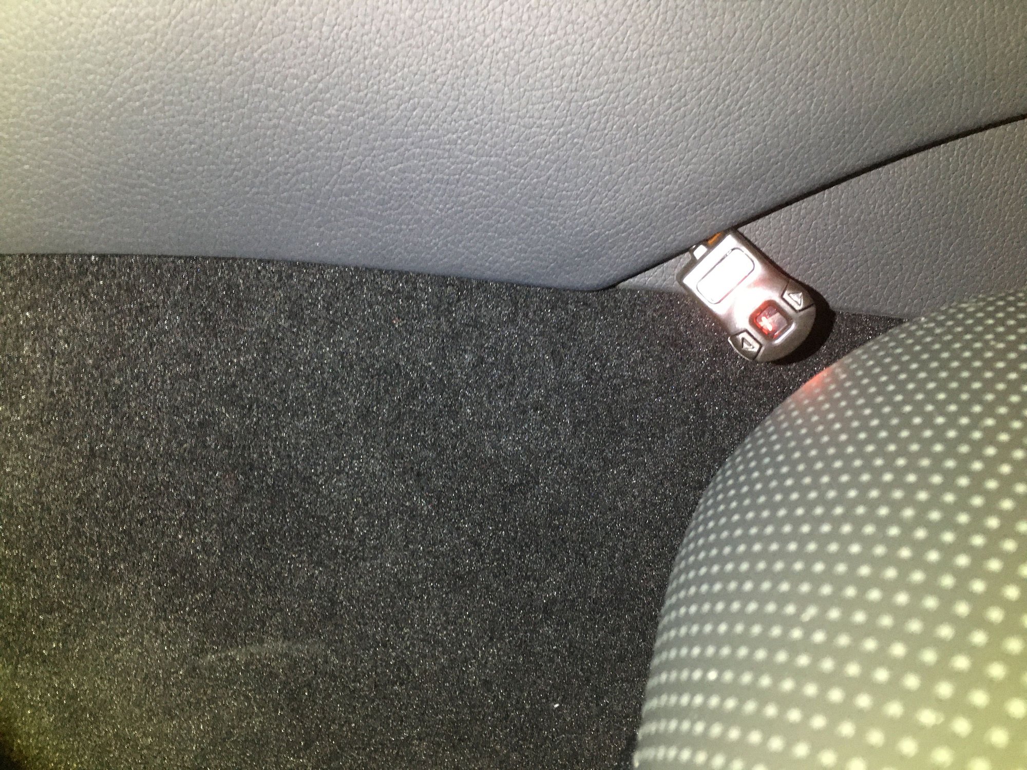

3 MB's: I appreciate your answer and photos. The driver did not deaccelerate on the gas pedal so the pause you see and hear is pedal to the floor at all times.
Can you please tell me what the small "Key Fob" is and its function?

Sprint Booster "fixes" delay in the initial response. Does not seem this is the issue, so do not see how SB will help.
"Key Fob" is a SB controller to switch between stock(no light), sport(green light) and race(red light).
