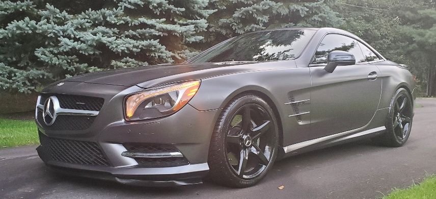

Hey Spin,
I went with the company below. I put on 20 MM on all four. I did also put a larger tire on the rear, from a 285/35/19 to a 295/35/19. Yes they will provide the longer bolts. The center spacer you have to use a special lubricant as instructed. This is a photo of the finished product of my SL. I think between the spacers, the lowering kit and the 295 on the rear, I got what I was looking for. Of course, it's all a matter of personal preference. Many will look at my SL and say WTF did he do? LOL!
https://4wheelspacers.com/videos/
https://4wheelspacers.com/shop/merce...seat-bolt-kit/

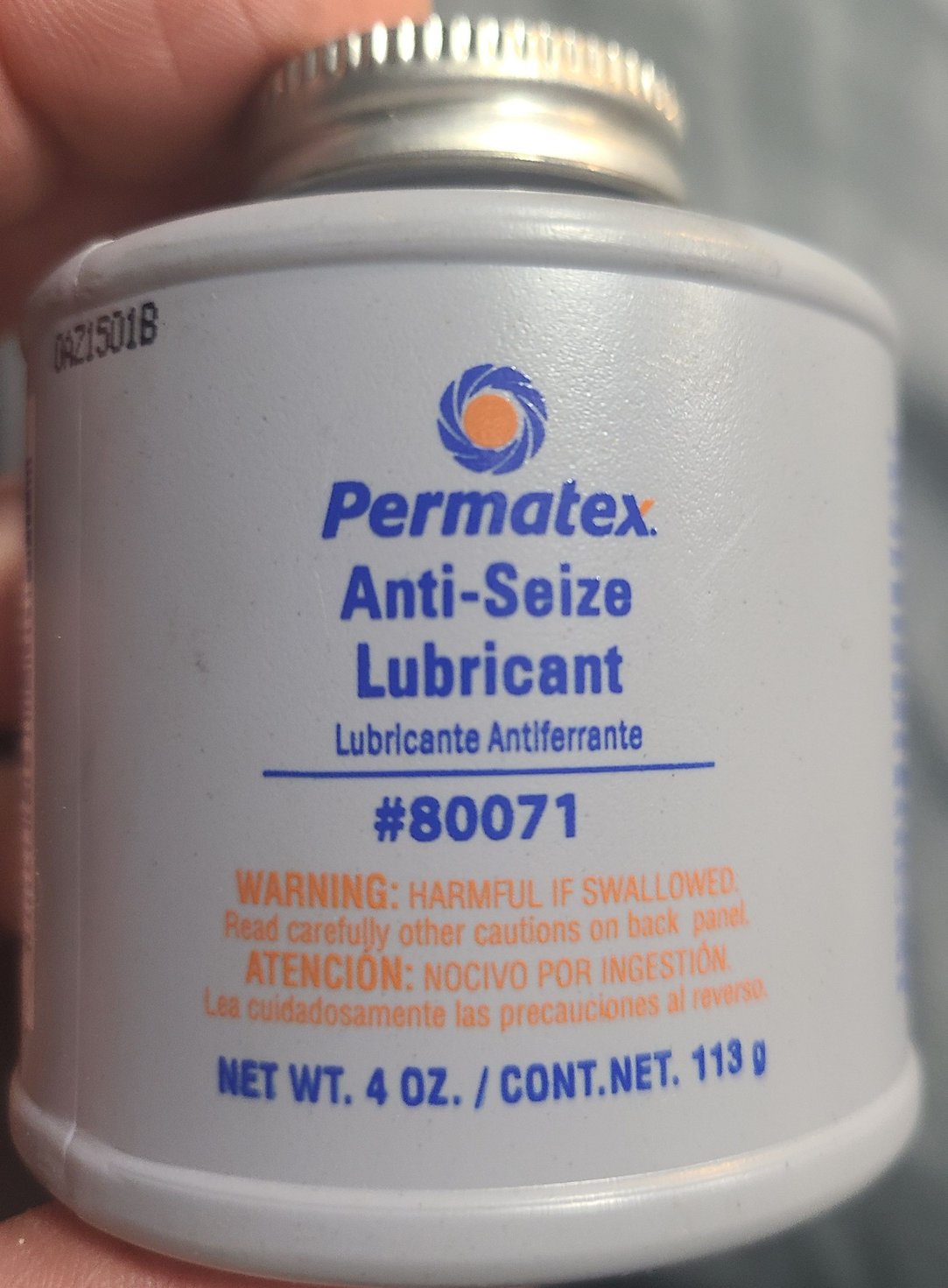

This is the Lubricant I used as well.
