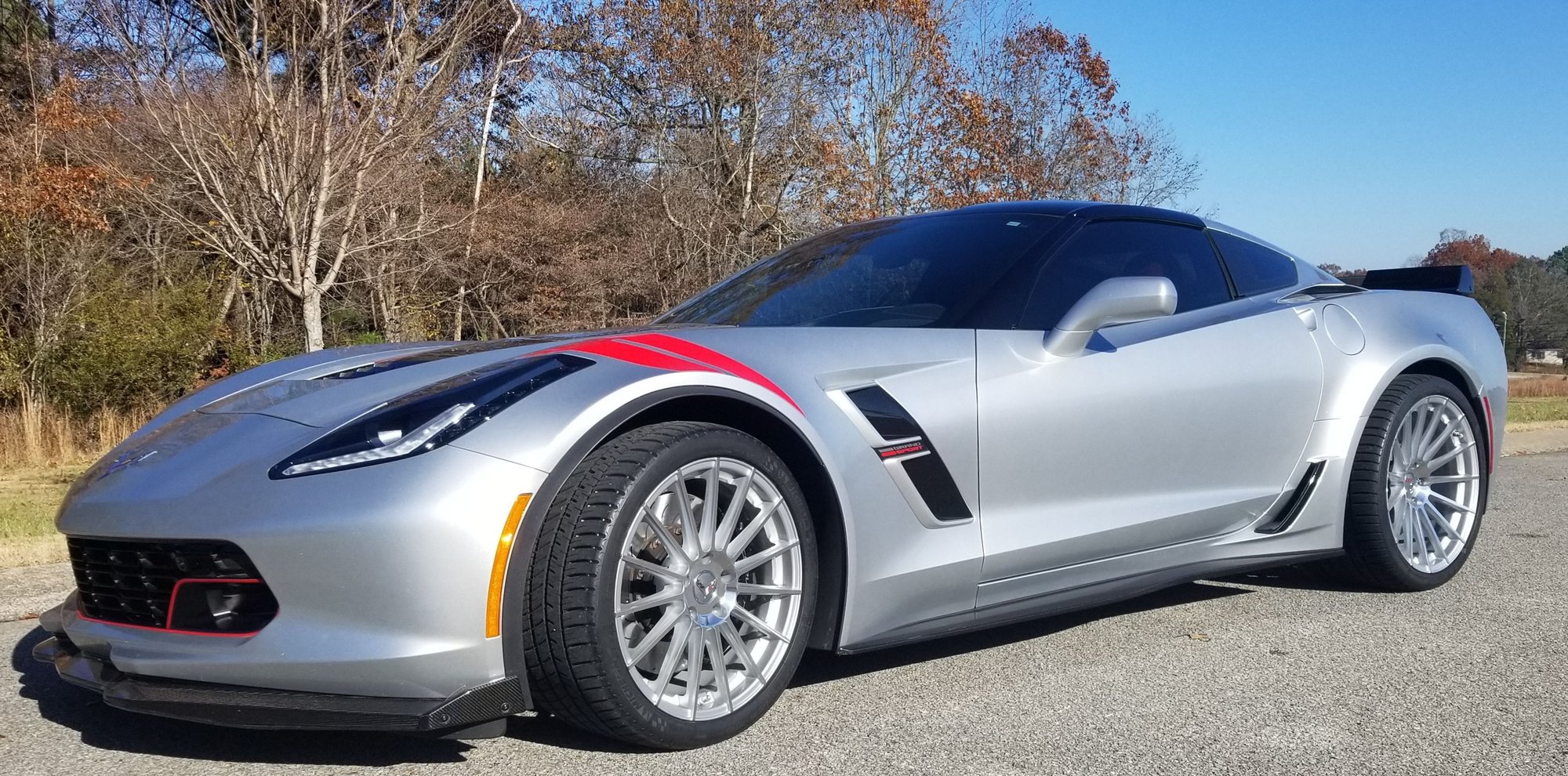

My Corvette is in the garage in that picture. It's a 2017 Grand Sport A8. It has Cray wheels with All Season Michelins too. Stock sizes also with offset also different. Those are the runflats and Cray and Mandrus are both TSW wheel brands.

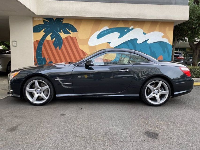

Corvette
When I saw the new high end Corvette at the Chevy dealer with the single offset white stripe on blue a couple of years ago - Z something (it was 98k) - like any red blooded American boy - my first instinct was to whip my credit card out immediately - really.
I ended up with a pre-owned 13 SL 550 with 7800 miles on it purchased a couple of months ago (my third SL) from a Lexus dealer in Hawaii. I realize they are different cars - and the Vette has more power. I think the one I was looking at had 645 HP or something like that.
I would be curious as to your assessment of the difference in handling.
It seems like they have finally got their act together unlike the ones I grew up with. I imagine they now have the ability to corner as opposed to driving in a straight line and that the door panels and dash, do not vibrate off while you are driving. I bet that front end bumber/grill takes more of a bashing than even the SL at about less than 6 inches off the road.

The Corvette is a razor, the SL450 a steak knife. To be expected given their different roles. Both are exceptional in their own way.
The SL450 rides better than any car I've ever been in. Just so sorted out. Good power too, and in Sport modes, very impressive, and great handling too. All day comfort, superb build quality and materials.
The Corvette is my second. I had a previous generation C6 2013 Grand Sport. The 2017 C7 is better in all respects, especially the interior quality and execution, and is a great track car too. Phenomenal handling and braking and more capable than my skills allow. Great power with 460hp. The Z06 you referenced has 650 and is basically the same car as my Grand Sport except for the supercharged engine. A lot of tire noise, a somewhat supple ride in Touring mode (it has the magnetically controlled shocks), and fair interior comfort. A great car with near supercar capabilities built to a price... and a relative bargain IMO. Mine has almost 20k in appearance options like carbon fiber hood, roof, splitter, side skirts, etc. I got a great deal new. About same as the one year old 2019 CPO SL450 with 12k miles.
